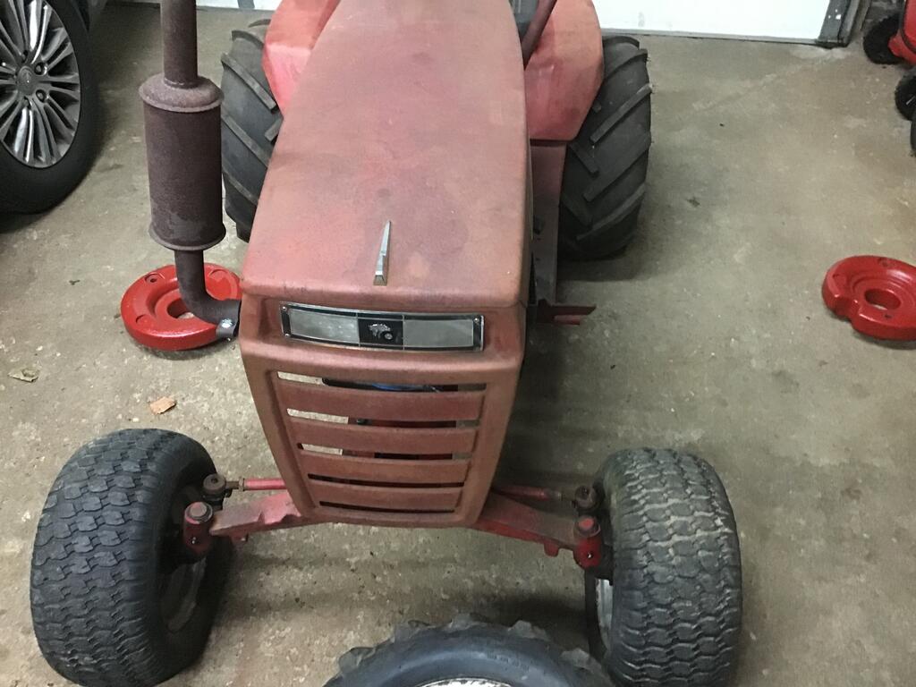

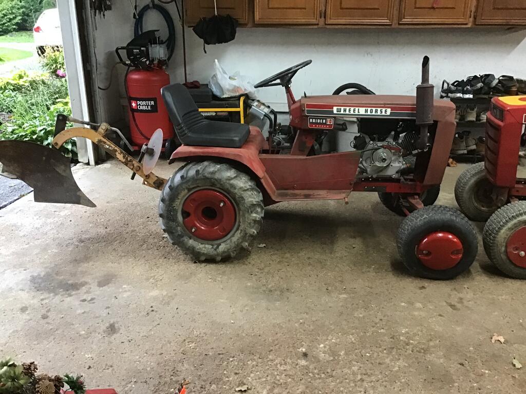

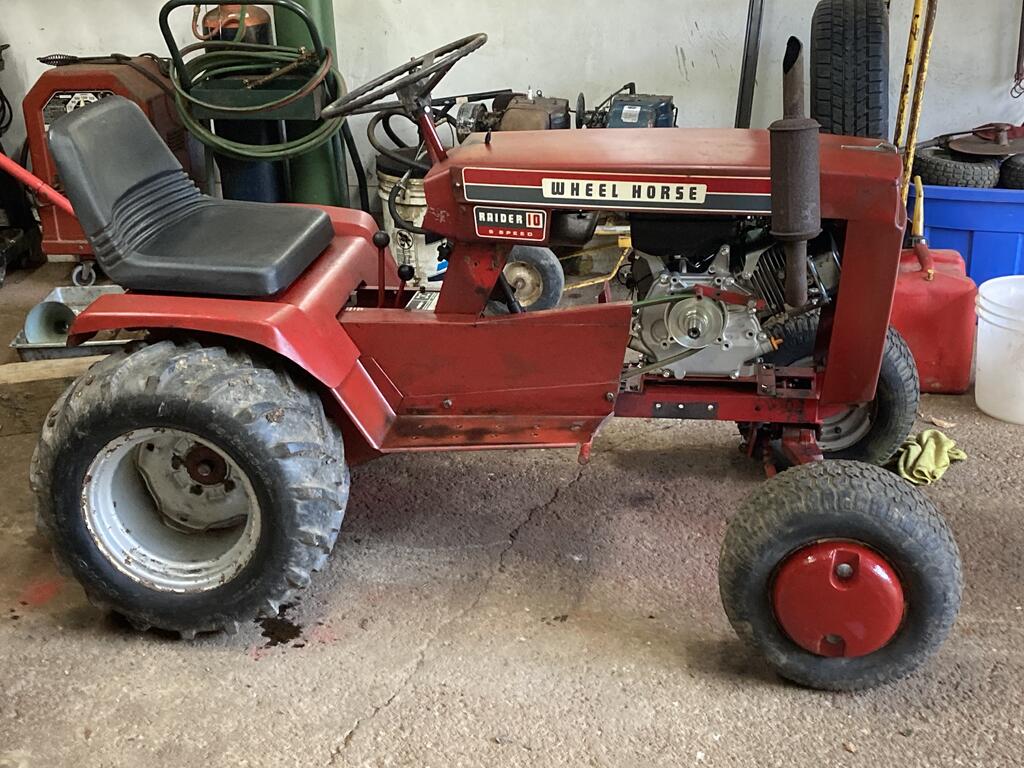

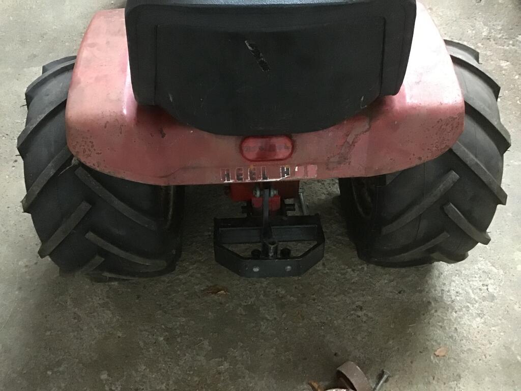

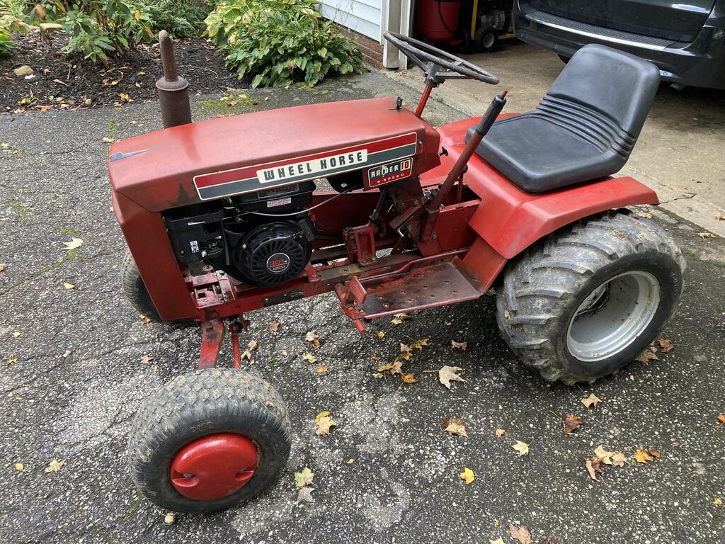

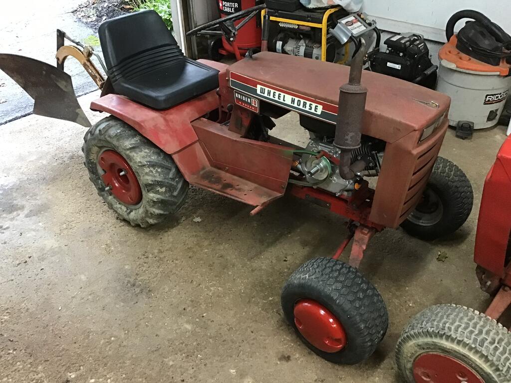

slim67 2,825 #1 Posted September 23, 2021 This is a work in progress Raider 10 with a 8 hp predator that I set up for an upcoming plow day event in October. I have some 23s on the back in the photo but probably will put the 26s back . I made a lift cable for it tonight and have to check the plow adjustments so hopefully it’s ready. If I don’t put the the 26s on ,I’m thinking of going back to the original front axle as I don’t like the way the front track is wider than the rear. 5 2 Share this post Link to post Share on other sites

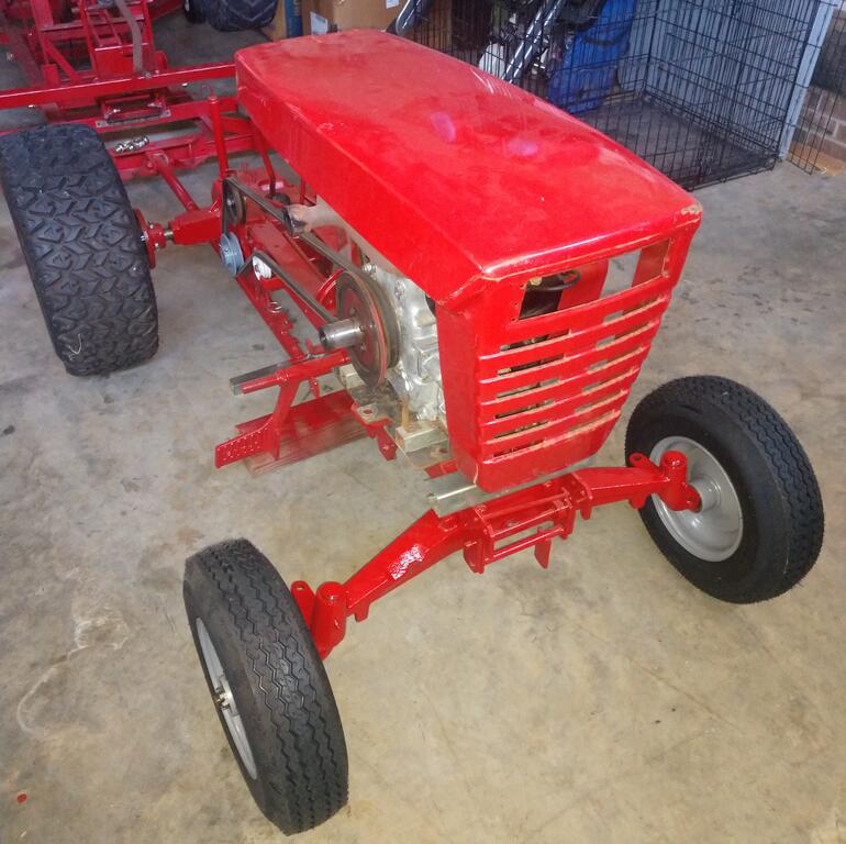

kpinnc 18,916 #2 Posted September 23, 2021 (edited) 2 hours ago, slim67 said: I’m thinking of going back to the original front axle as I don’t like the way the front track is wider than the rear. You can always add spacers. I don't like the front track wider than the rear track either. These are 5x4.5 by 2 inches. Edited September 23, 2021 by kpinnc 4 2 Share this post Link to post Share on other sites
Gregor 4,848 #3 Posted September 23, 2021 (edited) None of my Wheel Horses will accept 26" tires without rubbing on the seat pan, but then I don't have a Raider 10 either. Did you have to do a modification to adapt the 26s ? Of course I have not tries 26" Deestones. Edited September 23, 2021 by Gregor Share this post Link to post Share on other sites

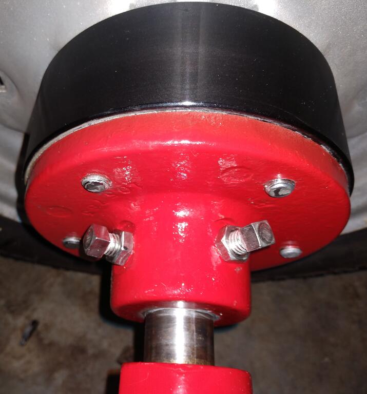

ebinmaine 80,483 #4 Posted September 23, 2021 5 hours ago, kpinnc said: You can always add spacers. I don't like the front track wider than the rear track either. These are 5x4.5 by 2 inches That was my first thought as well. @slim67 I keep a list things needed with fleabay links if you want it. 5 hours ago, kpinnc said: I change every tractor we build over to lugs and studs. No more wheel bolts. Much easier to swap or install wheels. 2 Share this post Link to post Share on other sites
Gregor 4,848 #5 Posted September 23, 2021 1 minute ago, ebinmaine said: I change every tractor we build over to lugs and studs. No more wheel bolts. Much easier to swap or install wheels. I am in the process of doing that as well. 2 1 Share this post Link to post Share on other sites
slim67 2,825 #6 Posted September 23, 2021 1 hour ago, Gregor said: None of my Wheel Horses will accept 26" tires without rubbing on the seat pan, but then I don't have a Raider 10 either. Did you have to do a modification to adapt the 26s ? Of course I have not tries 26" Deestones. I have had them on this tractor and another and they are too close for comfort. I had a set of Goodyear’s and they cleared. I’ve used aluminum wheel spacers on my golf cart builds. Share this post Link to post Share on other sites

squonk 48,010 #9 Posted September 23, 2021 You can add spacers to the fender pan to raise it for the larger tires too. 2 Share this post Link to post Share on other sites

slim67 2,825 #11 Posted September 23, 2021 43 minutes ago, pullstart said: If it works out for ya, there’s @WHX??’s plow day in a couple two-three weeks too! I’d say the skinny track will help the plow find it’s sweet spot easier. I’m wondering if this wider axle will keep the rear too far out to the left when following the furrow. 1 Share this post Link to post Share on other sites
slim67 2,825 #12 Posted September 23, 2021 28 minutes ago, squonk said: You can add spacers to the fender pan to raise it for the larger tires too. This is a flip up rear fender but I have though about swapping out the body work for a fixed set and adding some unistrut for spacing. Thanks for the suggestion. Share this post Link to post Share on other sites

kpinnc 18,916 #15 Posted September 23, 2021 3 hours ago, ebinmaine said: 9 hours ago, kpinnc said: I change every tractor we build over to lugs and studs. No more wheel bolts. Much easier to swap or install wheels. Agreed. Night and day difference instead of annoying bolts. Getting a wheel "started" with factory bolts just flat out sucks. Add any additional weight, it becomes much worse. 2 Share this post Link to post Share on other sites

Pullstart 71,175 #20 Posted September 23, 2021 Just thinking. Putt Putt is a shorter wheelbase 8 hp / 8 speed mutt kind of like your Raider here. I usually pull a 10” plow, but it’s not easy on anything. Make sure you have a good belt and I’d advise that 26” tires might be too much once that plow is in the ground. I also have a smaller engine pulley, but either way it’s tough work on the tractor Share this post Link to post Share on other sites
slim67 2,825 #21 Posted September 23, 2021 2 hours ago, pullstart said: Just thinking. Putt Putt is a shorter wheelbase 8 hp / 8 speed mutt kind of like your Raider here. I usually pull a 10” plow, but it’s not easy on anything. Make sure you have a good belt and I’d advise that 26” tires might be too much once that plow is in the ground. I also have a smaller engine pulley, but either way it’s tough work on the tractor Thanks Kevin. I think I’m going to sell a set of 26s and stay with 23s. I also have a 10 inch plow. 1 Share this post Link to post Share on other sites

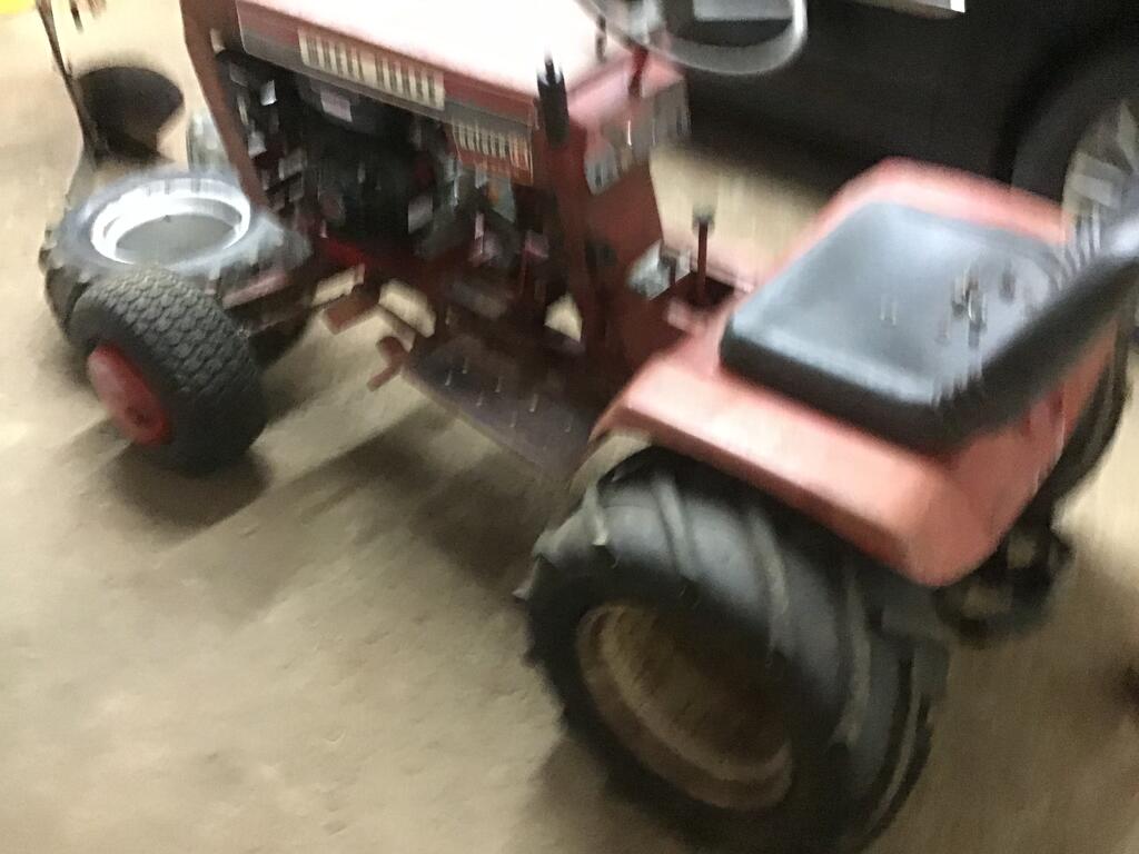

slim67 2,825 #22 Posted September 28, 2021 So awhile back I scored some NOS Carlisle 26 inch ags for this tractor for a really good price, thinking if I couldn’t use them then I’d resell them. Well it turns out on this particular tractor that tires that big don’t allow the rear fenders to fully tilt backwards so I can check diff oil. I found a set of 23 inch Carlisles with wheels used once or twice on a pulling tractor. The wheels have the extreme negative offset like my 520 rear wheels which evens out the stance and gives it that much more width. The guy traded me even for them since he has a D200 with a loader and backhoe. It worked out for both of us. He also is into vintage garden tractors and had several I think everyone here would appreciate including a Kitty Track for parts/ restoration. He is friends with a member here and attends the same local show that I do. Turned out to be a good day. 3 3 Share this post Link to post Share on other sites

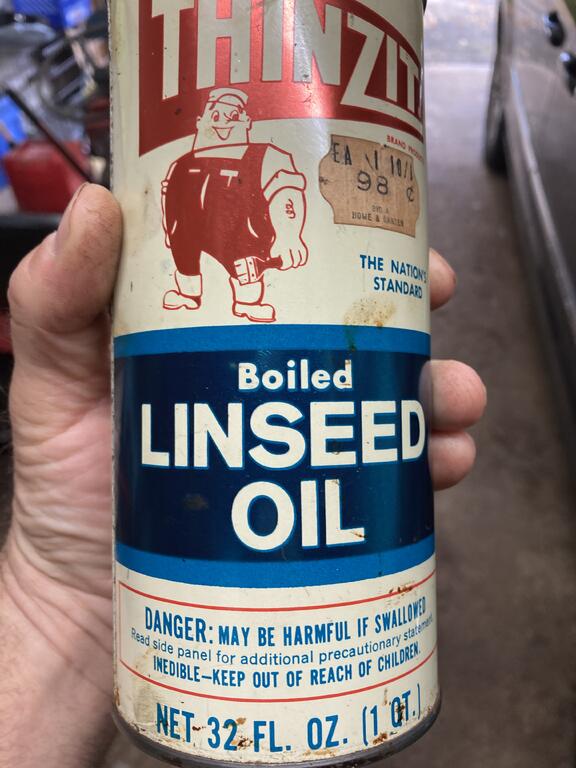

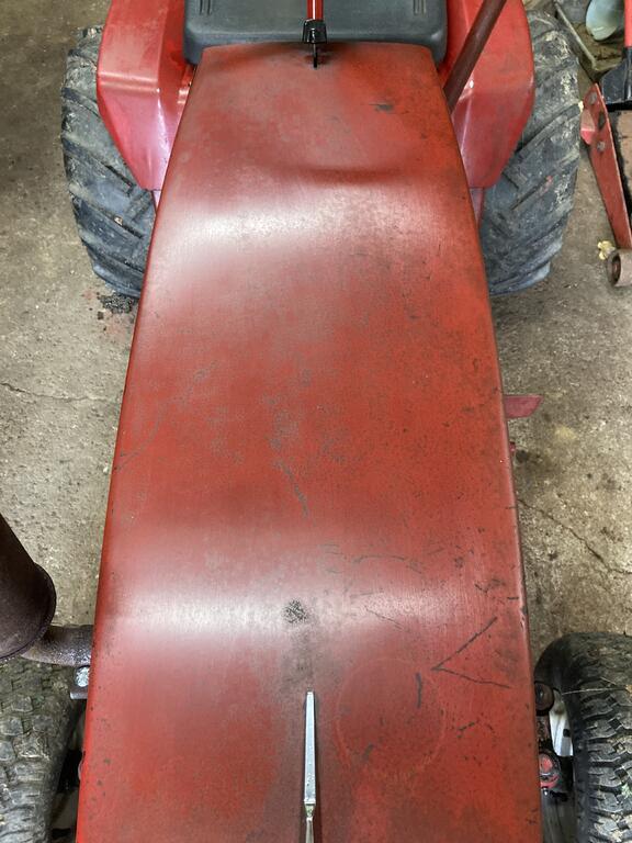

slim67 2,825 #23 Posted October 4, 2021 I tried the linseed oil treatment and have to say I like it especially since I couldn’t do a nice paint job to save my life. Maybe I just need more patience but they have never been show quality when I did do one. I found this can downstairs and have no clue as to how old it is but I didn’t see an expiration date. This is my first linseed oil attempt. 6 1 Share this post Link to post Share on other sites
Jeff-C175 7,211 #24 Posted October 5, 2021 (edited) 9 hours ago, slim67 said: linseed oil Once it cures real well you may be able to buff up a little more shine. Edited October 5, 2021 by Jeff-C175 1 Share this post Link to post Share on other sites
WHX?? 57,956 #25 Posted October 5, 2021 Can looks as old as the tractor Slim. Linseed does work, looks great and a fair to middlin metal protector but does have it's drawbacks. It attracts dust and does need to be reapplied occasionally. I would suggest you stay with 23s on the rear but eventually go with tri ribs on the front. Tri ribs are easier to control in the furrow. Those turfs are going to want to "plow" as well if soft soil. Gotta like your front weights tho! 5 Share this post Link to post Share on other sites
