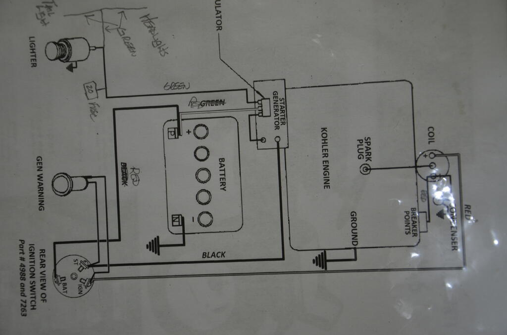

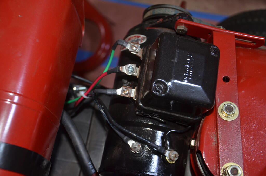

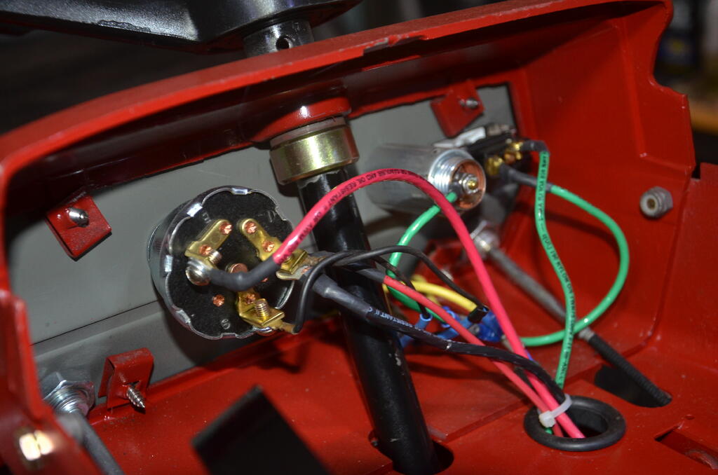

One of the prior owners had added head and tail light to the tractor (876's did not have lights)
I am getting down the the "short strokes" with the rebuild and trying to figure out the best place to add the circuit.
My thoughts so far are to tap into the cigar lighter and run the wire over to the wafer switch (the PO did an outstanding job installing the switch to the dash panel)
As most of the tractors that HAVE lights use a fuse in the circuit and I have been thinking of putting the fuse between the cigar lighter and the wafer switch.
YES/NO??? Other ideas?
When I disassembled the tractor I know that there was no fuse and I am not real sure about wires
(I wasn't paying that much attention to the wires as I had the diagram and didn't realize then that the 876 didn't have lights)
