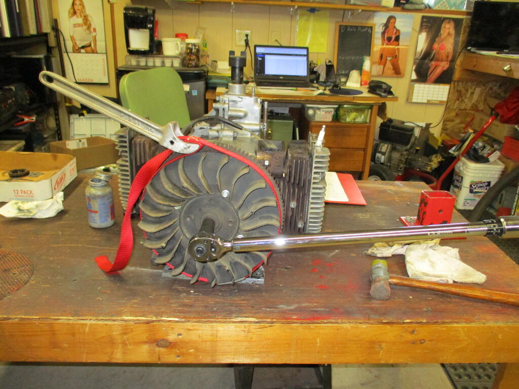

pfrederi 20,884 #31 Posted September 30, 2021 Strap wrench 1 Share this post Link to post Share on other sites
Gregor 4,848 #32 Posted September 30, 2021 Is that a Rigid? Share this post Link to post Share on other sites
pfrederi 20,884 #33 Posted September 30, 2021 OTC 7206 Made in USA Share this post Link to post Share on other sites
Gregor 4,848 #34 Posted September 30, 2021 Ordered one. Share this post Link to post Share on other sites

Snoopy11 5,731 #47 Posted November 20, 2021 On 9/29/2021 at 8:52 PM, upstateyankee50 said: yep you are right but first I need to find away to remove the nut as not to damage the fly wheel ;as there is no way that I can stop the wheel from turning ;a nice impact would be great but that is one item I do not have tomorrow is another day ;thanks again An old mechanic taught me this. Take a screwdriver, a nice long one, put a rubber plug on the end... such as one of these: And put the screwdriver down into the spark plug hole, rotating the engine over until the screwdriver stops piston movement. Then use a breaker bar to remove the flywheel nut. Boom... Don Share this post Link to post Share on other sites
