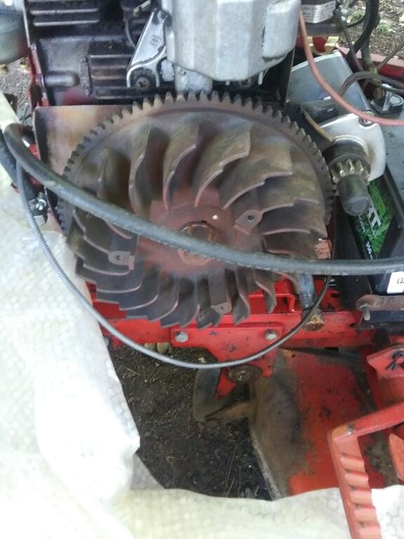

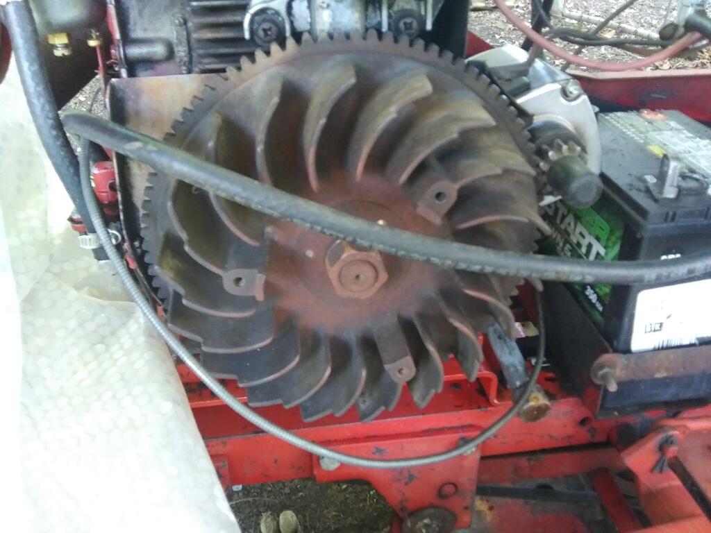

upstateyankee50 59 #13 Posted September 22, 2021 1 hour ago, Gregor said: Ed Stoller is the man who made the video. yep thanks ;if this is of any help my daughter snapped a few pictures and this time they came though; it shows the solid state ignition right on top of the fly wheel ' Share this post Link to post Share on other sites
upstateyankee50 59 #14 Posted September 22, 2021 2 hours ago, pfrederi said: When you look at the manual it shows you how to set the air gap between the pins and the module.. thanks I will check it out ;my daughter was able to snap a few pictures of the solid state ignition system if this helps ;as I mentioned before I removed that item cleaned the bottom off rom all of the grim and dirt that was stuck to it as I thought that might had been an issue plus cleaned the pins that rotate around and are suppose to hit on the bottom of the unit though I am not sure if there is an adjustment on the clearance where the pins hit ;as I had a 12 horse with the breaker -less ignition and I was able to adjust that one 'plus it shows the small black wire that is attached to the upper left of the unit which if I am correct is for power to activate the unit Share this post Link to post Share on other sites
Gregor 4,848 #15 Posted September 22, 2021 Have you located the trigger pins behind the ring gear, and checked gap? I would also check all wiring coming form that ignition module for shorts, or breaks. Share this post Link to post Share on other sites

upstateyankee50 59 #17 Posted September 27, 2021 (edited) On 9/22/2021 at 6:18 PM, Gregor said: Have you located the trigger pins behind the ring gear, and checked gap? I would also check all wiring coming form that ignition module for shorts, or breaks. yes I have check the trigger pins and again watched the video's that were sent but it seems that he is using a different module than what I have as he has a 15 inch cap between the long trigger pin as viewing the manual that I have it calls for the long trigger pin to have a clearance of 006 and the short trigger pin having the clearance of 010 which I check yesterday and using the feeler gauges with the correct numbers' long pin 006 the short 010 there was play and not really tight as they should be; the thing is that I have a solid state ignition system not like the one he shows in his video ' plus the unit that I have does not allow any adjustments as there are 2 screws that are attached to the bottom where there is no slot to move down or up'' not like a breaker -less ignition system where you can adjust ;I am not sure if the pins have been worn out and need to be replaced ;than if I have to is time to remove the fly wheel Edited September 27, 2021 by upstateyankee50 Share this post Link to post Share on other sites

upstateyankee50 59 #22 Posted September 29, 2021 On 9/22/2021 at 3:52 PM, pfrederi said: When you look at the manual it shows you how to set the air gap between the pins and the module.. yes I was able to get the time to read that part and yesterday I did set the air gap ;as the long pin needs to be set at 6 the short pin at 10 ;but still it won't start 'I could be had been mislead from a guy who mentioned if I have spark it can not be the key way on the fly wheel as the key way once it travels around, the key way makes the spark that creates the spark on the solid state ignition system if I have this correct Share this post Link to post Share on other sites
upstateyankee50 59 #23 Posted September 29, 2021 On 9/22/2021 at 6:18 PM, Gregor said: Have you located the trigger pins behind the ring gear, and checked gap? I would also check all wiring coming form that ignition module for shorts, or breaks. yes I did find the trigger pins and adjusted them as the Manuel suggested ;the long pin set at 6 and the short pin set at 10 but still it will not start and to your next questions yes every wire was checked and they look fine ;thanks again Share this post Link to post Share on other sites
Gregor 4,848 #24 Posted September 29, 2021 I think it's time to bite the bullet, and remove the flywheel. CAREFULLY ! You have to check that key. IMO 1 Share this post Link to post Share on other sites
