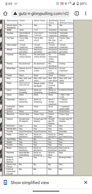

Jimdad85 12 #5 Posted September 21, 2021 I have to be 1050#, tractor, driver, helmet. There does not appear to beat a tire rule on their page but im emailing the coordinator. Pretty much everyone that pulls there is using a cub with a kohler and a 3sp. 1 Share this post Link to post Share on other sites

Jimdad85 12 #8 Posted September 22, 2021 My one friend is a avid puller and he swears by the Cub cadet rear end as well he has no clue that I have found this tractor and I can only imagine that he will be jumping to drop a Cub cadet rear end in it I don't know how everything else works but they got this little thing that measures the hitch height and everything so they know how to change all that I believe legal tires are 24x10x12 so I'm going to need some new rubber and some new rims I thought about removing some of the heavier wheel horse tin and going to like race car sheeting that way I have more control over where the weight is it would be ashamed to get rid of that cast front clip tho 1 Share this post Link to post Share on other sites
