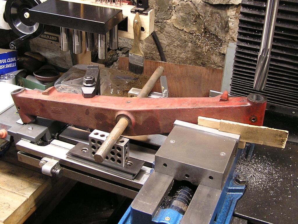

ri702bill 7,163 #3 Posted September 21, 2021 All: I've added bushings and thrust washers to two cambered axles recently. I flycut the lower splindle boss in the same setup as drilling and reaming - this is to give room for the thrust washer and allow me to machine out the vertical play. I do the same with the pivot boss - the back boss gets chewed up so I machine about .020 off to clean it and leave room for a .030 washer. 1 Share this post Link to post Share on other sites

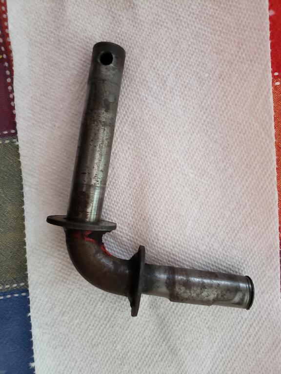

71_Bronco 1,072 #8 Posted September 22, 2021 Not sure what the original stock wheels had for "bushings" on my '62 Lawn Ranger (can check tonight). Regardless, the non-bearing wheels did a number on the shafts of my spindles (see pic below). Though, I'm sure things have changed / been improved over the last 60 years since this tractor was built lol Side note, I have seen the "oil-lite bronze" bushings used at my old job (CNC machine shop). In most cases, I believe the parts sliding inside the bearings were hardened steel, not plain carbon steel. Not sure if that would make a difference. Share this post Link to post Share on other sites
