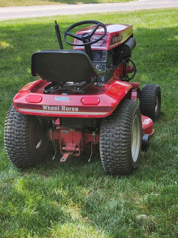

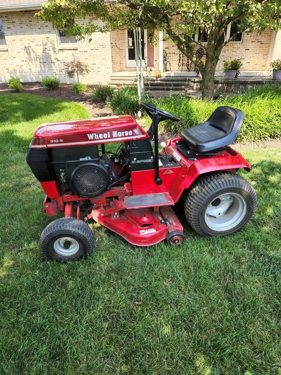

ReelFaster 53 #27 Posted July 13, 2022 (edited) Hi folks, circling back and started looking at picking up a wheel horse for my mowing and the occasional trailer and boat moving around the property. Couple of quick questions I am kind of hung up on. One is the hydraulic lift? What exactly is it and what does it do? Other question I have and most of you have answer is hydro vs. manual transmission. I never really drove a manual transmission anything except for an older ATV. My property is not very big but goes far back in a rectangular shape for about 0.82 of an acre. Much of that I don't touch except for the occasion downed tree that I'll use for firewood. However I am not opposed to it! How hard is using a manual transmission? Is it that much of a PITA? I see more of them than anything, the hydros are bit pricier as expected. Prices I am seeing are all over from $400 to over $2000, sweet spot for a good condition one is around $900 - $1500. Here is a real beauty asking $650 I am looking at. Bit of a drive for me but might be worth it. Many other locally but not in as good condition and a bit more asking price. I am seeing a lot of 312-8 models.... Thanks in advance! Edited July 13, 2022 by ReelFaster Remove FB Link 3 Share this post Link to post Share on other sites

Pullstart 71,191 #31 Posted July 13, 2022 @ReelFaster the pictures above show a lift arm on the left. It has numerous uses, such as a snow plow, snow blower, mower deck, one bottom plow or cultivator, etc. It gets heavy after a while if lifting and lowering and the hydro lift eliminates that arm and replaces it with a hydraulic cylinder to do the big work. There are also electric lift units on occasion too. Don’t think driving a manual like a car. Garden tractors, you push in the clutch, select what gear you want, then let it out. There is no shifting, no engine speed matching, etc. you run a GT engine at full rpm for best oiling of the engine. Best of luck on finding one! 4 Share this post Link to post Share on other sites
oliver2-44 11,730 #32 Posted July 13, 2022 The WH 310-8 and 312-8 are great all around machines. That 310 is a pre Toro. I think Toro bought them in roughly 1992. It has a Kohler magnum engine so is1985 or later. The magnum engine has solid state ignition so no points or condenser tune up needed. The C series of the 1970’s and 300,400,500 series of the 1980’s had simpler electrical systems. In the 90’s and later lots of Consumer Safety laws added electrical safety switches ie more complex wiring to the 300,400,500 series. I refurbished a free/rundown 1984 312-8 for my son and he mow’s and pulls a small trailer with it. I have C series gear and hydro and mow and have done a lot of yard dirt work with each kind. No snow in Texas. 2 Share this post Link to post Share on other sites

kpinnc 18,919 #34 Posted July 13, 2022 (edited) Your pics are of a 310-8, and that is a great machine. The deck in the pic is a 36 inch, so that tractor has plenty of torque for that setup. I have several machines, but my 310-8 was my first Wheel Horse. I bought it used back in 99. Today, it is still my hardest worker and most dependable. Not all the bells and whistles of higher hp machines, but still just as tough. It is more than capable enough to move heavy trailers around. Just be aware, as has already been said- these tractors have great power. They can move much more weight than the brakes can stop. Towing on a hill can be dangerous! Edited July 13, 2022 by kpinnc 3 Share this post Link to post Share on other sites

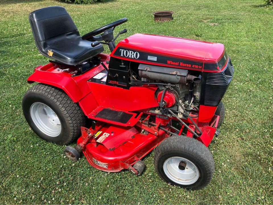

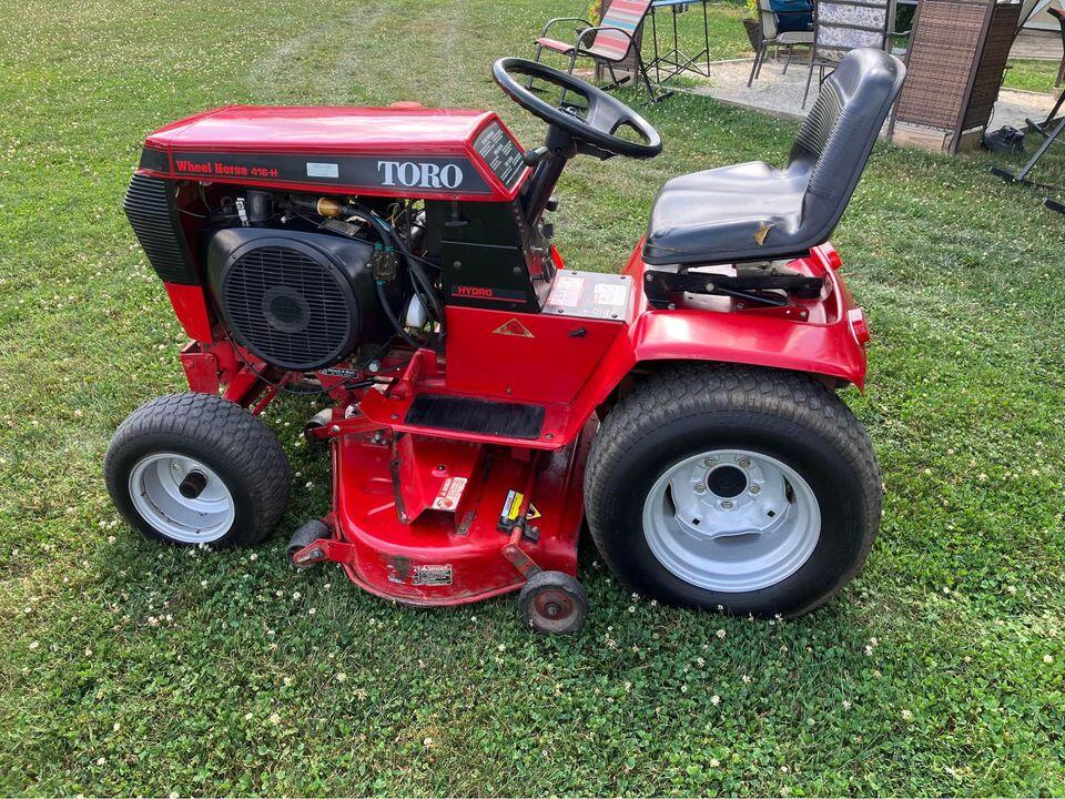

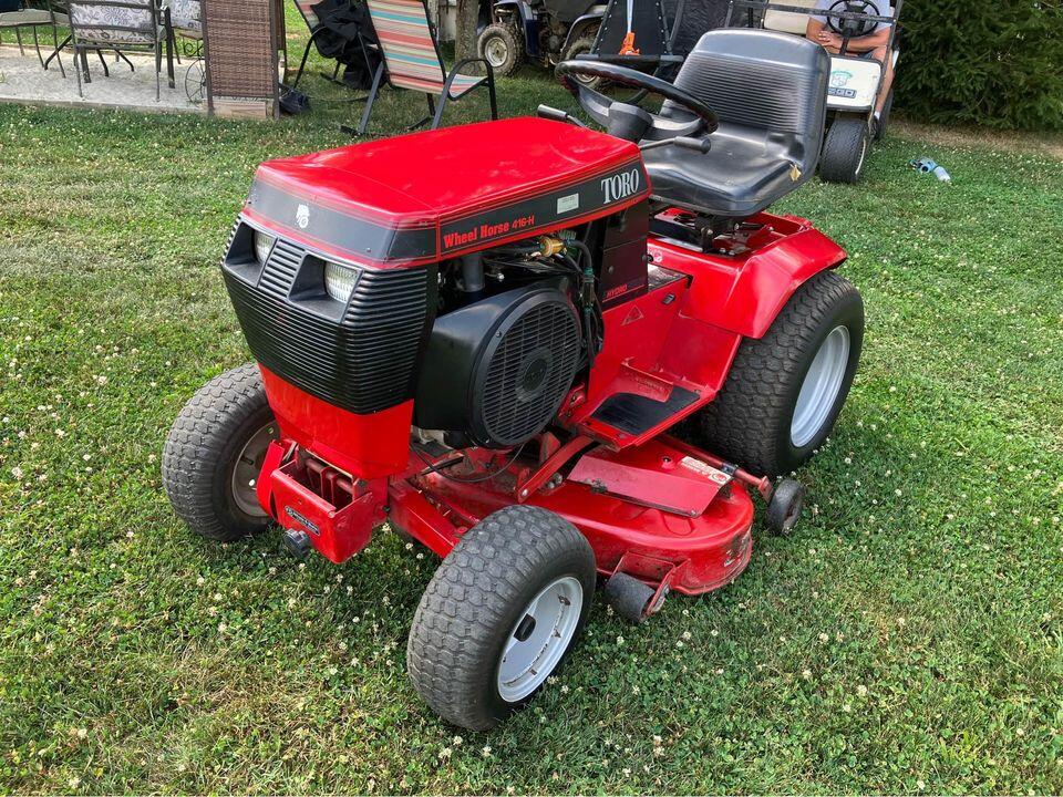

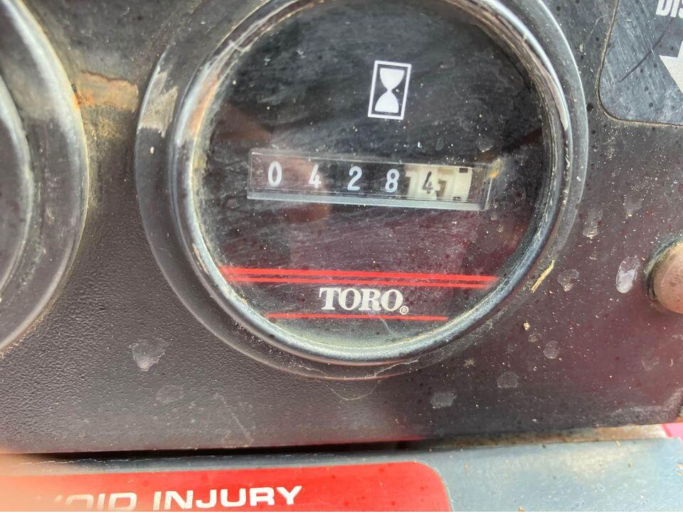

ReelFaster 53 #43 Posted July 17, 2022 That prior 310-8 sold pretty quick as I knew it would. In discussions and looking at this 416-H, low hours and in what looks to be very good cosmetic condition. 2 Share this post Link to post Share on other sites
sergeant 350 #44 Posted July 19, 2022 On 7/17/2022 at 8:26 AM, ReelFaster said: That prior 310-8 sold pretty quick as I knew it would. In discussions and looking at this 416-H, low hours and in what looks to be very good cosmetic condition. Boy Looks as good as the 1992 416H I Bought 2 years ago. The 416H was One I had been Hunting for for awhile Had Looked at Buying One Back In the 1990's ended Up with a Ingersoll 3016PS instead at the time. But so Far it Has been a Great WH for Me. Around me people tend to Hold On to there Wheel Horses so I had to travel about 5hrs round trip to pick up my 416H. I Just Have a 42inch deck and a clevis Hitch for My 416H. The 416H has Just been used as a Garden cultivating tractor or a Cart Puller 1 Share this post Link to post Share on other sites
