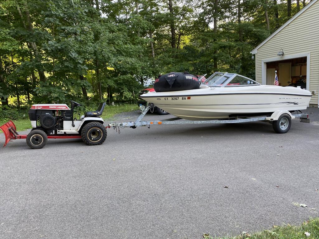

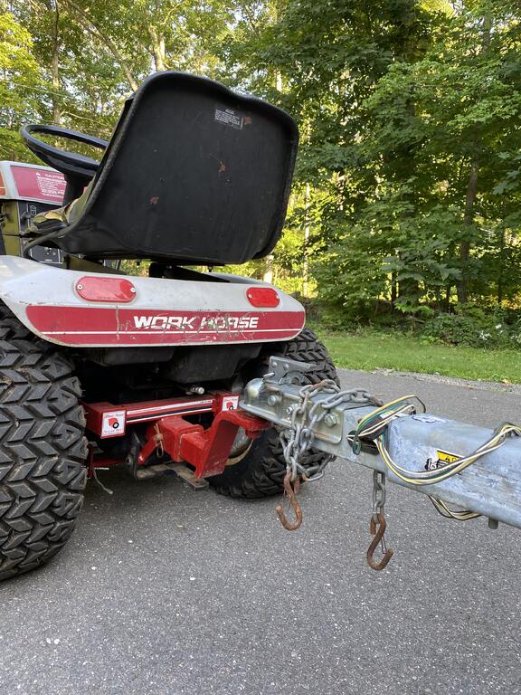

Sparky-(Admin) 26,279 #10 Posted September 20, 2021 That style hitch you posted is what I use to move my 16’ aluminum bass boat and just recently my 17.5’ fiberglass bow rider. The machine in the pics has a 10 hp Kohler mated to an 8 speed manual tranny. Also has 75#’s of weight on each rear rim plus 25#’s on each front rim. It’s firmly planted to the ground! 3 Share this post Link to post Share on other sites
biged77 113 #11 Posted September 20, 2021 One of our vendors Wheel Horse Parts and More also has receiver hitches. Great quality and easy to install. Check them out at https://wheelhorsepartsandmore.com/product-category/hitches/ 2 Share this post Link to post Share on other sites
8ntruck 9,270 #12 Posted September 20, 2021 I built my receiver hitch. Those are a handy thing. When using one of those receiver hitches, you need to exercise a little care. The towing load of the trailer is applied above the center line of the axle, which will tend to pull the front wheels off of the ground. The driving torque being applied by the rear wheels also tries to lift the front tires. If your trailer does not want to move, the tractor will easily pull a wheelie. Not a problem if you are expecting this, and can clutch before you get into trouble. Also, if the tractor is headed up hill, it takes less force to pull it over backwards. 3 Share this post Link to post Share on other sites

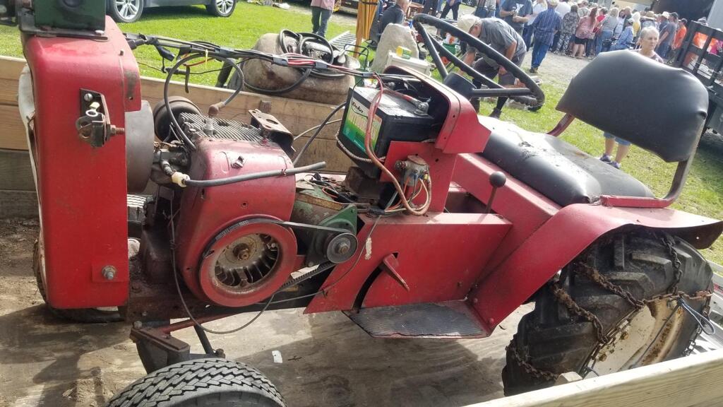

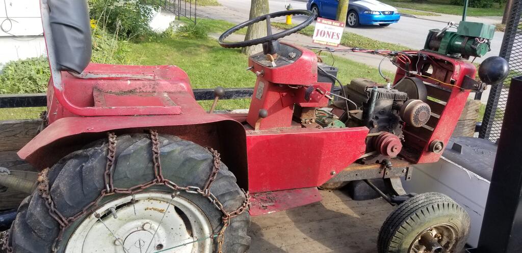

Jimdad85 12 #13 Posted September 21, 2021 I am also very new to wheelhorse. I have learned that toro bought them out in the late 80's. Thats all i know. I picked up this beaut today and going to transform to a puller. What am i dealing with here?? 2 1 Share this post Link to post Share on other sites

kpinnc 18,919 #18 Posted September 21, 2021 17 hours ago, ReelFaster said: P.S. Looking to put something like this on it for moving boat & trailer. Glad to see you already did some research and found that hitch. The factory drawbar hitch is plenty strong, but often gets a heavy trailer dropped on it, which cracks the bottom of the tranny case. The add on receiver is an excellent addition! 2 Share this post Link to post Share on other sites

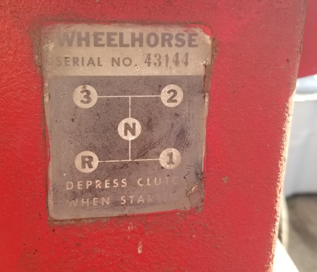

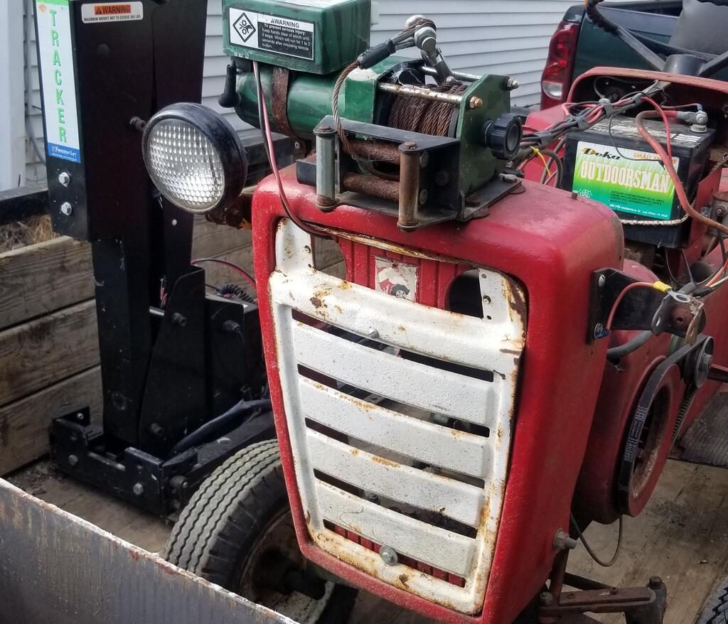

953 nut 69,021 #19 Posted September 21, 2021 11 hours ago, Jimdad85 said: I picked up this beaut today and going to transform to a puller. What am i dealing with here?? You have a 1964 Model 1054 that has seen a few modifications in the past. We have a section on Red Square dedicated to pullers, you can probably get a lot of good information there. https://www.wheelhorseforum.com/forum/48-pullers/ 3 Share this post Link to post Share on other sites
Pullstart 71,191 #20 Posted September 21, 2021 17 hours ago, ReelFaster said: Are models after Toro bought them still good and reliable? I am seeing a few of those out there for sale! Generally anything with a horizontal shaft engine is going to be a huge improvement over what you’re currently using. Don’t sell the Xi series short. I think it’s the most underrated Toro made machine. The frame is pickup truck quality and it still has solid power train under the steel body. @Jimdad85 nice 1054! I like the C series grille adapted to the nose! Get that winch off the cast nose and slap a hood on, you’ll have a pretty awesome machine! 3 Share this post Link to post Share on other sites

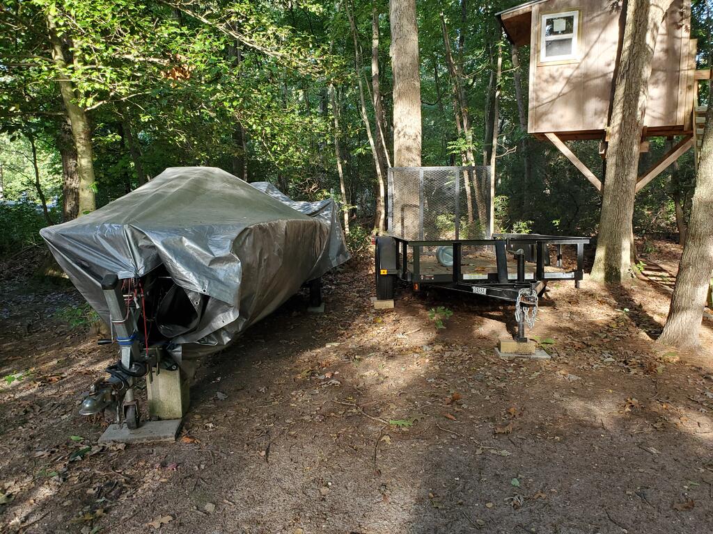

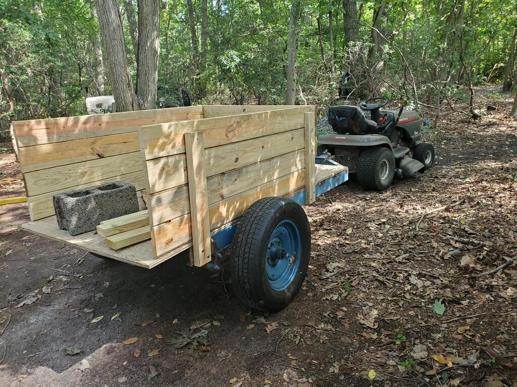

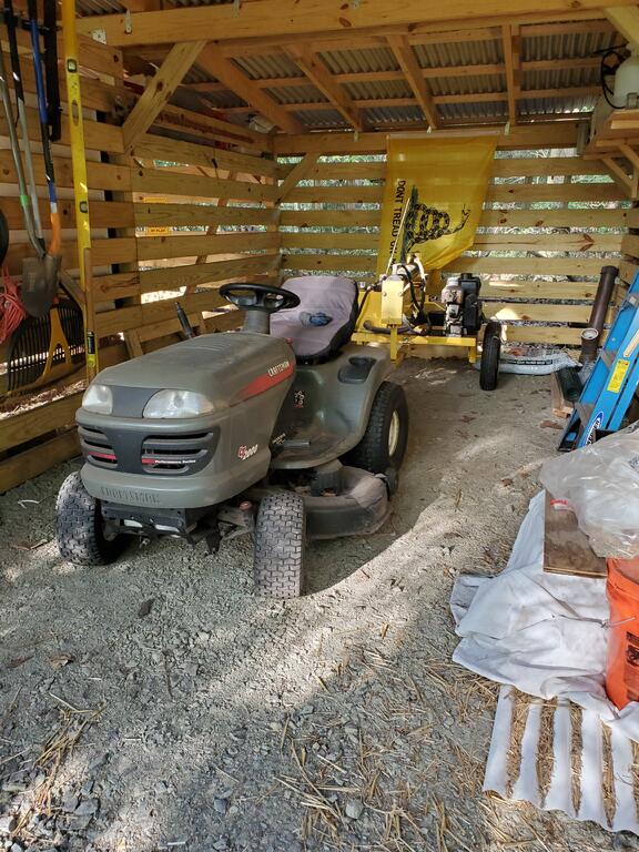

ReelFaster 53 #23 Posted September 21, 2021 @SparkyThat hitch is exactly what I am looking for, it's perfect! Here are few pic's of what I am pulling. Few times a year I am moving the boat (16ft aluminum bass boat) or trailer to and from the front of the house. Few times a year I am moving the wood splitter and probably what I use the most is the wood trailer. She's really heavy, handmade from an old farm implement, pretty sure it will outlast me. I don't have a large property so not pulling very far or long and all on a flat surface. Am pretty amazed I've gotten this far with my riding mower, credit to that little guy has served me well. I cannot thank you all enough for all the excellent and outstanding advice! Seems like a great forum here with a great group of folks. I'll take all that info and advice and keep my eyes peeled for something. 1 Share this post Link to post Share on other sites

Tuneup 1,459 #25 Posted September 22, 2021 I've pulled a couple of those Craftsmans apart after engine grenading. early MTD wasn't bad for what they were designed to do. She's served you very well. When you have a line on a WH, let us know. Plenty of experience to lean upon as you've learned. subscribed. 1 Share this post Link to post Share on other sites
