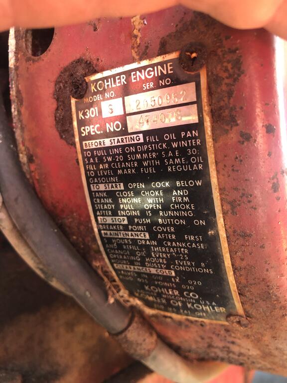

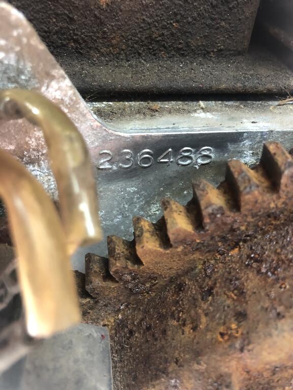

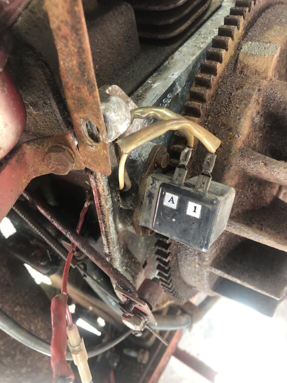

Ragman33 1 #4 Posted September 20, 2021 It’s the Kohler motor. I’ll attach the images of the data plate off the motor and casting number. I think even a wiring diagram would help me. The black box that’s beside the flywheel has no power at any terminal. I’m not too sure how these systems work, but I imagine it’s a magnetic switch in there that should send power to the coil correct? So one side of it should have power. There’s two wires running to the coil though, one from that switch, and one from somewhere else. I didn’t have too much time to fiddle with it today, but the other wire seemed to have a diode or resistor or something on it. Share this post Link to post Share on other sites
Achto 32,253 #5 Posted September 20, 2021 8 hours ago, Ragman33 said: So one side of it should have power. You have a magneto ignition, there for you should not have any power going to the coil. A magnet on the flywheel charges the coil as it passes over it, this creates your spark. The wire running from the coil to the switch grounds out the coil when the switch is in the off position. This kills the engine. The little black box is basically an electronic replacement for points. Check through our manuals section, you will find full parts and wiring manuals. Share this post Link to post Share on other sites

pfrederi 20,992 #7 Posted September 20, 2021 1 hour ago, Achto said: You have a magneto ignition, there for you should not have any power going to the coil. A magnet on the flywheel charges the coil as it passes over it, this creates your spark. The wire running from the coil to the switch grounds out the coil when the switch is in the off position. This kills the engine. The little black box is basically an electronic replacement for points. Check through our manuals section, you will find full parts and wiring manuals. NO It is a Breakerless ignition. Never apply any voltage to either terminal. There are two tests in the manual linked above for breakerless. Check the external coil for resistance and then take the trigger off (Box with I and A) Use a couple flashlight batteries and bulb to test it. 1 1 Share this post Link to post Share on other sites
Achto 32,253 #8 Posted September 20, 2021 (edited) 50 minutes ago, pfrederi said: It is a Breakerless ignition. Thanks, I was going on this statement from the manual to try to help simplify the understanding of the system. (The breakerless ignition system operates on the same general principle as the magneto system but does not use breaker points and conventional ignition condenser to time the spark. A trigger module containing solid state electronics performs the same function as the breaker points.) Edited September 20, 2021 by Achto 1 Share this post Link to post Share on other sites
