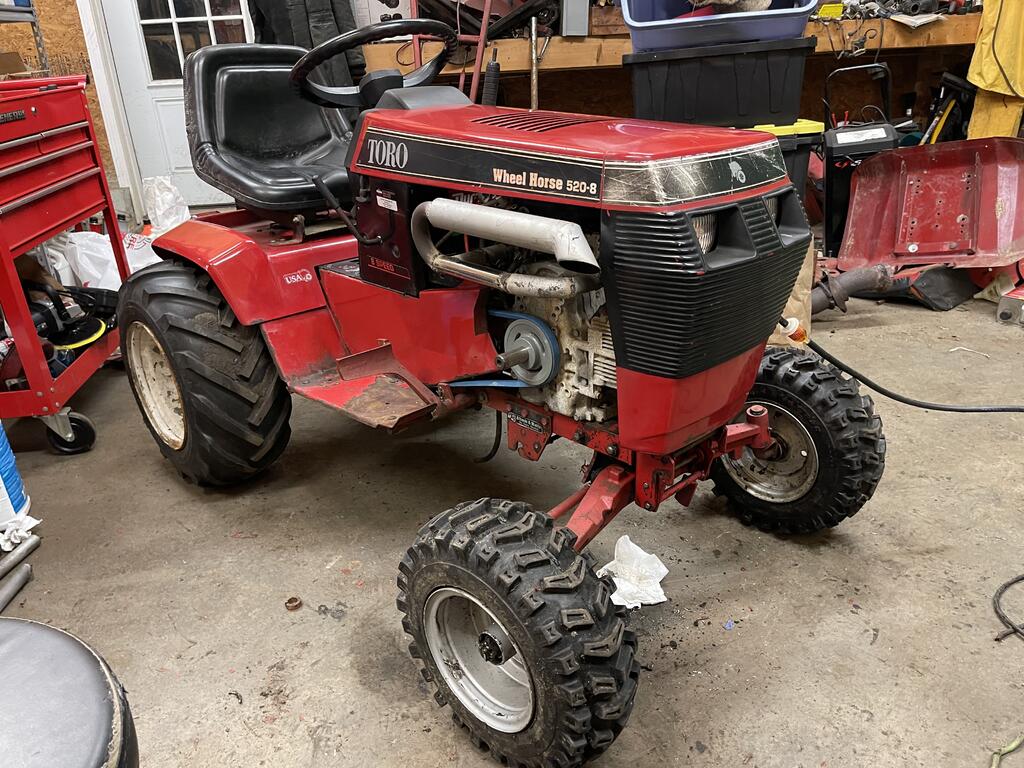

Bens vintage tractors 1,556 #76 Posted September 27, 2021 Well she’s almost done for now. I’ll post some better pics tomorrow. I’ll also make a build thread incase anyone wants to see the whole built. 4 Share this post Link to post Share on other sites

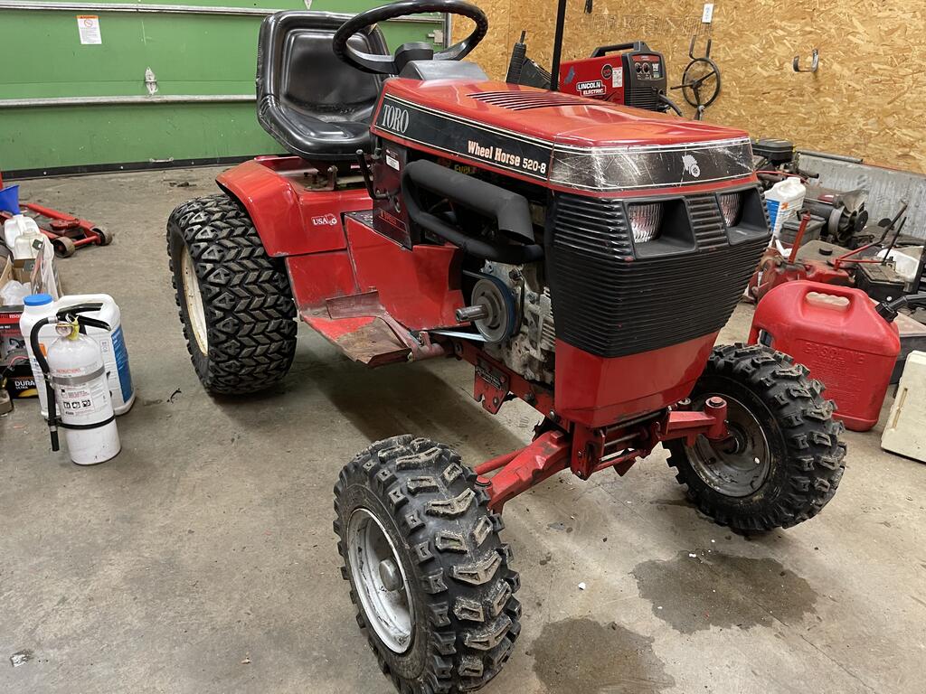

Bens vintage tractors 1,556 #82 Posted September 30, 2021 Well that’s a rap for now. Not 100% finished but all it needs to be perfect is some paint and grip tape on the floorboards. Very happy with the outcome. 7 Share this post Link to post Share on other sites

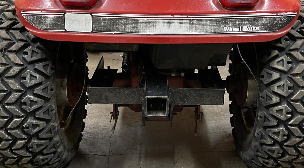

Bens vintage tractors 1,556 #83 Posted September 30, 2021 Also put my custom hitch receiver on it. 2 2 Share this post Link to post Share on other sites

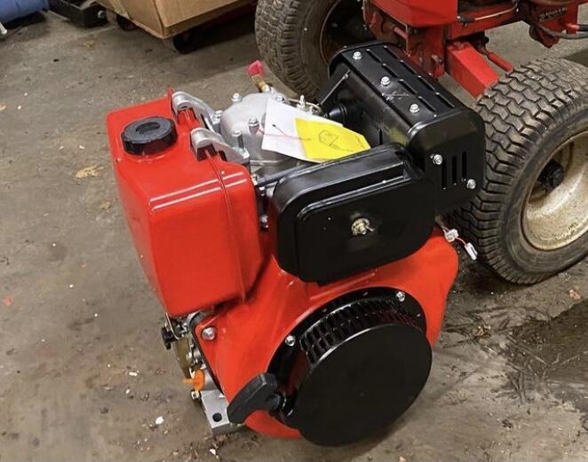

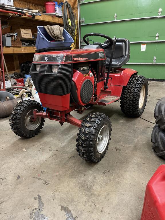

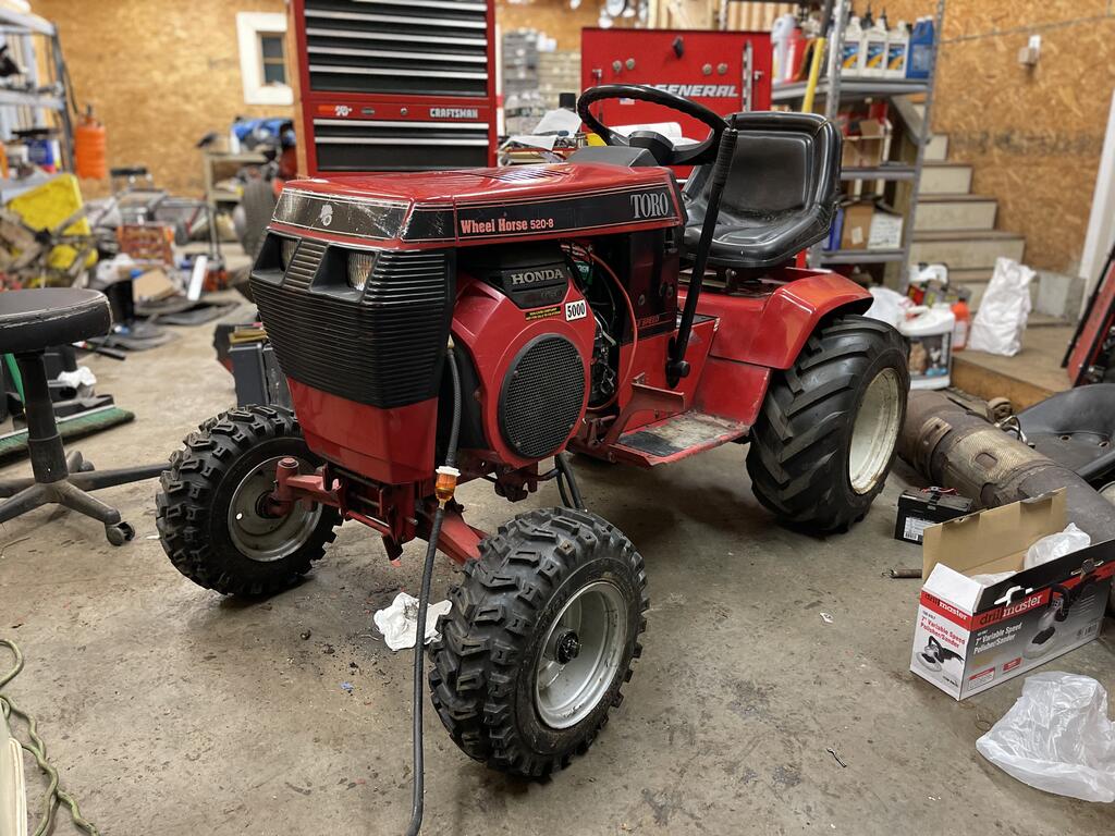

Bens vintage tractors 1,556 #86 Posted October 16, 2021 Well…. I’m not terribly happy with the 520-8. The Honda decided it doesn’t want to run right.. cleaned the carb, adjusted the governor, I even changed the spark plugs and it still runs funny.. thinking this little brand new diesel I have might end up in the 520… I’m hoping to have this and my B-160 done for Steve’s meet and greet.. 1 Share this post Link to post Share on other sites
littleredrider 409 #87 Posted October 16, 2021 You won't be disappointed with that diesel!!!! I love the one that I have. It's on a hydro, but still has insane amount of torque for the size of the engine. I never finished the wiring on it, electric start works but battery keeps going low. But it will start on the first pull. 1 Share this post Link to post Share on other sites
peter lena 10,030 #88 Posted October 16, 2021 @littleredrider , increasing my electrical grounding made a total gain on electrical issues , best gain , battery ground rail point , 4 ga cable from there to , lower engine corner , near clutch pedal , serated washers , dielectric grease , 10 / 12 ga ground wire from front engine corner to rectifier mount point on cooling shroud , dielectric grease . eliminated all my issues , worth a look , pete 1 Share this post Link to post Share on other sites
Bens vintage tractors 1,556 #89 Posted October 16, 2021 5 hours ago, littleredrider said: You won't be disappointed with that diesel I’ve got a few other single cylinder diesels and love them all so far.. Share this post Link to post Share on other sites
kpinnc 18,916 #90 Posted October 16, 2021 Aw man, I liked the Honda! Diesel will be very cool though! Share this post Link to post Share on other sites
