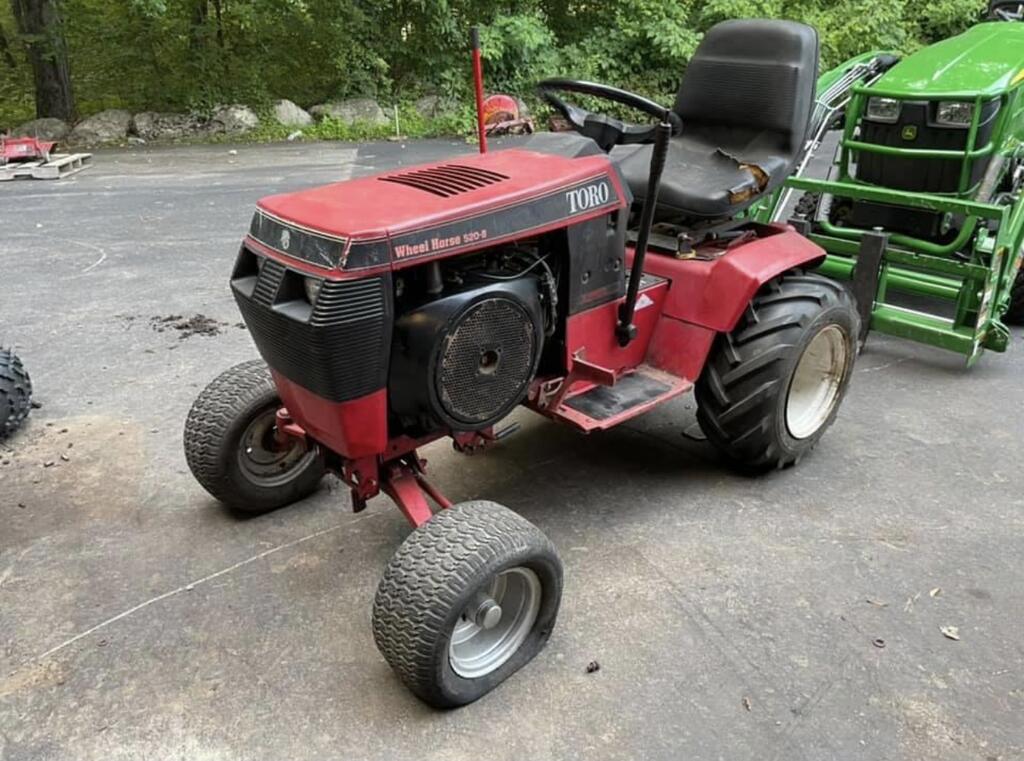

Bens vintage tractors 1,555 #1 Posted September 17, 2021 Well it’s finally time to start the repower on my 520-8. The Onan blew up (believe it broke a rod). I offered the whole tractor for sale for a couple of months but nobody wanted it. So I will be repowering it with a 27hp Honda vtwin. Hopefully going to get the PTO hooked up so I can till and snow blow with the tractor still. I have always wanted a 520-8 but I hate onans (onans are fine when they are running I’ve actually had a 520h with an onan that I loved. But once the onan breaks they are boat anchors to me) this is my chance to finally have a 520-8 with a newer engine! Also I have already found someone who wants the onan for parts so it will not go to waste! 5 1 Share this post Link to post Share on other sites

SPINJIM 1,997 #6 Posted September 17, 2021 Were you able to find a Honda twin that easily adapts to the 520? I've been considering doing the same. Someone used to sell a Honda or a B&S with an adapter kit for the WH 520, but don't know if it's available anymore. Jim 1 Share this post Link to post Share on other sites
Bens vintage tractors 1,555 #7 Posted September 17, 2021 12 minutes ago, SPINJIM said: Were you able to find a Honda twin that easily adapts to the 520? I've been considering doing the same. Someone used to sell a Honda or a B&S with an adapter kit for the WH 520, but don't know if it's available anymore. Jim I actually just came across it and trades 2 k series kohlers for it. It looks like it’s gonna fit no problem but I will keep you guys updated! 1 Share this post Link to post Share on other sites

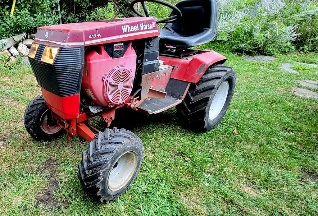

kpinnc 18,373 #10 Posted September 17, 2021 22 minutes ago, Bens vintage tractors said: My buddy has a 300 series Deere with the same Honda and it is the most powerful garden tractor I’ve ever driven. 27hp is a chunk on one of these tractors. I have seen some repowers with 33hp, and I always wondered if the stock belts and other connections would handle it. Either way we want pictures of your tractor as you convert it. We like pictures! Share this post Link to post Share on other sites
Snoopy11 5,731 #11 Posted September 17, 2021 6 hours ago, littleredrider said: Yanmar 3 banger Yeah, that would be pretty massive power production... Everyone hears that I have a 51 horsepower engine... few people know it actually dyno tested at the power level. For those types of repowers, I recommend Bando Ultrapower AG belts. THEY ARE RIDICULOUSLY STRONG!!! 1 hour ago, kpinnc said: We like pictures! Don Share this post Link to post Share on other sites

Bens vintage tractors 1,555 #23 Posted September 17, 2021 6 hours ago, kpinnc said: 27hp is a chunk on one of these tractors. I have seen some repowers with 33hp, and I always wondered if the stock belts and other connections would handle it. Either way we want pictures of your tractor as you convert it. We like pictures! I pull with wheel horses as well. I have a buddy with a 60hp wheel horse. There’s a belt we use called a 5v belt from Vbelt supply.com. I have yet to see one of those stretch or break. 2 Share this post Link to post Share on other sites
AMC RULES 37,259 #24 Posted September 17, 2021 7 hours ago, SPINJIM said: Were you able to find a Honda twin that easily adapts to the 520? I've been considering doing the same. Someone used to sell a Honda or a B&S with an adapter kit for the WH 520, but don't know if it's available anymore. Jim I believe Small Engine Wherehouse is the source for them replacement kits. Coincidentally, one of their engine replacements just jumped in my truck tonight. https://www.smallenginewarehouse.com/Repower-Old-Equipment/Repower-Wheel-Horse 2 3 Share this post Link to post Share on other sites
