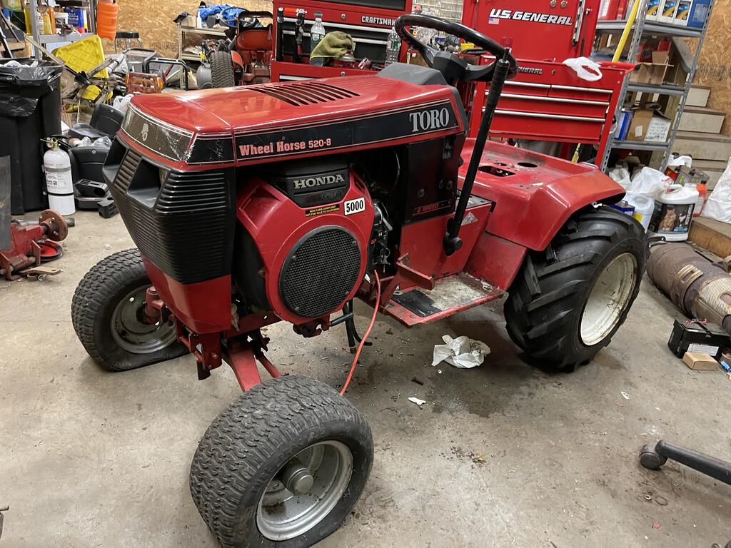

Bens vintage tractors 1,556 #51 Posted September 23, 2021 On 9/21/2021 at 4:11 PM, Sparky said: What was the Honda originally mounted in or to? Was it a generator? Wondering what the 5000 decal references This engine was brand new and I bought it with 3hrs on it. Never mounted to anything but a c81 wheel horse and now this lol 2 Share this post Link to post Share on other sites

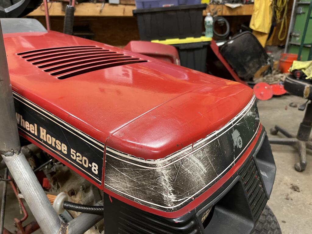

Bens vintage tractors 1,556 #52 Posted September 23, 2021 Wet sanded and polished the hood tonight. 2 3 Share this post Link to post Share on other sites

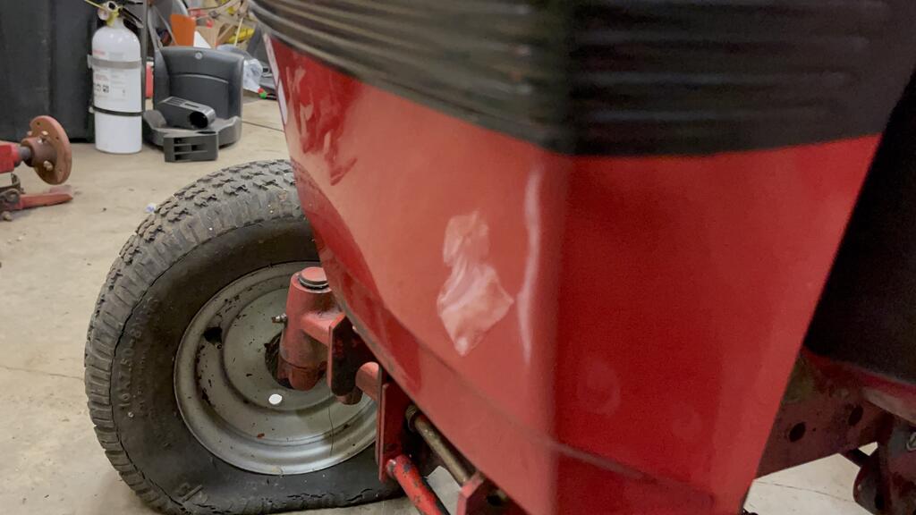

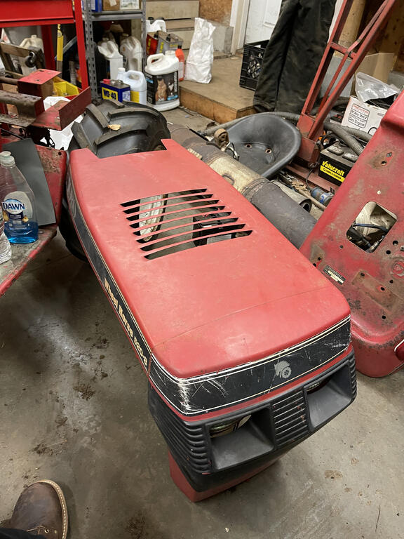

Bens vintage tractors 1,556 #53 Posted September 23, 2021 Here’s what the hood looked like before. 2 1 Share this post Link to post Share on other sites
ebinmaine 79,739 #54 Posted September 23, 2021 Nice work on the hood! 1 Share this post Link to post Share on other sites

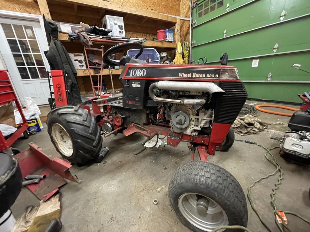

Bens vintage tractors 1,556 #55 Posted September 24, 2021 Engine is mounted, wiring is all squared away, just needs a gas tank and a battery and it should run and drive.. 1 5 Share this post Link to post Share on other sites

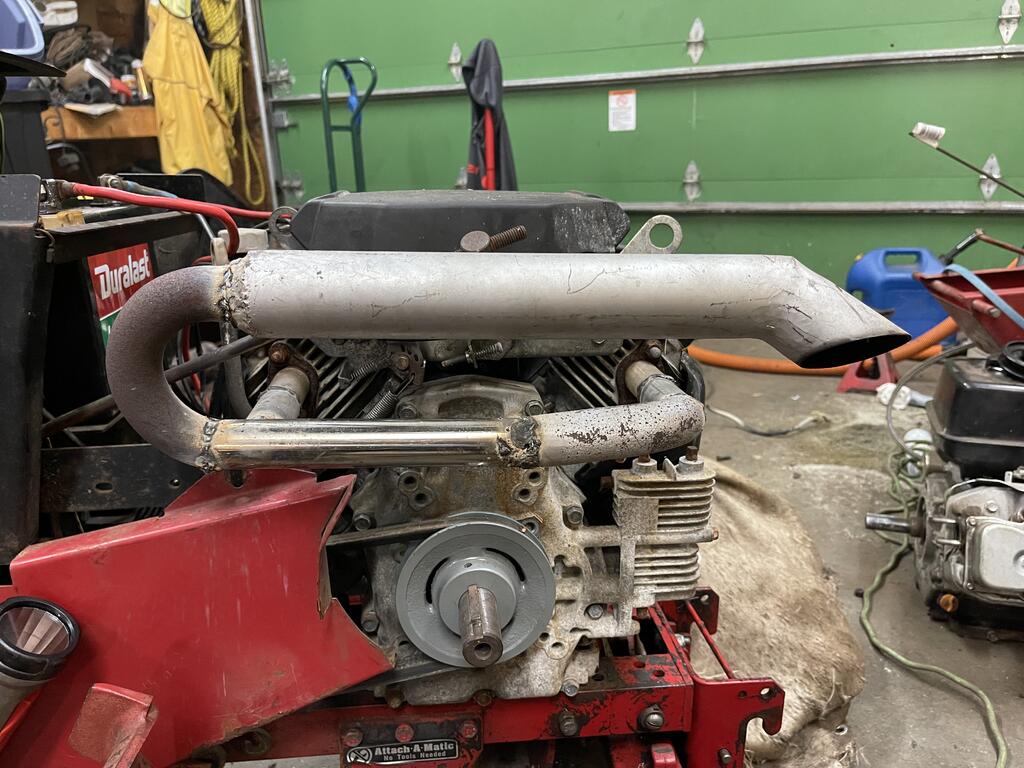

Bens vintage tractors 1,556 #59 Posted September 25, 2021 1 step closer to hearing it run! Got the exhaust built for it. Probably my favorite exhaust I’ve ever built! 1 Share this post Link to post Share on other sites

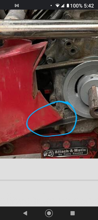

ebinmaine 79,739 #60 Posted September 25, 2021 In the area I circled in blue does the belt hit the side of the guard? That'd wear the belt off right quick. Might be fine. I can't tell from the angle. Share this post Link to post Share on other sites
kpinnc 18,756 #61 Posted September 25, 2021 (edited) I really like the look of this, but I'm thinking you may want to consider raising this engine about an inch. I've had to do the same on every repower I've ever done. WH likes those deep oil pans, and matching another engine can be tricky. You may get lucky without doing it, but the belt guard is an integral part of the "clutch" function on a manual tractor. It supports the belt so that it stops completely when the pedal is depressed. Without it, the belt continues turning and this causes difficult shifting, grinding gears, and uneccesary wear. Edited September 25, 2021 by kpinnc 1 Share this post Link to post Share on other sites
littleredrider 409 #62 Posted September 25, 2021 Having a 520-8, ur gonna need to address the belt guard. Like the others stated, it's needed on the manual trans tractors for slowing/stopping belt when clutch is engaged. Almost looks like it needs to go up n towards the back for the crank to be in the spot as the original. Or could redesign the belt guard, but think that would be harder than jsut raising the engine....Curious to hear the exhaust, mines on it's 3rd since I've had it, and not spending money on the OEM!!!! Awesome build too!! 2 Share this post Link to post Share on other sites
Lee1977 7,710 #63 Posted September 25, 2021 There is a interior flange the the bottom side of the belt lays on when the belt is stopped for changing gears. That flange is welded to the inside of the belt guard on single cylinder Kohlers. My 520-H it is bolted to the hoodstand the 520-8 drawings shows the same. With the clutch depressed the belt should lay on the flange, with the clutch out it should be above the flange. This can tell you how much you need to raise the engine. 1 Share this post Link to post Share on other sites
Bens vintage tractors 1,556 #64 Posted September 25, 2021 4 hours ago, ebinmaine said: In the area I circled in blue does the belt hit the side of the guard? That'd wear the belt off right quick. Might be fine. I can't tell from the angle. Belt guard was just sat there to make sure I could get it off once the exhaust was on. That’s all getting cut apart today 1 Share this post Link to post Share on other sites
Bens vintage tractors 1,556 #65 Posted September 25, 2021 I have done 100s of repowers on wheel horses the belt guard was just sat there to make sure the exhaust wouldn’t come close to it. I’ve already spent a couple hours making sure the belt didn’t rub anywhere since the pulleys are swapped. I appreciate the concern from everyone but trust me I know lol 3 Share this post Link to post Share on other sites
AMC RULES 37,259 #66 Posted September 25, 2021 You gotta know Ben, you can't give these guys anything. 3 Share this post Link to post Share on other sites
peter lena 9,951 #67 Posted September 25, 2021 @Bens vintage tractors really like the looks of that swap , any more details on the engine for a track down detail ? another thing while you are trimming up that belt guard , are you going to punch some vent holes in it ? looks like a neat go to swap , pete 1 Share this post Link to post Share on other sites
Bens vintage tractors 1,556 #68 Posted September 25, 2021 1 minute ago, peter lena said: @Bens vintage tractors really like the looks of that swap , any more details on the engine for a track down detail ? another thing while you are trimming up that belt guard , are you going to punch some vent holes in it ? looks like a neat go to swap , pete Honda gx690 but a predator 670 will do just the same and those are easier and cheaper. Don’t need any vents on these vtwins they keep them selves very cool. 2 1 Share this post Link to post Share on other sites
peter lena 9,951 #69 Posted September 25, 2021 @Bens vintage tractors , thank you ben, helps me to snoop around , pete Share this post Link to post Share on other sites
kpinnc 18,756 #70 Posted September 26, 2021 22 hours ago, Bens vintage tractors said: Don’t need any vents on these vtwins they keep them selves very cool. Not to mention the cylinders are above the guard unlike an opposed twin. 2 Share this post Link to post Share on other sites

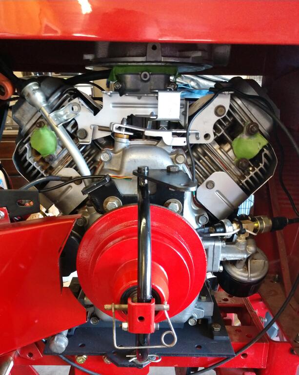

peter lena 9,951 #73 Posted September 26, 2021 @kpinnc think that picture says it all , reuse of kohler pto attachment points and brackets , cooler cylinders , spin on filter , pressurized lubrication , only thing missing is a druel bib, love it , pete Share this post Link to post Share on other sites
