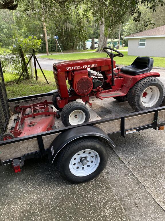

Nizm0 11 #1 Posted September 12, 2021 Hey guys! I’m new to this forum. I currently have a 1975 Wheel Horse C100 from what I can tell. It came with a box blade attachment and also a mowing deck which appears to be the 42” mode. It has the double pulley on the middle blade (smaller puller underneath the larger top one) and has a key way on the pulley to hold it in place instead of the double D setup. I am currently trying to replace the belts on it but for some odd reason I am coming up stumped. Does anybody know the belt sizes for both the deck and the engine to deck belt? Lengths maybe? I would add a photo but I am unsure how. The model numbers and serial are also unreadable from the deck. 😞 2 Share this post Link to post Share on other sites

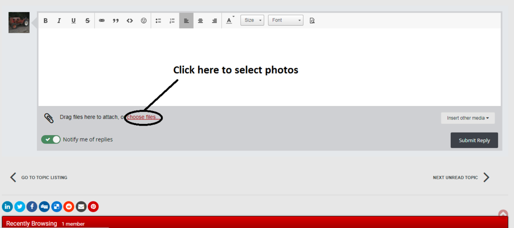

ZXT 2,402 #6 Posted September 12, 2021 Welcome to the forum! Picture attached to show you how to add photos. We'd love to see your machine! 2 Share this post Link to post Share on other sites

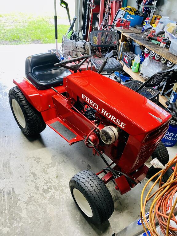

Nizm0 11 #7 Posted September 12, 2021 (edited) Here are some photos I have. I don’t have any great photos of the deck on my phone but y’all might be able to figure out which one it is by the pictures. If you can please let me know! Edited September 12, 2021 by Nizm0 4 2 Share this post Link to post Share on other sites

ZXT 2,402 #9 Posted September 14, 2021 On 9/12/2021 at 6:54 PM, Nizm0 said: Here are some photos I have. I don’t have any great photos of the deck on my phone but y’all might be able to figure out which one it is by the pictures. If you can please let me know! That is a fine looking tractor! Good to see it being used. 4 1 Share this post Link to post Share on other sites

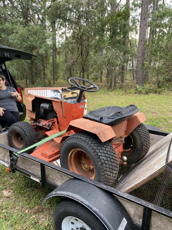

Nizm0 11 #10 Posted September 14, 2021 Thank you buddy. I’m also restoring a 1985 Case garden tractor which will be cool. Has a 12hp Koehler. All Hydrostatic even the deck Needs Jesus now but it’s in good hands. 2 Share this post Link to post Share on other sites

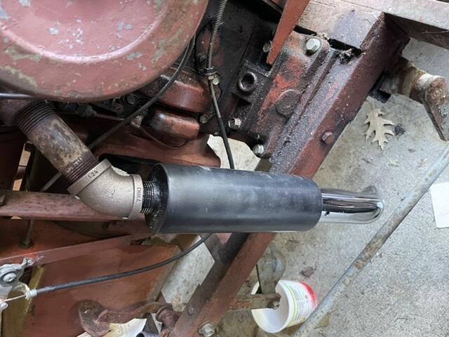

AHS 1,698 #12 Posted September 19, 2021 @Nizm0 beautiful and also rugged tractor!!💪👍 With an 8 speed!! You can’t get much more bulletproof than that!! It is a good idea to change the rear end oil, you will notice a 1/4” Allen key right ahead of the hitch. I also saw that you have the loud muffler! I too, have a 10hp Kohler on my Power King, and it had that muffler on it too… now it has this. From @jimkemp. It’s way quieter! 2 1 Share this post Link to post Share on other sites
oliver2-44 11,735 #13 Posted September 19, 2021 On 9/14/2021 at 12:27 PM, Nizm0 said: Thank you buddy. I’m also restoring a 1985 Case garden tractor which will be cool. Has a 12hp Koehler. All Hydrostatic even the deck Needs Jesus now but it’s in good hands. What year/model Case A few of us also have them. 1 Share this post Link to post Share on other sites
Ifixoldjunk 778 #14 Posted September 19, 2021 On 9/12/2021 at 7:54 PM, Nizm0 said: Here are some photos I have. I don’t have any great photos of the deck on my phone but y’all might be able to figure out which one it is by the pictures. If you can please let me know! That’s a good looking machine. Deck looks nice and solid too. Wheel horse decks are always rotten by me. 1 Share this post Link to post Share on other sites
Nizm0 11 #15 Posted September 22, 2021 On 9/19/2021 at 11:04 AM, oliver2-44 said: What year/model Case A few of us also have them. 1985 222 1 Share this post Link to post Share on other sites
