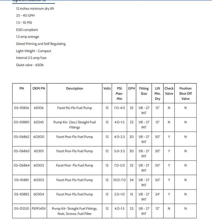

WHX?? 58,220 #11 Posted September 7, 2021 (edited) The only one I have used Mike was a cheapy like this on a neighbors CC ZT that I did a motor swap on. That was a couple of years ago and I still see him using it so it must be working yet. Wired it right to the bowl solenoid and ground. Guessing he has pushed at leas 50 gallons with it so far. The only other one I have on a worker is on the 520 I got from Denny Clarke. When you hit the key and the clicking noise slows you know she shot gas to the carb and she fires right up unlike my other 520s that lose their prime. Edited September 7, 2021 by WHX?? Share this post Link to post Share on other sites
pfrederi 21,181 #12 Posted September 7, 2021 2 hours ago, Mike'sHorseBarn said: What kind of electric pump do you use? Facet Posiflo I have used the 4psi and 2 psi about $39 Made in USA no failures I have 4 now...my $10 cheapie died after a few hours use. 2 Share this post Link to post Share on other sites
