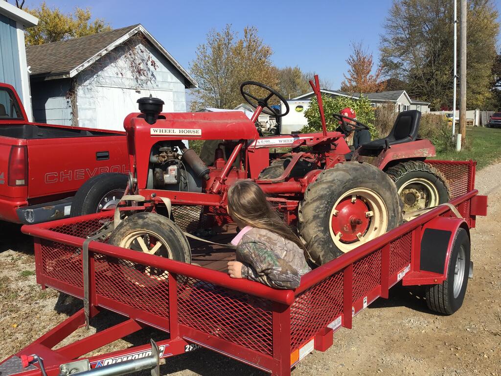

Pullstart 70,025 #5 Posted September 3, 2021 10 hours ago, 8ntruck said: @pullstart - I saw one of your pictures of a C-195 with a 3 point. Yours? You still got it? Sorry Bill, I’ve no 3 points in the stables… the only C195 ever close to my possession I just hauled with @Bow_Extreme when he helped find me Mrs. P’s Ride Away Senior. 2 Share this post Link to post Share on other sites
