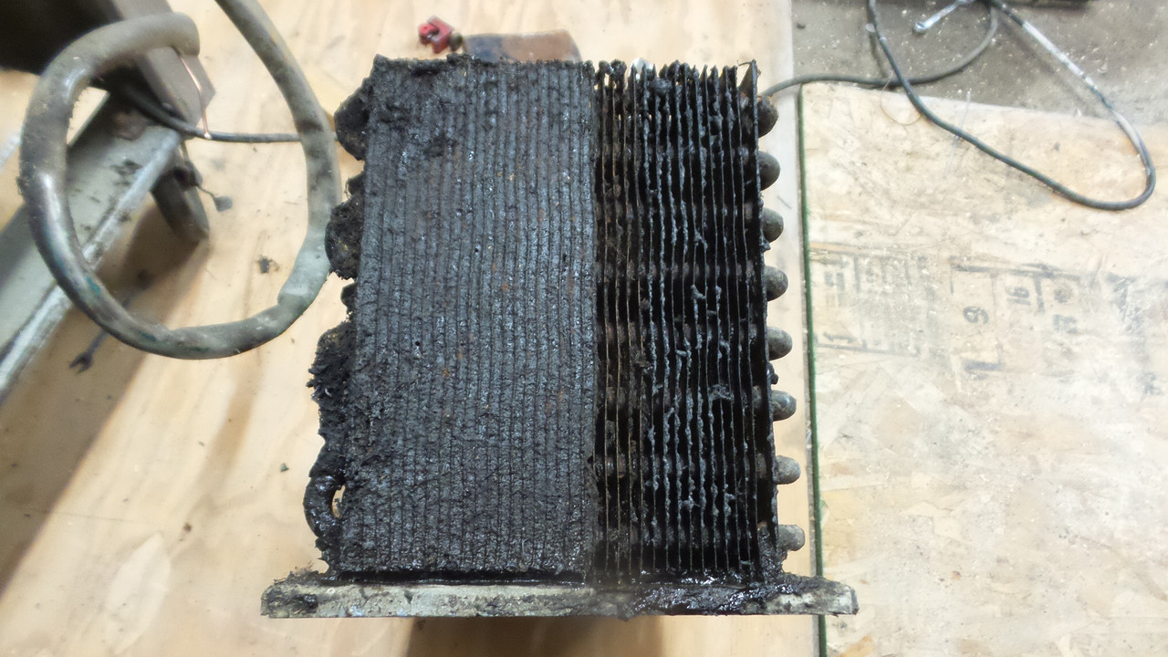

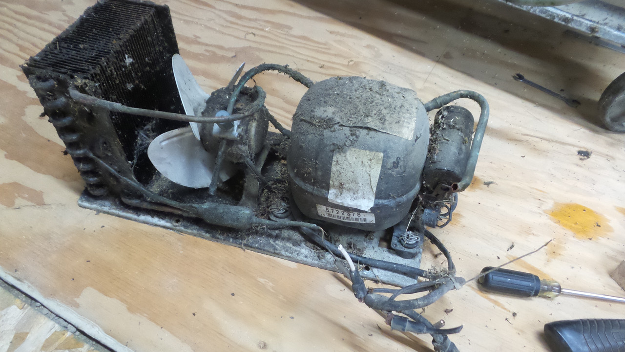

bc.gold 3,406 #1 Posted August 31, 2021 (edited) Local restaurant discarded a refrigerated preparation table, the pictures below do not require further explanation. Had they used dryer vent tubeing to bring in air from an outside source they could have gotten many more years of service from this table not to mentioned the savings on electricity. The soft ice cream machine was a treasure trove of goodies, two single phase 2 hp 1725 electric motors two 3/4 hp motors and a slew of magnetic start switches which came a tad late as I had recently purchased one for my air compressor at $90.00 Edited August 31, 2021 by bc.gold 1 1 Share this post Link to post Share on other sites
squonk 44,636 #2 Posted August 31, 2021 That's bad but I've seen a lot worse than that. No pictures but at the hospital I worked at they had a refer/freezer right next to the deep fryer. 2 compressors, 2 condensers and 2 fans on top. The night guys were supposed to PM this thing every month. It had stainless covers on the sides so you couldn't see it. I finally get called because the freezer wasn't working. Got on the ladder and if I wasn't a refrigeration guy I wouldn't have known what anything was up there. It was solidly covered with grease, fuzz and who knows what else. There was no way it was going to come off. Even Nu Brite was no match for it. I wanted to replace the entire condenser unit but a whole new refer/freezer was cheaper! 1 Share this post Link to post Share on other sites
bc.gold 3,406 #3 Posted August 31, 2021 (edited) 3 minutes ago, squonk said: That's bad but I've seen a lot worse than that. No pictures but at the hospital I worked at they had a refer/freezer right next to the deep fryer. 2 compressors, 2 condensers and 2 fans on top. The night guys were supposed to PM this thing every month. It had stainless covers on the sides so you couldn't see it. I finally get called because the freezer wasn't working. Got on the ladder and if I wasn't a refrigeration guy I wouldn't have known what anything was up there. It was solidly covered with grease, fuzz and who knows what else. There was no way it was going to come off. Even Nu Brite was no match for it. I wanted to replace the entire condenser unit but a whole new refer/freezer was cheaper! Hopefully they replaced it with a new unit equipped with a water cooled condenser. Edited August 31, 2021 by bc.gold Share this post Link to post Share on other sites
squonk 44,636 #4 Posted August 31, 2021 16 minutes ago, bc.gold said: Hopefully they replaced it with a new unit equipped with a water cooled condenser. No, but I built a filter enclosure for it and made sure the new unit was cleaned every month like it was supposed too. We had a lot of water cooled units throughout the hospital and management wanted to do away with that if all possible. Share this post Link to post Share on other sites
