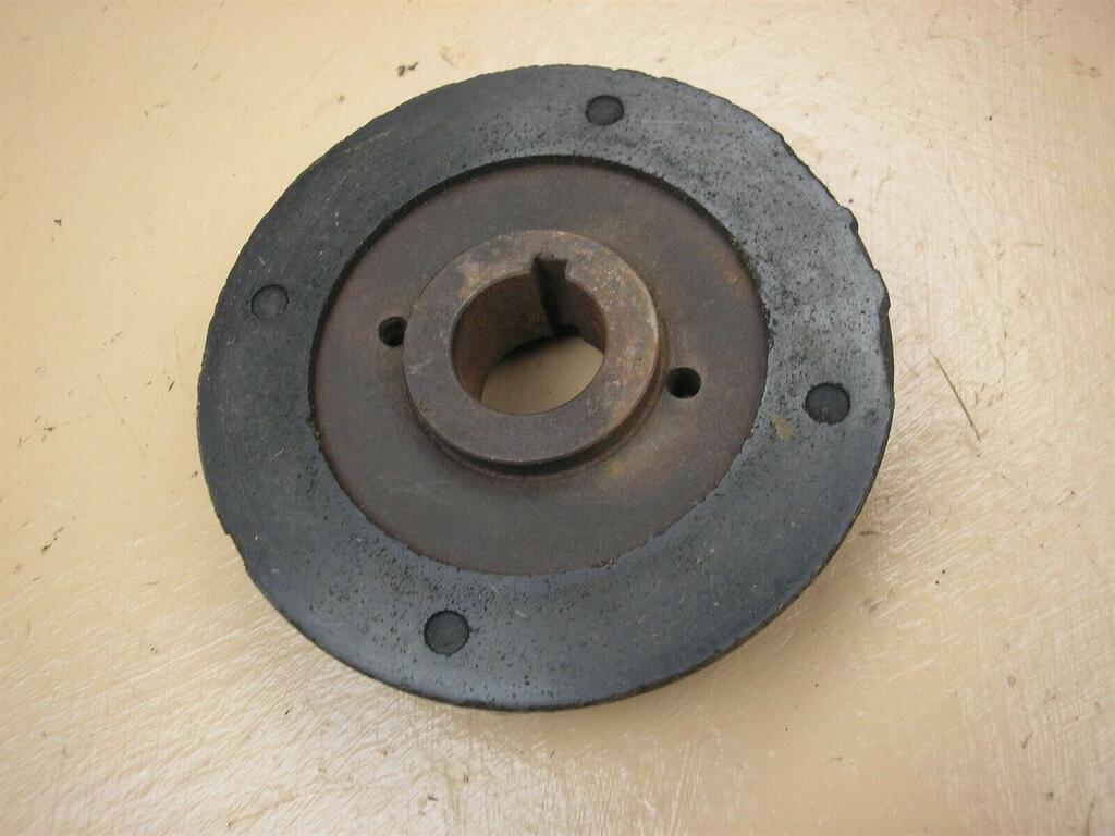

slufoot733 70 #1 Posted August 30, 2021 Does anyone have a recommendation for relining a Wheel Horse clutch plate? I have a D200 PTO clutch that needs a new lining. The one in the photo is not mine, just used for reference. Mine has several small chunks of friction material missing and some cracks. Any info would be greatly appreciated. Share this post Link to post Share on other sites

953 nut 69,148 #3 Posted August 30, 2021 Stens makes all different diameters and thickness of discs. Lincoln at A-Z Tractor parts is a Stens dealer, give him a call. https://a-ztractor.com/ https://www.google.com/search?q=stens+friction+discs&sxsrf=AOaemvLy_T46RKBbffstxqBPbSB5-yZ2Dg%3A1630322497677&ei=Qb8sYf_lKI-4tQbFvJXIBQ&oq=stens+friction+discs&gs_lcp=Cgdnd3Mtd2l6EAw6BwgAEEcQsANKBQg8EgExSgQIQRgBUPfeBFiU6QRgvvAFaAFwAHgAgAHFB4gB5g6SAQM2LTKYAQCgAQHIAQfAAQE&sclient=gws-wiz&ved=0ahUKEwi_it_K0NjyAhUPXM0KHUVeBVkQ4dUDCA8 Share this post Link to post Share on other sites

Goldnboy 1,154 #6 Posted August 30, 2021 If you have a farm supply store or farm equipment dealer nearby you can use pto slip clutch disc's and adhere to the old metal plate by jb weld. The slip clutch plate diameter I obtained was 7" and I trimmed it down. Note: the material will move easily when jb weld is not dry, if you look closely you can see what happens if not careful Share this post Link to post Share on other sites
