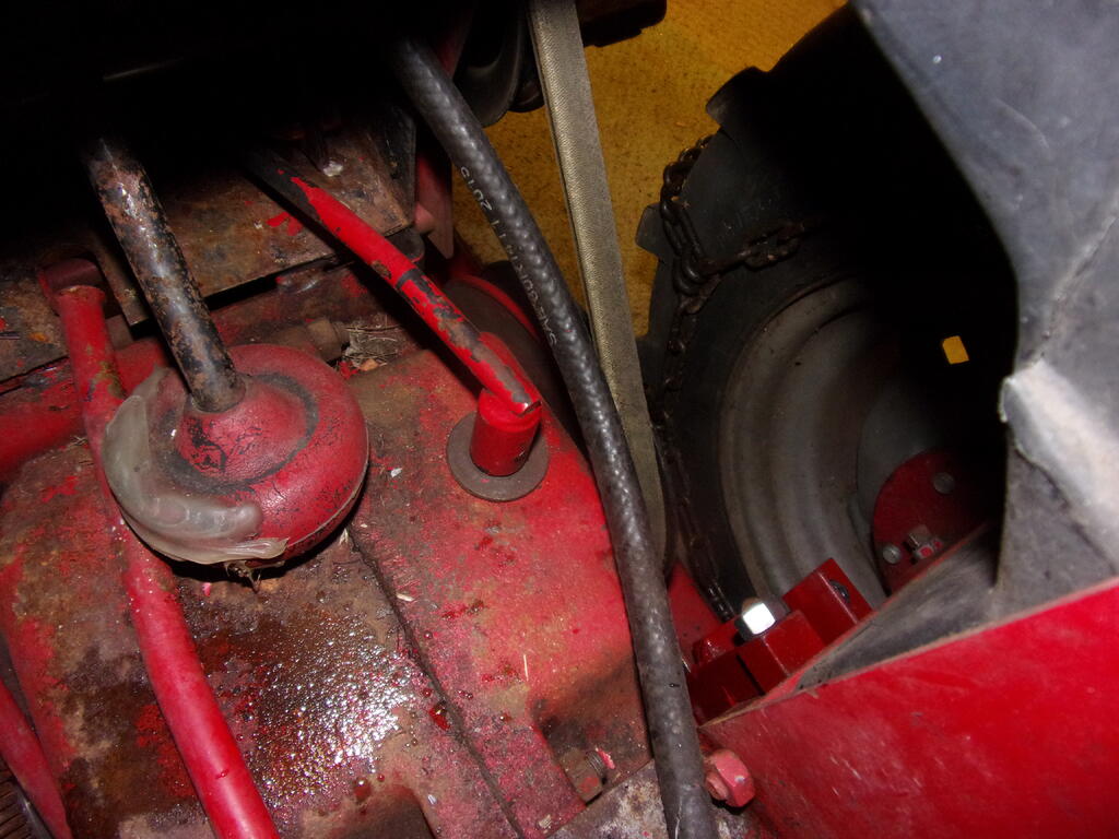

Ed Kennell 43,783 #6 Posted August 27, 2021 (edited) 38 minutes ago, stevasaurus said: Hey @Ed Kennell do you know which ones you had to do that with ?? I have not heard of that before, and I wonder if it just was not an issue inside the transmission. The one was the 312-8 that I recently rigged for a snow plow and gave to my son. The tranny seemed to function fine, but there was about a 1/8" vertical play in the hi/lo shifter shaft and you had to lift it to be able to shift. I actually remover the shift lever and installed a spacer under the lever to keep the shaft in the up position. Now it shifts easily. The other 8 speed that did this same thing was too many moons ago and has long since been deleted from my memory data bank. I am not familiar with the innards of these trannys like you so I don't have a clue why or how this can happen. Does it make cents to you? or scents or sense? You can see the spacer under the hi/lo shifter. And that boot repair was by the PO ...not me. Edited August 27, 2021 by Ed Kennell 4 1 Share this post Link to post Share on other sites
stevasaurus 23,515 #7 Posted August 27, 2021 Yes, it makes since to me. You just took the slack out of that shifter for up and down. Not a bad idea if that is what is happening, but by lifting the shifter a little, you made the shifter work easier because it was more in line with what that shifter does. Watch this and see if seeing how that shifter works doesn't explain what adding that washer did. The thing to see, is that the shift lever moves that fork up and down by turning it from one side to the other. your washer took out the slack. @Racinbob did the same thing with the input shaft on 3 speed transmissions to try to take the slop out of 3rd gear popping out of gear. 3 1 Share this post Link to post Share on other sites
