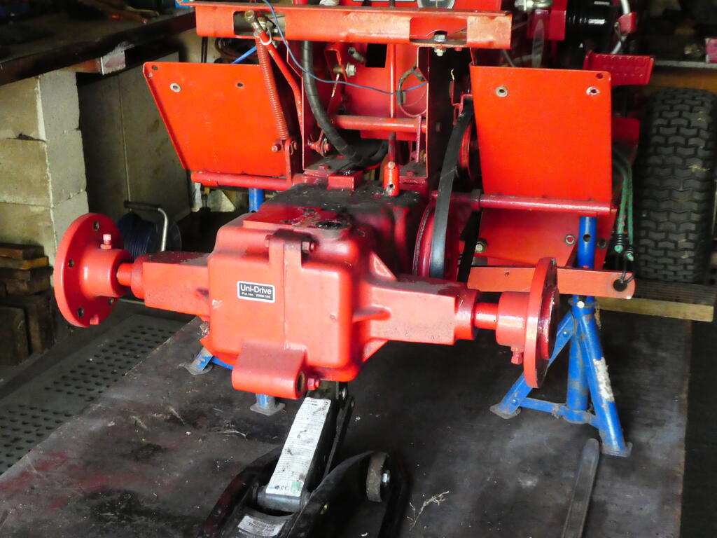

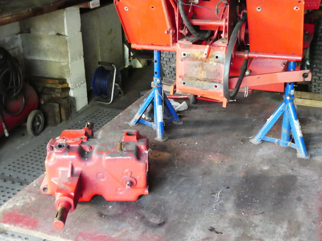

Stormin 9,986 #1 Posted August 27, 2021 My C-81 which I use with a finger bar, has decided not to engage low box. Had a chat with our resident trans guru, Stevasaurus, and Squonk. The general consensus was a broken selector fork. Today I decided to remove the trans. I'd already removed the finger bar. This morning front end was jacked up left for the oil to drain. This afternoon started on removing the trans. Progress at end of play. I was pleased to find the hubs slid of easily with a little light help from a three legged puller. The drive pulley like wise. When the hubs had been fitted, the shafts had had a smear of oil. The trans is now propped up on end to drain any oil left in. I'm not going to give a blow by blow account, as a full rebuild is already cover by Stevasaurus in tutorials. 4 Share this post Link to post Share on other sites

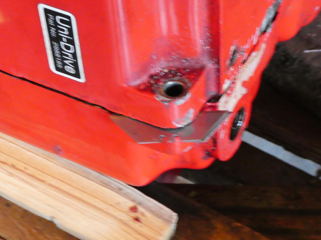

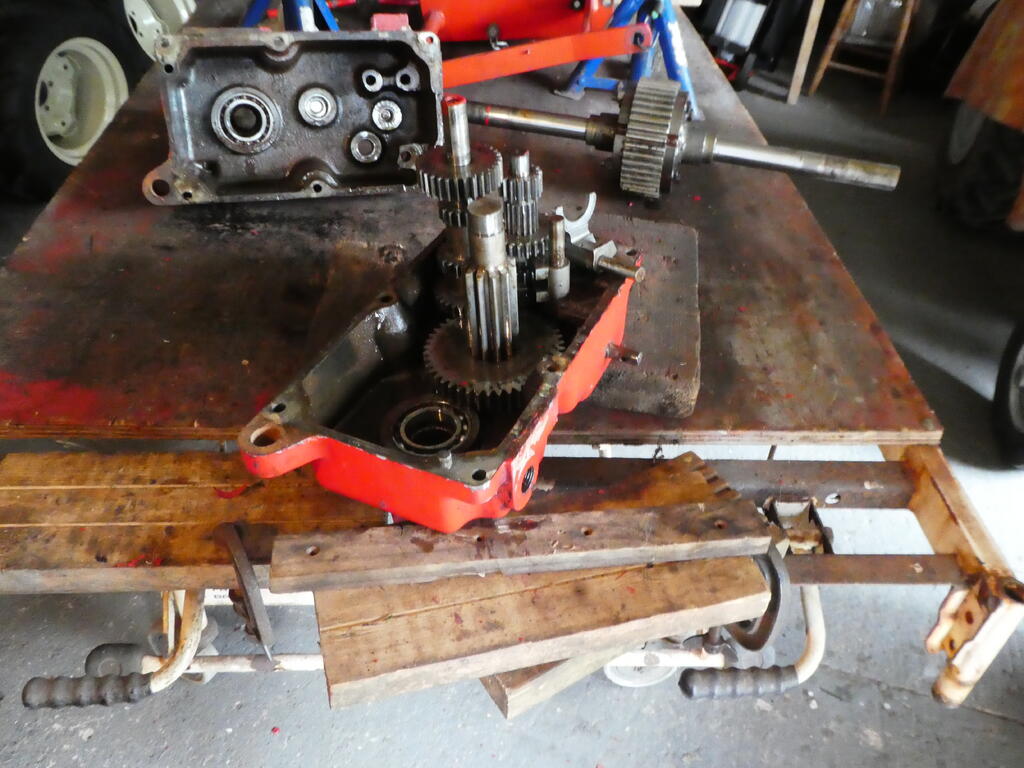

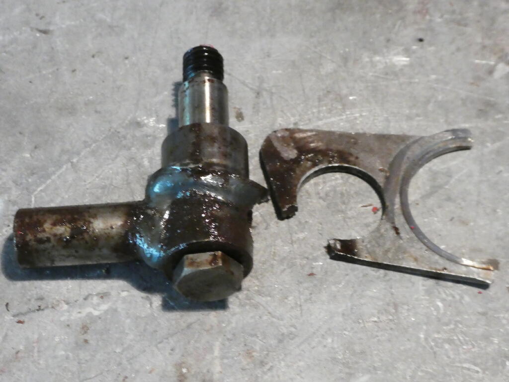

Stormin 9,986 #12 Posted August 30, 2021 Got it apart this morning. Used some Stanley blades to break the seal. Then a couple of screwdrivers to open it up a bit more then two large chisels. Here's what I found. Only welded on one side and the weld hadn't taken hold. Only on were you can see the missing piece. If I can't get one from the Toro dealer I may get a mate to weld it up. 2 3 Share this post Link to post Share on other sites
ebinmaine 75,751 #13 Posted August 30, 2021 14 minutes ago, Stormin said: weld it up IF the part isn't excessively worn, and IF you can get it cleaned up, degreased, and sitting straight I'd go ahead and weld it instead of replace it. 1 Share this post Link to post Share on other sites
71_Bronco 1,072 #14 Posted August 30, 2021 I'm sure I don't have to tell you, but wouldn't be a bad idea to check everything else inside the trans while you got it open. Glad you found the problem part. Nice when its blatantly obvious so you aren't pulling our hair out figuring out what's wrong. 2 Share this post Link to post Share on other sites
squonk 44,860 #15 Posted August 30, 2021 If that fork was completely broken off nORMSTER ,it's a good thing you didn't drive the tractor around anymore! 2 1 Share this post Link to post Share on other sites
WHX?? 53,331 #16 Posted August 30, 2021 42 minutes ago, ebinmaine said: sitting straight I'd go ahead and weld it instead of replace it. Not with my welding skills tho! That one end does look bent and worn tho so maybe not a bad idea to look for a replacement? 2 1 Share this post Link to post Share on other sites
Stormin 9,986 #17 Posted August 30, 2021 The fork itself is/was slightly bent. If I do get it welded I won't be doing it. Mig would be the best way and I don't posses one. I now have the part number thanks to Squonk, so off to Carlisle in the morning and hope I'll be lucky. Rest of the box is clean and in good condition. 1 1 1 Share this post Link to post Share on other sites
Stormin 9,986 #18 Posted August 31, 2021 Quote from Toro this morning. £90. It's now with an ex-workmate of mine to weld. He's very good with small stuff and cheap. He doesn't charge me. 2 1 Share this post Link to post Share on other sites
