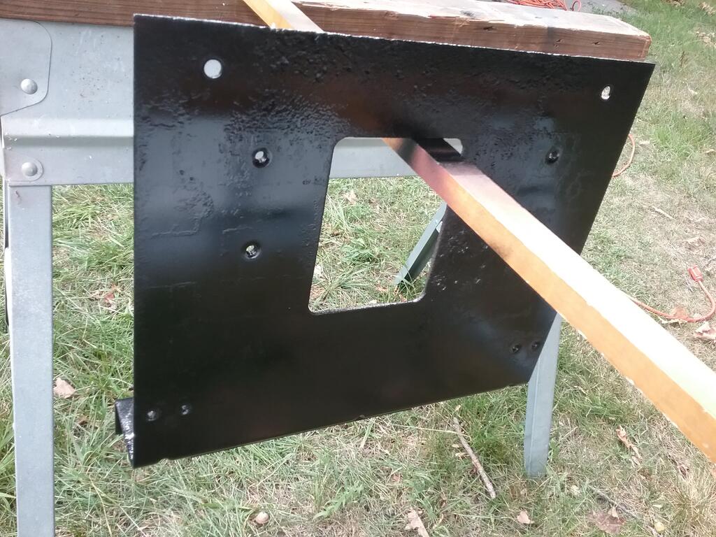

8ntruck 9,293 #27 Posted September 6, 2021 (edited) Did some crud removal on the seat bracket: Kind of quick and dirty - wire brush on the angle grinder, Rustoleum Rusty Metal Primer, then Rustoleum XX Saten black. Soaked the gas tank with vinegar, then agitated with nuts & bolts, drained, and rinsed with water. Set out in the sun to dry. Got it all back together today - new electric fuel pump, quick clean on the carb, new set of plugs, new fuel lines and filter. It is not starting as easily as it was, but runs OK. The carb is not quite right. Really rich at idle and stumbles on throttle up. Once up to speed, the governor is keeping the RPM steady. Matt installed an I Save Tractors carb on it to get it running. The choke lever does not match up with the choke cable, so that might be part of the start up issue. I have the in line filter ahead of the fuel filter, mounted horizontally. That might be interfering with the fuel flow to the pump. I'll try moving the filter back to the shut off valve at the fuel pump. Driving around my property for a bit, I found that the cleaning and lubrication of the motion control linkage has restored the full range of speed, and the brake pedal is working as it should. This is the first hydrostatic tractor I've driven. Moving the motion control lever to make the tractor go takes a little getting used to. I have not done the 'put it against something solid and see if it spins the wheels' test yet. Maybe tomorrow? Still have wiring to sort, have another look at the carb, engine cooling fins to clean, transmission oil and filter to change, PTO clutch to fix, a mid mount to find pieces for, and finding out why the clutch linkage on the main drive belt does not lock in the off position. Looks like there will be a little wood hauling work to do tomorrow to get some run time under a light load. I also shuffled the shed a little to be able to fit the C-195 in with the 14-8. It rained tonight. This is the first time in almost 20 years that the C-195 had shelter from it. I pointed out to my wife that a new seat is in the neighborhood of $100 and that if she could could stitch up a new cover, we would save a bit of money. She didn't bite, since she has her own projects to work on and her sewing time is worth more to her than the cost of a new seat. Edited September 6, 2021 by 8ntruck 1 Share this post Link to post Share on other sites

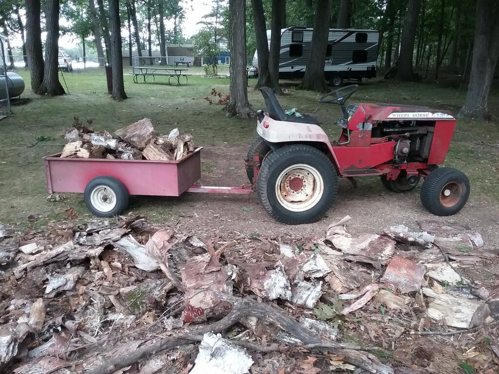

8ntruck 9,293 #38 Posted September 8, 2021 (edited) Gave the C-195 a light trailer workout hauling some wood to the neighbor's across the street. There is a pretty good grade going down to the lakefront lawn. Was interesting learning about how the brake and hydro interact there. No problem going up the hill with the motion control at the forward stop. The engine got into the governor a little bit there. I sure like the exhaust note of the KT19. The tractor started much easier today than a couple days ago. Still having issues with the chole. I have it disconnected from the choke cable, and am using it manually. It feels like there is a ball detent or something on the choke shaft to keep it in the off position. Probably going to end up making up a secondary lever that will be friendly with the choke cable and bolt it on on to the lever on the choke shaft. Does anybody have a picture of an original choke linkage on a KT 19? I imagine that the KT 17 would have the same choke linkage set up. Still rich at idle, and I need to take another pass at the main jet needle, as I think it is rich there as well. I added air the other day to the left front tire. The part of the tire that was flat while the tractor was sitting for years (decades?) was not on the bottom when I parked the tractor. The tire is still leaking, but it was not all the way down after a couple of days. Last week when the tractor was parked with the old flat spot down, that tire would leak all the way down over night. Anybody think it needs a name? I'm open for ideas. Edited September 8, 2021 by 8ntruck 1 Share this post Link to post Share on other sites
