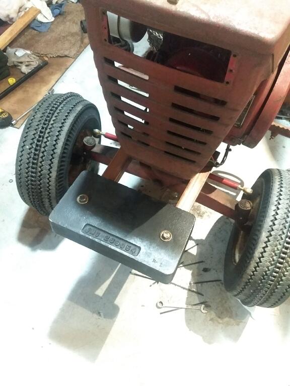

71_Bronco 1,073 #1 Posted August 21, 2021 Have a stack of rectangle plates from an old work out machine, and just picked up a pair of old York 25 lb plates for a dumbell. Curious how you guys are attaching them, and for what reason. Pulling is the first thing that comes to mind, but I'm sure there's other reasons, traction maybe, or for ground engaging. Also seen them on the back if I recall correctly to counter-ballance a FEL. 1 Share this post Link to post Share on other sites

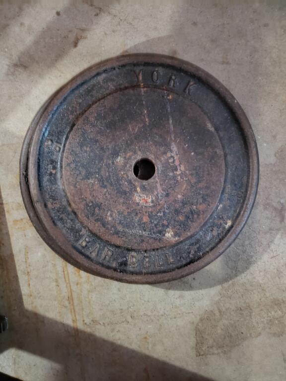

71_Bronco 1,073 #2 Posted August 21, 2021 Here's a pic of the York plates I got today, for a low low price of... free 1 Share this post Link to post Share on other sites

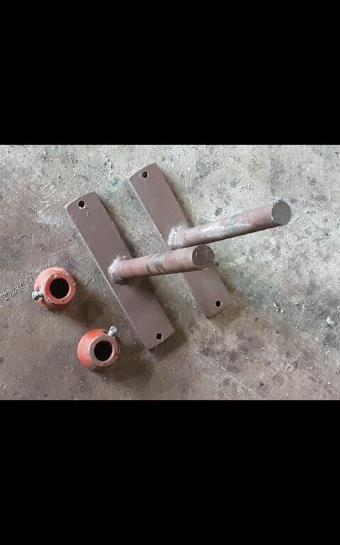

over60pirate 24 #3 Posted August 21, 2021 3 hours ago, 71_Bronco said: Have a stack of rectangle plates from an old work out machine, and just picked up a pair of old York 25 lb plates for a dumbell. Curious how you guys are attaching them, and for what reason. Pulling is the first thing that comes to mind, but I'm sure there's other reasons, traction maybe, or for ground engaging. Also seen them on the back if I recall correctly to counter-ballance a FEL. I made these for my tractor. Put smaller plastic coated weights on first, that just fit in rim, then 50# plates on outside. 80# total. Have extra set, I'd sell for $10. Plus shiping 1 Share this post Link to post Share on other sites

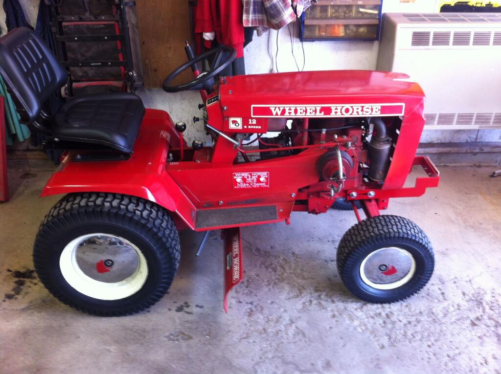

JAinVA 4,638 #5 Posted August 22, 2021 (edited) Added 100 lbs to the sub frame Edited August 22, 2021 by JAinVA 1 Share this post Link to post Share on other sites

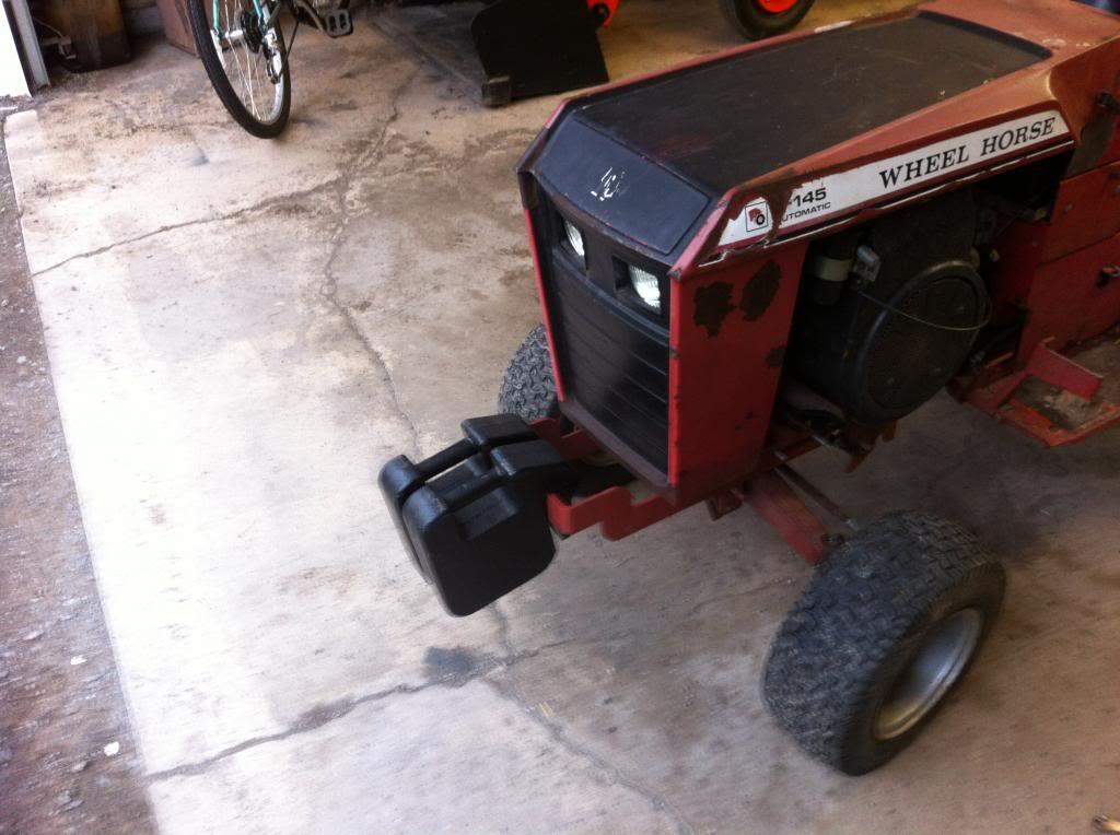

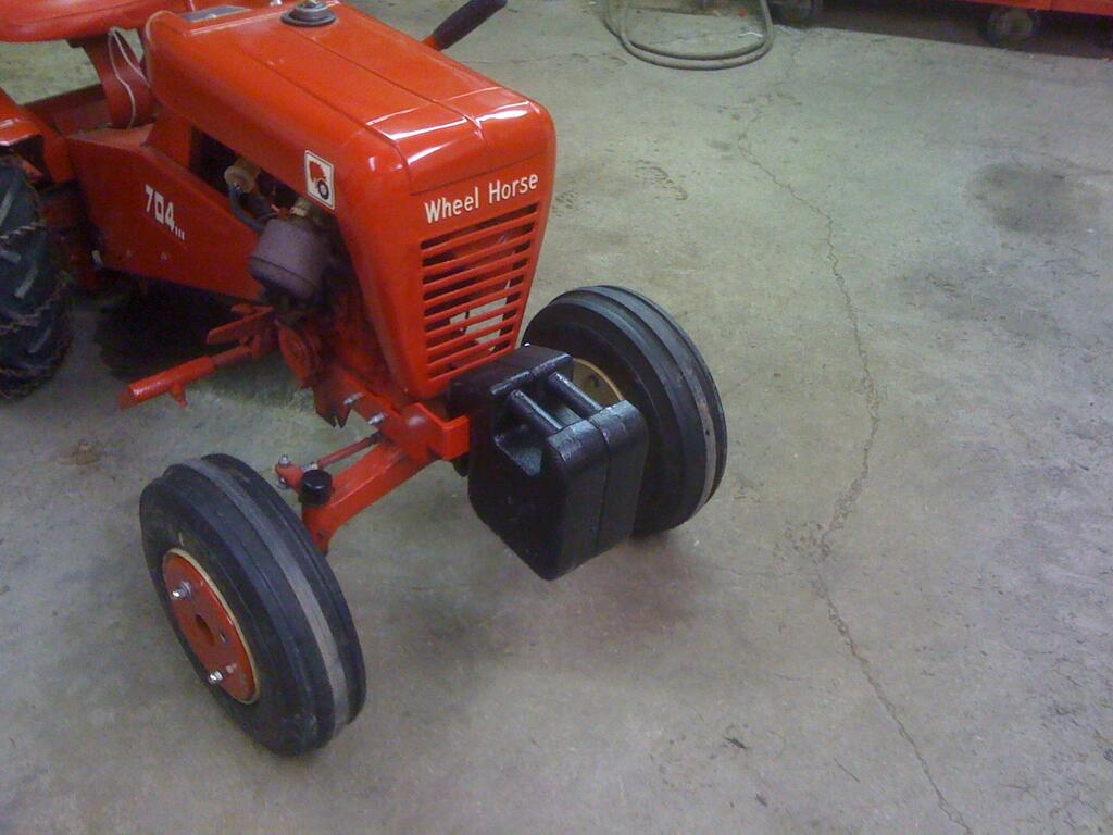

Ed Kennell 47,600 #6 Posted August 22, 2021 1 hour ago, 953 nut said: I know @Ed Kennell has some pictures of his weight attachment for added traction. 5 1 Share this post Link to post Share on other sites
Ed Kennell 47,600 #7 Posted August 22, 2021 The front weight. 5 1 Share this post Link to post Share on other sites

ebinmaine 80,940 #13 Posted August 22, 2021 1 hour ago, Ed Kennell said: For best traction on workers add weight in this order. 1. filled tires 2. wheel weights 3. tractor mounted weights Agreed. I'm a big proponent of filled tires because ALL the fluid weight pushes down literally pinching the tires right to the ground. Also handy is the fact that a properly filled and installed tire doesn't need air pressure. I've had the same tires and rims on at least 4 different tractors over 4 years and never added air or had (even the capability) of a flat. Here's a pic of the front weight on Trina's 867 Pigpen. It helped ALOT for her steering on our hilly terrain. 1 Share this post Link to post Share on other sites
