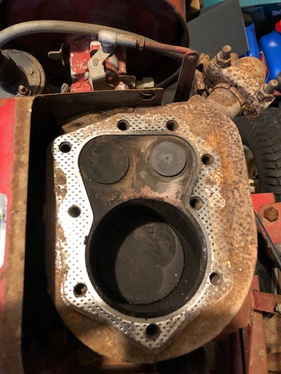

OutdoorEnvy 1,810 #22 Posted August 16, 2021 I pulled the head and the piston is not moving. It was at the top and it had no rattle or anything. I pushed it down some and it felt really smooth. The cylinder walls look clean. my guess is probably a broke connecting rod. The camshaft seems good as both valves worked fine. So this project will slow up a bit. I'll probably start a new thread when I get around to it. Head looked pretty clean though of carbon, etc. Wasn't really any build up. 1 Share this post Link to post Share on other sites
