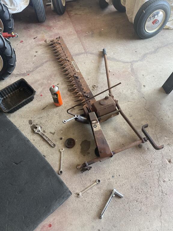

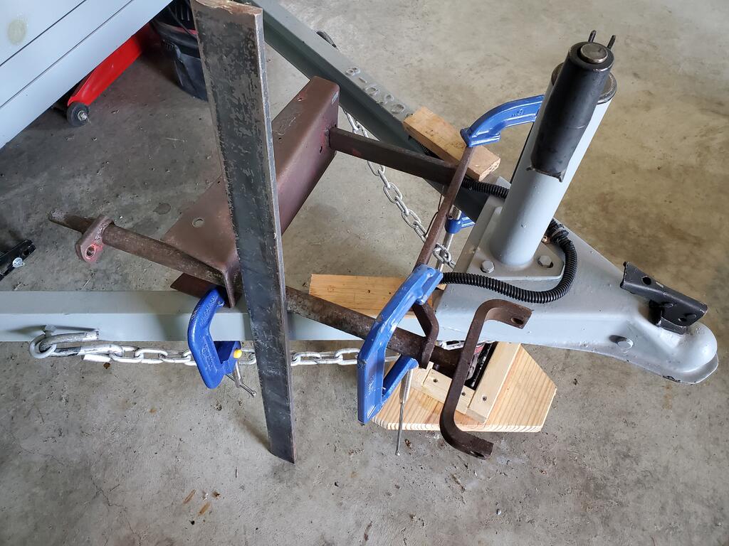

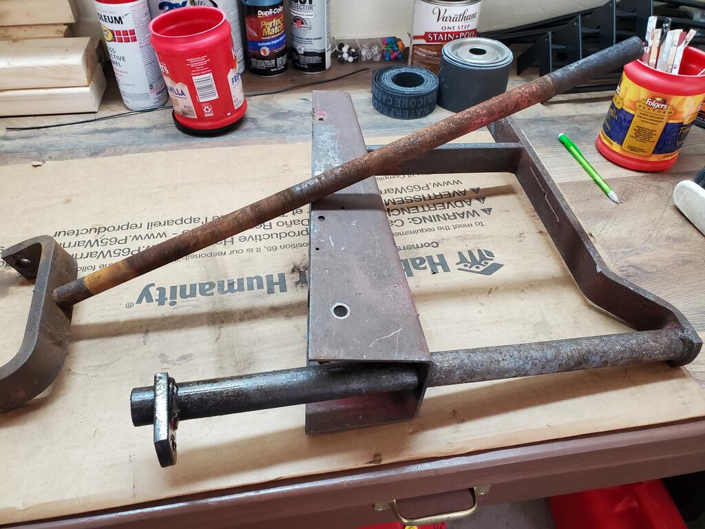

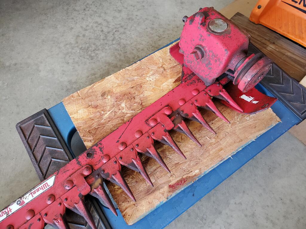

Racinbob 13,290 #31 Posted September 24, 2021 3 hours ago, WHX?? said: Nice save tho Mine came in a basket! I kinda think that may have been a good thing Jim. I just had a good thing happen. I rigged up the frame and yoke like this: Using that piece of bar stock I was able to turn the yoke. Now I need to be patient and let the go juice do it's thing for a few days or?? 3 1 Share this post Link to post Share on other sites
Handy Don 17,735 #32 Posted September 24, 2021 23 minutes ago, Racinbob said: was able to turn the yoke Progress! 2 Share this post Link to post Share on other sites
WHX?? 58,387 #33 Posted September 24, 2021 Yep just getting it to move just a little is huge! 2 Share this post Link to post Share on other sites
Racinbob 13,290 #34 Posted September 24, 2021 1 hour ago, WHX?? said: Yep just getting it to move just a little is huge! You bet it was. I also got the lift handle off. I didn't want to force it cuz I wasn't certain something else was holding it but Lane confirmed that there wasn't so I got intimate with it. All in all it was a productive day but it did have an 'oh crap!' moment. After I got things tidied up I decided I wanted to take a golf cart ride out back. I had used the battery on it to 'fire up' my automatic charger on the e-tank. The solenoid clicked once and that was it. It didn't take much detective work to determine that the charger took a dump. I had to order the one I wanted so my e-tank will be down a few days. In the morning I'll ask one of my trusty to offer up a jump and I'll cruise around to get it charged back up. Share this post Link to post Share on other sites

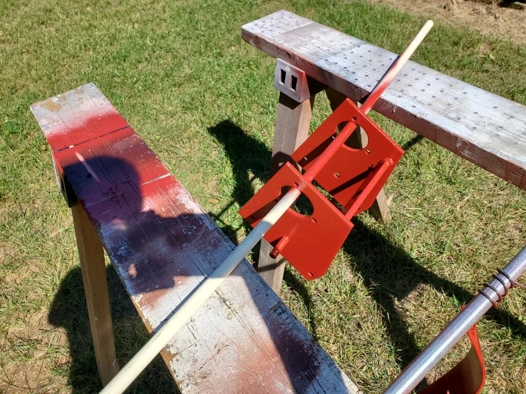

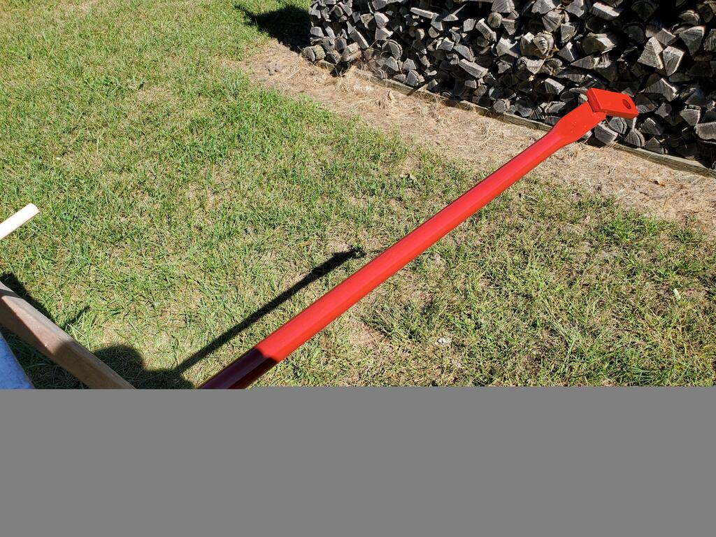

Racinbob 13,290 #36 Posted September 26, 2021 Another good day fighting rust. I got the lift bar and frame primed and painted. The new shaft, pulleys and bearings are supposed to be here tomorrow but I won't be able to work on it until at least Tuesday. I forgot about the idler pulleys. Even though I could pick them up locally I went ahead and ordered a couple. Here's the bestest news. I've been soaking the bar and tube the beat I could. I decided to turn it again and it was definitely easier. I re-rigged it on the trailer frame so I could twist and pull at the same time. IT WAS SLOWLY COMING OUT! Once I got the end of us inside the pipe I handed my wife a steel rod and hammer and told her to just start hitting it. That helped and before I knew it I was holding it in my hand. I don't have the main pully off yet but I don't think it's going to fight me much more. I'm not going to do much to the wobble box and bar. I'll pull the knives off and clean them up and check the drive pin for wear. Normally when I attack a project I horribly under estimate the issues and headaches I'll run in to. I think I over estimated this one. 2 3 Share this post Link to post Share on other sites
Lane Ranger 12,167 #37 Posted September 26, 2021 I used a pickle fork behind the big cast pulley to slowly move it off the shaft. 1 Share this post Link to post Share on other sites

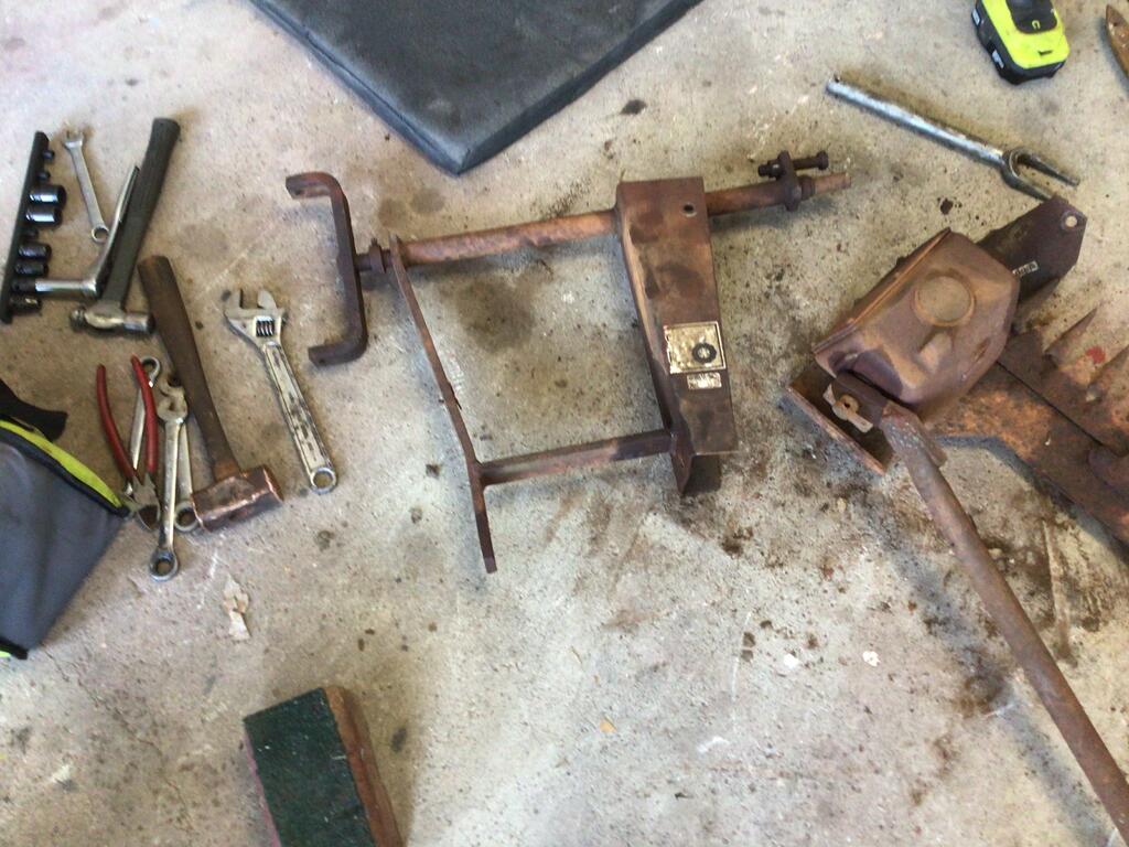

Racinbob 13,290 #38 Posted September 29, 2021 As I mentioned in post 34 my battery charger took a dump. I ordered one that I found on Menards site that has a manual setting. The only store that had them in stock was in Loveland, OH so I ordered one. A few hours later I received an email stating that it was no longer available and they would issue me a credit. I immediately went to Harbor Freight and picked up a cheapie so I could continue. The next day I got an update from Menards stating my order has shipped . I followed the tracking and it arrived on time yesterday. Something was fishy as the box was only about 2" x 3". I opened it up and found this tasty treat. Now why would anybody order a 6.5 oz can of clams? From Menards Oh well. The Surplus Center order came yesterday. It was actually correct allowing me to do this today. I need to get a 59" belt and some 3/16" keys which I'll do locally. I'm just about set to bring the 854 into the garage and bolting things up. 1 1 1 Share this post Link to post Share on other sites

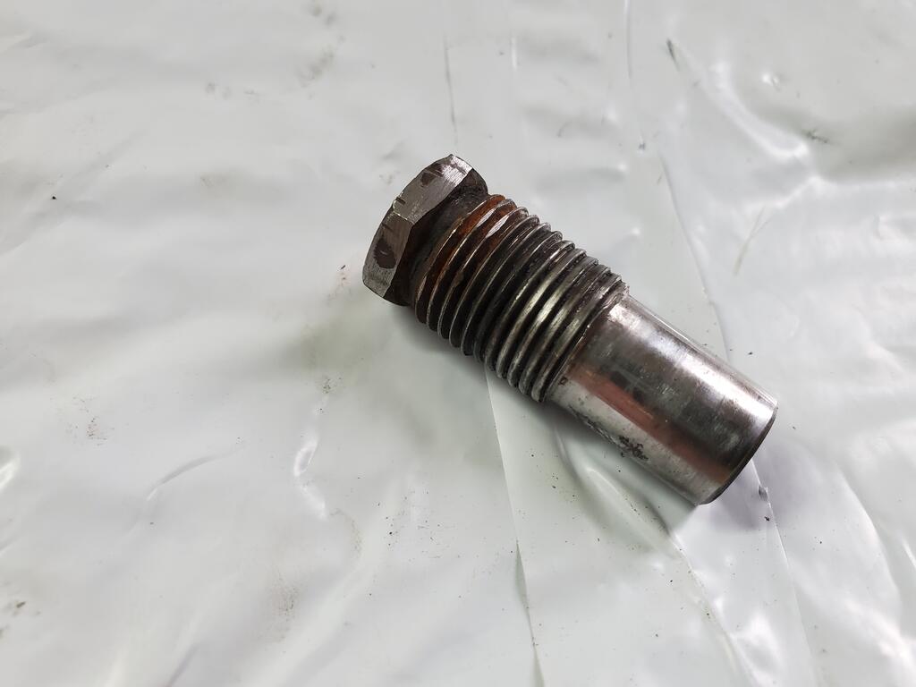

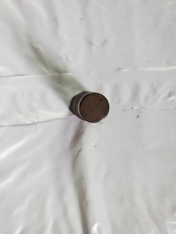

Racinbob 13,290 #39 Posted October 7, 2021 Been away from this project a few days doing get ready for winter things and hauling the wife back and forth to South Bend. She had cataract surgery on her second eye this morning. I checked out the pivot pin for wear and there absolutely none. I really don't think this thing was run much. It's like the previous owner bought it, did a couple jobs and set it in the weeds. I do need to clean up the threads so I have a 5/8"-18 tap and die coming. There was no jam nut so I have a batch of them coming. This is the first 5/8"-18 jam nut I've needed and most likely the last. When it comes to hardware why am I always compelled to order a batch of them instead of just what I need? Share this post Link to post Share on other sites

Racinbob 13,290 #41 Posted October 14, 2021 Ran into another issue this morning. The end threads on the mower drive pin are too worn. If you look back at post #39 you can see it. I ran a 5/8"-18 die on it to clean up the threads and I thought it would be OK but it just won't hold unless I run the threads in to the end. Time to contact Lane and hopefully he still has some that he posted for sale. My fingers are crossed that the female threads are OK. PM sent to you @Lane Ranger 1 Share this post Link to post Share on other sites

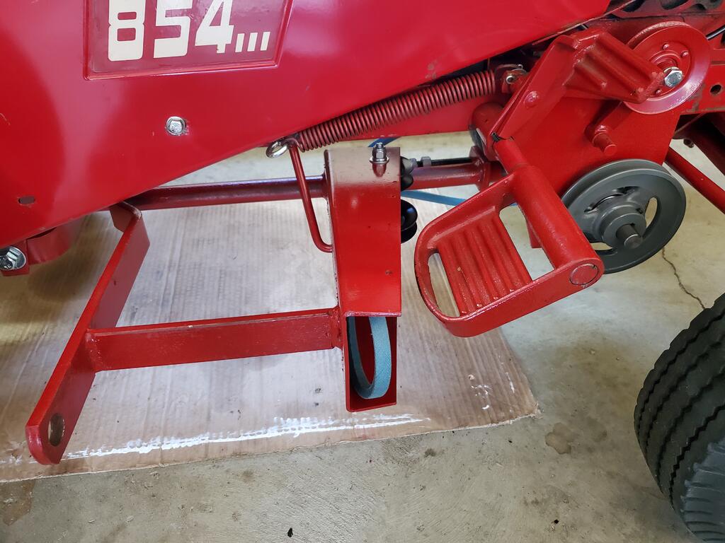

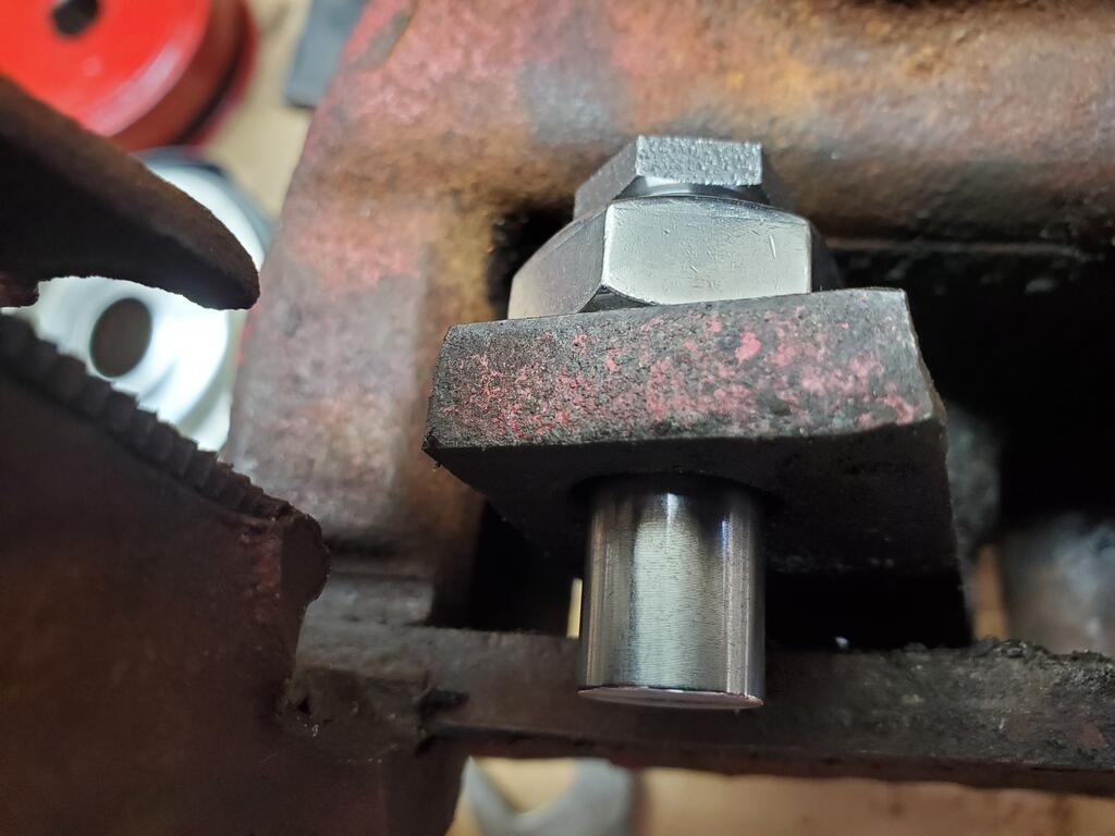

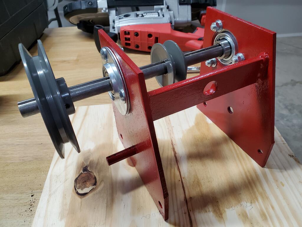

Racinbob 13,290 #42 Posted October 19, 2021 I receiver the new drive pin from @Lane Ranger this morning. I had fears that the female threads might be buggered some but that wasn't the case. The new pin threads in smoothly and snugs up nicely. For those of you who have a sickle bar I could see where having one of these on the shelf might be a good idea. I got this mounted under the 854. I thought I was going to have to take a grinder the the yoke where is bolts to the back of the frame. I installed a reinforcing plate mounting the frame to the transmission back when I got the tractor. If it would have been even a 16th thicker the holes wouldn't have lined up. It should be smooth sailing here on. I'll have to get a drive belt. Supposedly it's a 6573 which is 38" but I'm not certain the lower pulley is the stock diameter. Getting close! 2 2 Share this post Link to post Share on other sites

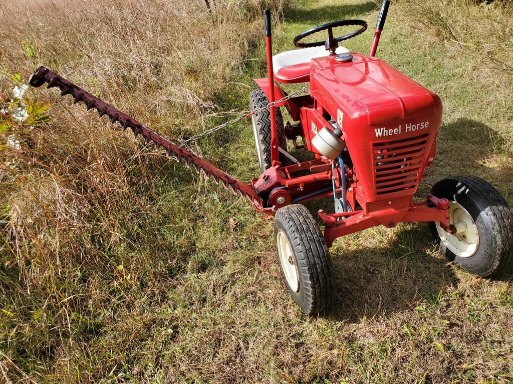

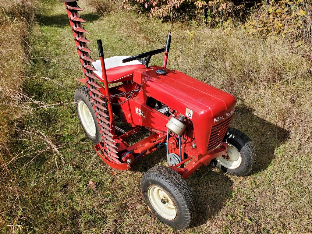

Racinbob 13,290 #43 Posted October 26, 2021 I'm happier than a squirrel in a nut house. She's all done and I took her on a maiden voyage. It actually seems quieter and smoother than the one I had over 20 years ago. The majority of the time I'll have it held to about a 45° angle as I trim back the overhanging briars on the paths. One last thing is I'll keep a lookout for a wheel weight. It could use one on the left rear especially when it's held in suspension. 4 Share this post Link to post Share on other sites

Pullstart 71,561 #47 Posted May 20, 2024 @Racinbob thanks for sending me this! I have a question. Likely more than one! Is the 3/8” rod in the picture below hooked to the lift link? That makes the entire unit pivot on the 3/4” rod at centerline of the tractor? On 10/26/2021 at 1:05 PM, Racinbob said: On 10/19/2021 at 1:14 PM, Racinbob said: Share this post Link to post Share on other sites
Pullstart 71,561 #48 Posted May 20, 2024 On 10/26/2021 at 1:05 PM, Racinbob said: If there is a lift rod attached under the rock shaft quadrant, what is the long bar with the handle for? I see that it is near vertical in both pictures above. Share this post Link to post Share on other sites
Racinbob 13,290 #49 Posted May 20, 2024 (edited) 17 minutes ago, Pullstart said: If there is a lift rod attached under the rock shaft quadrant, what is the long bar with the handle for? I see that it is near vertical in both pictures above. The lift lever on the tractor doesn't raise the cutters. I've always assumed the lift bar on the right was to lift the cutters over low obstacles. At least that's what I use it for. Edited May 20, 2024 by Racinbob Share this post Link to post Share on other sites
Racinbob 13,290 #50 Posted May 20, 2024 24 minutes ago, Pullstart said: @Racinbob thanks for sending me this! I have a question. Likely more than one! Is the 3/8” rod in the picture below hooked to the lift link? That makes the entire unit pivot on the 3/4” rod at centerline of the tractor? That is correct but it doesn't lift the cutters. You can see where that pivot and why the tractors lift arm won't raise them. Share this post Link to post Share on other sites
