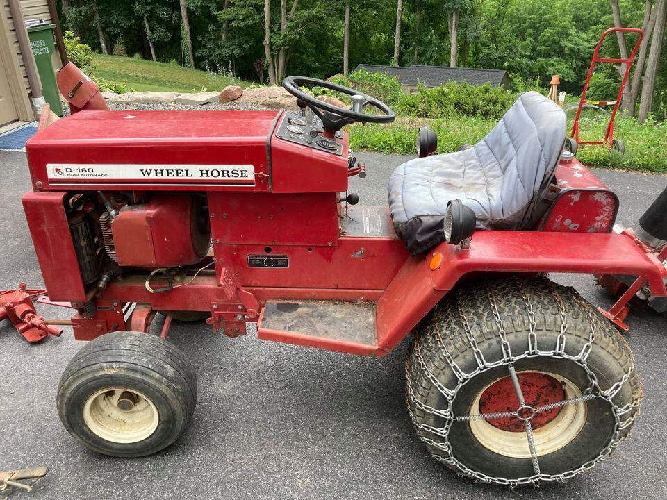

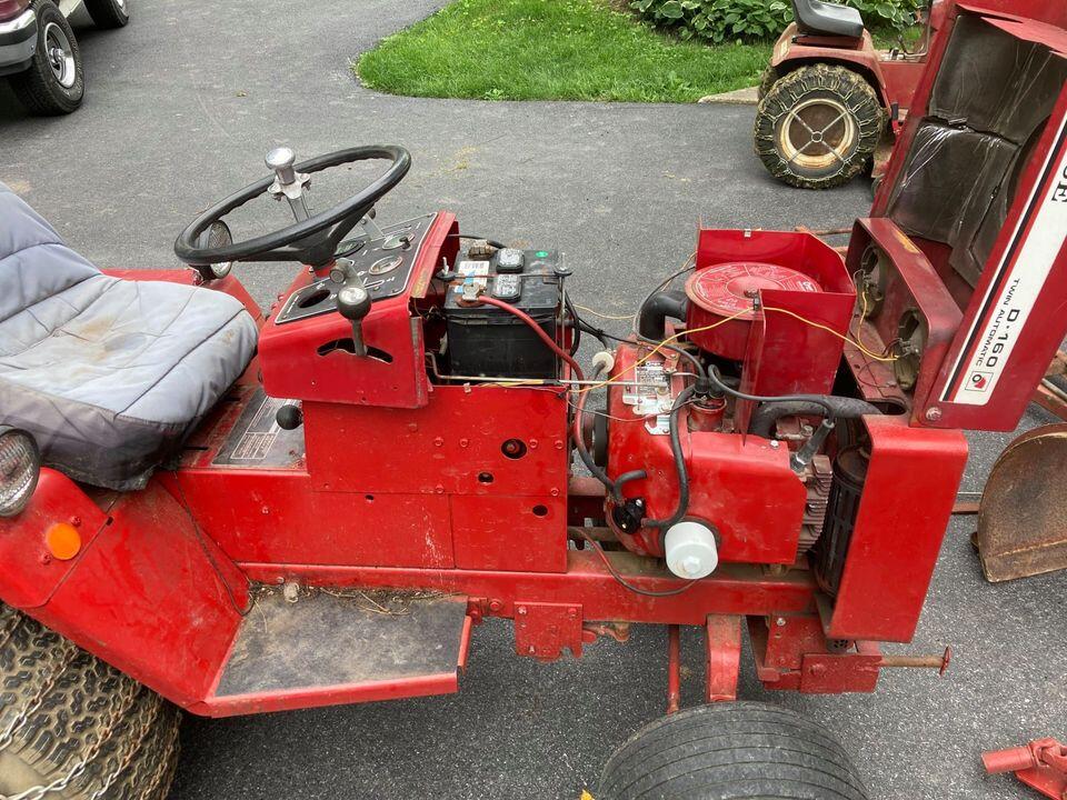

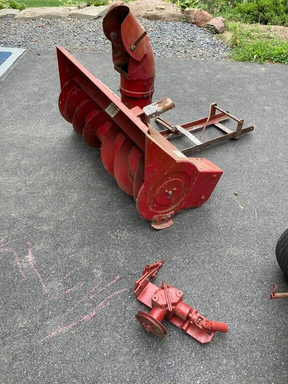

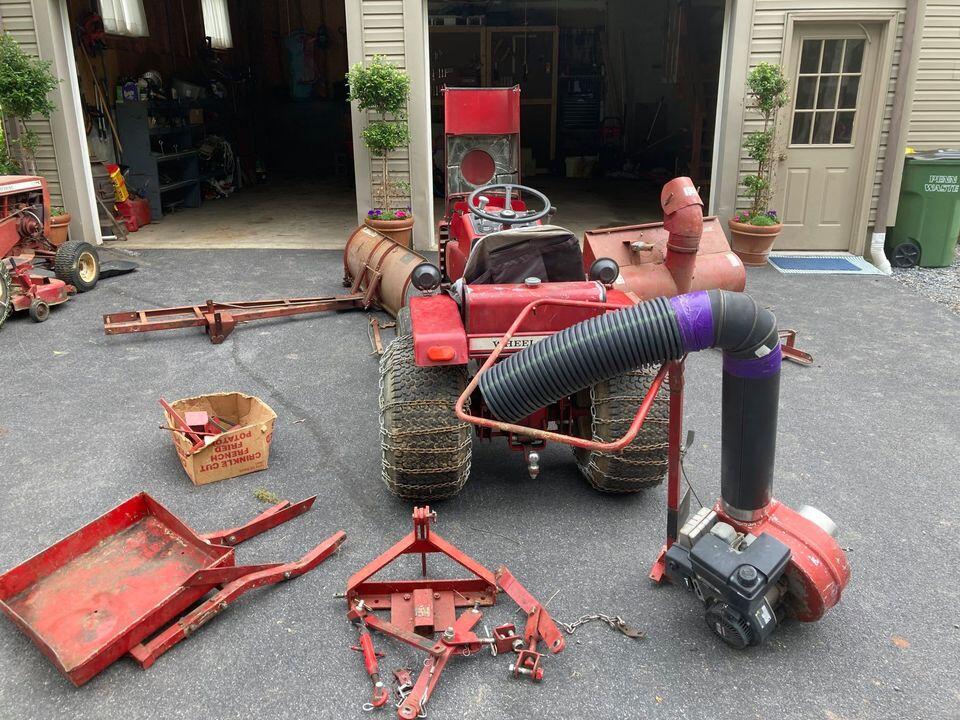

FANY 8 #22 Posted August 14, 2021 This is the one offered 1 Share this post Link to post Share on other sites
pacer 3,180 #23 Posted August 14, 2021 WOW!! thats impressive!! If you can get that at a reasonable price....... Bit high on hrs, but based on what I see the owner/s have taken care of it in which case (if so) then the hrs dont mean so much. SO MANY of the horses we find are a mess of being outside, parts missing, cobbled wiring, etc, and that one looks pretty 'undisturbed?' Share this post Link to post Share on other sites

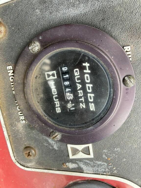

WheelHorse520H 710 #24 Posted August 14, 2021 (edited) 7 minutes ago, pacer said: Bit high on hrs, 184.6 hours is high for that thing? Edited August 14, 2021 by WheelHorse520H Share this post Link to post Share on other sites
clueless 3,403 #25 Posted August 14, 2021 (edited) So the guy selling it said if he didn't get his asking price he would leave it in the garage, then he dropped the price $500 dollars. It looks like about a 450 mile round trip for you so offer him $3100 for it, that seem like a fair price for it with everything that comes with it especially if it really has less the 200 hr on it. Edited August 14, 2021 by clueless Share this post Link to post Share on other sites
