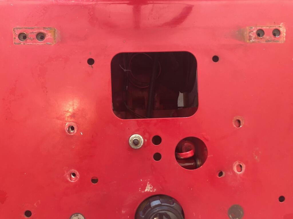

OutdoorEnvy 1,817 #1 Posted August 13, 2021 So I put a rockshaft kit on my 312-8 and the pivot piece bar is pushing out the seat fender mount supports.. So the holes don't line up that I can install all the bolts on the seat pan. Been messing with this for 2 hours...the fender mounts seem too stiff to be pressed in. Is there a trick to installing the seat pan after putting in a rockshaft kit? Share this post Link to post Share on other sites

OutdoorEnvy 1,817 #3 Posted August 13, 2021 they're flat against the fender wall. I removed paint to the point the bushings went in easy. I'm following the directions from wheelhorsepartsandmore where I got the kit. Mine isn't matching the diagram you have above. Share this post Link to post Share on other sites

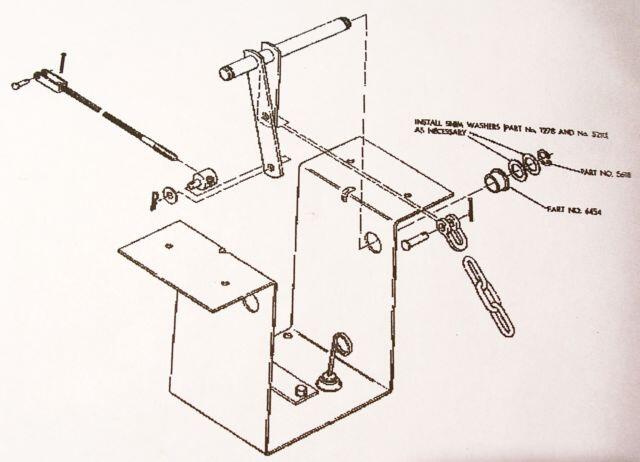

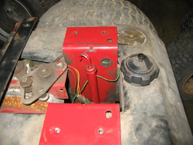

daveoman1966 3,884 #4 Posted August 13, 2021 (edited) 31 minutes ago, OutdoorEnvy said: they're flat against the fender wall. I removed paint to the point the bushings went in easy. I'm following the directions from wheelhorsepartsandmore where I got the kit. Mine isn't matching the diagram you have above. The diagram (schematic) in my posting is for the 76-77 C-160 tractor, but it installs in the same way as yours does. Yours is likely to be similar to the one in the bottom pic. I can only suggest that you START the 2 bolts in the left side of the fender pan, the use a round phillips head screwdriver to poke thru on of the right side holes, and force it to alignment. Then start one of the bolts...pull out driver...then start the other bolt. Edited August 13, 2021 by daveoman1966 2 Share this post Link to post Share on other sites

gwest_ca-(File Mod) 12,452 #6 Posted August 13, 2021 Manual states you can remove the shims and washers as necessary to fit. 2 Share this post Link to post Share on other sites
