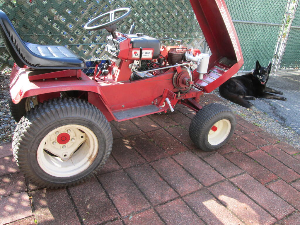

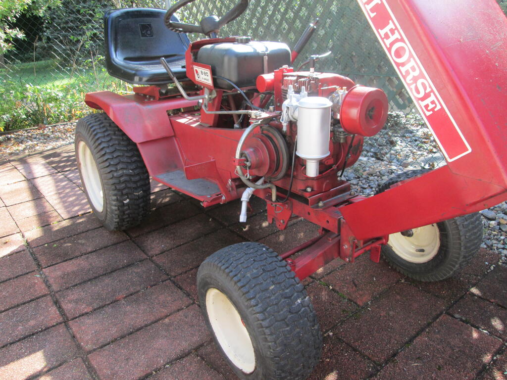

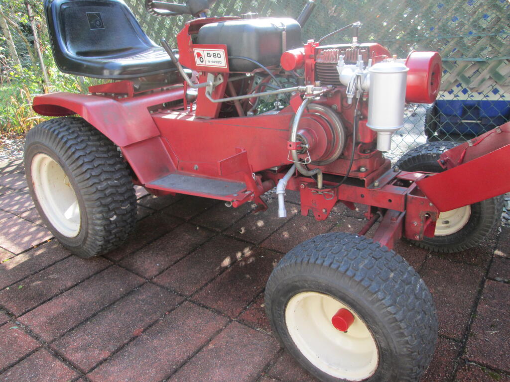

Retired Wrencher 6,783 #1 Posted August 13, 2021 Just enjoying the cool morning and the light hitting it just right. The camera never does it justice. I bought a $20.00 carb till I rebuild the original one. Works good so far. I had to drill out the choke lever and governor lever to get the cable and linkage thru. Also the air cleaner housing the drill and tap depth was way off so had to jury rig that for the housing to fit. Outer than that it works good no leaks . It is a good tractor now, as always fun to tinker with these old Iron tractors. Hope you enjoy the picks. 11 6 Share this post Link to post Share on other sites
edgro 680 #2 Posted August 13, 2021 I like your oil drain pipe, thanks for the pics. I have a B80, nice tractor, mine doesn't have low range trans, im guessing that was optional Share this post Link to post Share on other sites
WHX?? 57,384 #3 Posted August 13, 2021 29 minutes ago, Retierd Wrencher said: air cleaner housing the drill and tap depth was way off so had to jury rig that for the housing to fit. Just be careful those screws don't come out .... Piston damage ? - Engines - RedSquare Wheel Horse Forum 1 Share this post Link to post Share on other sites
Retired Wrencher 6,783 #4 Posted August 13, 2021 1 hour ago, WHX?? said: Just be careful those screws don't come out .... Piston damage ? - Engines - RedSquare Wheel Horse Forum Been there Bud. I just used washers to take up the space. Share this post Link to post Share on other sites
Retired Wrencher 6,783 #5 Posted August 13, 2021 1 hour ago, edgro said: I like your oil drain pipe, thanks for the pics. I have a B80, nice tractor, mine doesn't have low range trans, am guess that was optional after 74 they where all 8 speeds from what I have seen? Share this post Link to post Share on other sites
ebinmaine 79,637 #6 Posted August 13, 2021 8 hours ago, edgro said: . I have a B80, nice tractor, mine doesn't have low range trans, im guessing that was optional 6 hours ago, Retierd Wrencher said: after 74 they where all 8 speeds from what I have seen? Of the B80s from 1974 to 1977: The 74 and 75 were Mid-frame length and 4 Speeds. The 76 and 77 were Long frames and 8 Speeds. 1 Share this post Link to post Share on other sites
ebinmaine 79,637 #7 Posted August 13, 2021 @Retierd Wrencher Those B80s are a great machine. Glad it's going well for you. And thanks for the pics! Share this post Link to post Share on other sites
Retired Wrencher 6,783 #8 Posted August 14, 2021 (edited) 12 hours ago, ebinmaine said: @Retierd Wrencher Those B80s are a great machine. Glad it's going well for you. And thanks for the pics! Thanks Eric I have had so many of these over the years. Just great little tractors. Thanks for the reply. Edited August 14, 2021 by Retierd Wrencher 1 Share this post Link to post Share on other sites
