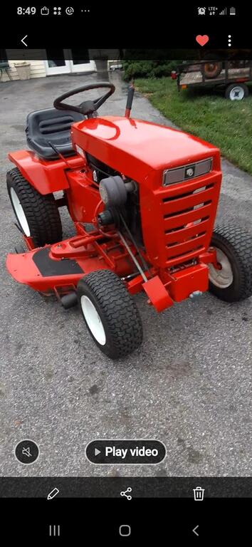

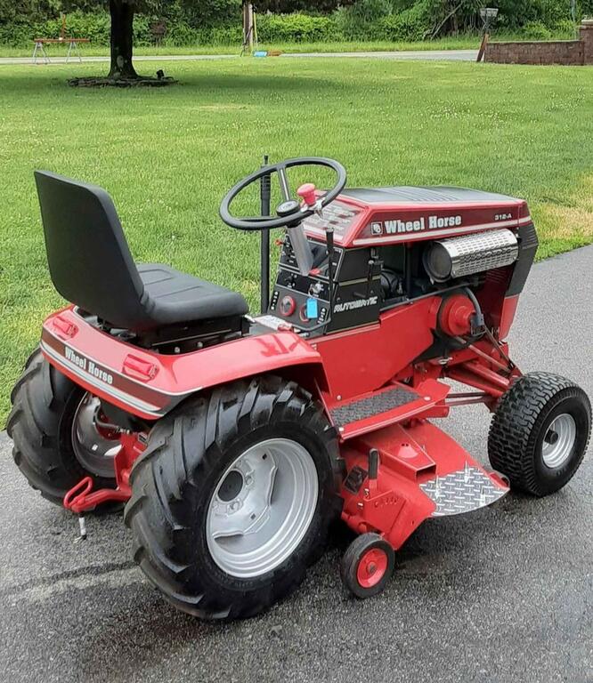

josephvigg 88 #1 Posted August 11, 2021 Good morning all. So im ready to buy a tractor for my one acre home. Some hill some unevenness but mostly pretty flat. Started doing some research that included with my love of old school and my hate for everything big box store and plastic has led me to the Wheel Horse. I have one on the line im negotiating with. It was a complete tear down and rebuild from someone that truly knows what they are doing. Its pricey at $1800 but so is a new tractor that's not really rated to do anything but cut grass and hold beer. I like a low cut lawn and I get a **** ton of leaves in the winter - so ideally id like to put a bagger on this from time to time. It also comes with plow blade but im not sure how much id use it for snow. I mow once a week and if last year is any indication two MAJOR leaf hauls if not three. Assuming everything is fully functioning and restored is this - worth it? how difficult is this model to do general maintenance on? (I want to spend more time working less tinkering), are there any fatal flaws with this model? and can I cut my acre of lands grass without issue and suck up these damn leaves into a bag before I garage her for the winter and day dream about running her again! Thank you so much in advance! 3 5 Share this post Link to post Share on other sites
Mike in NC 342 #2 Posted August 11, 2021 Welcome to the forum! I have a Wheel Horse very similar to that one. It is a 312-H. I live in the mountains and it does real well. They are a heavy built machine. I have a different Wheel Horse that I use to plowing snow, dirt, gravel, whatever I need to push, it too is a hydro and does great. I will have to let someone else answer about the price. But that one looks real nice. Share this post Link to post Share on other sites
D_Mac 9,337 #3 Posted August 11, 2021 First off welcome to Red Square. The tractor seems really nice. I am assuming it runs as well as it looks? Have you heard it run and seen it cut? Is there paper work on what was done to the engine? In my opinion 1,800 is high. I would be more comfortable paying 1,000 - 1,200 range. Plenty of Wheel Horse out there they may not look as pretty but perform just as well for less then half of that amount. Then you can have some fun by restoring it yourself. 1 Share this post Link to post Share on other sites
rmaynard 17,423 #4 Posted August 11, 2021 That 312-A looks nice. The 42" deck is just the right size for a 1 acre lot, and it will give you a good cut. However, if you have a lot of leaves in the fall, I would recommend a Cyclone Rake to pick up leaves. I live on a 1.06 acre wooded lot (oak trees), but only mow about 1/2 of it. In the fall, even with 1/2 of leaves, it's a full-time job. $1800 doesn't seem too high compared to what you get at the big box stores for more money. 2 Share this post Link to post Share on other sites
71_Bronco 1,072 #5 Posted August 11, 2021 $1800 seems a little steep to me as well, but then again, I know how things add up when restoring these tractors. I'd also check to see if he did anything to the hydro unit as part of the rebuild, and as others stated, any paperwork / build sheets for the engine. A complete overhaul on an engine (bore, rings, piston, crank grind, etc) can get pretty pricey. Also check that the deck was done, bearings, blades etc. Don't get me wrong, it is a beautiful tractor. But if you are just looking for a worker that doesn't have to look pretty, you can save yourself a lot of money. Ona side note, the plow is not just for snow. You can use it on dirt as well, if you decide to do any type of landscaping. Share this post Link to post Share on other sites

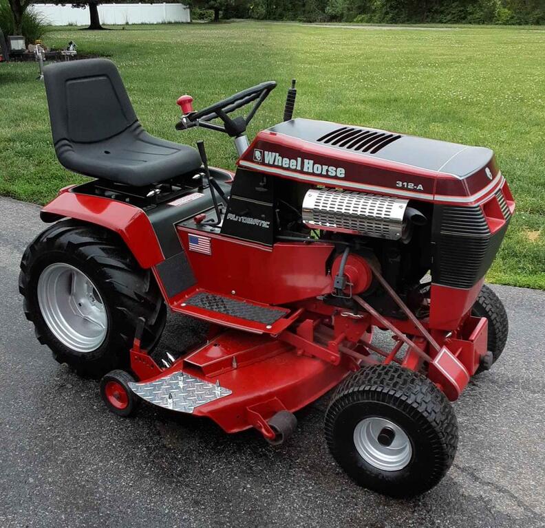

JCM 11,259 #22 Posted August 11, 2021 to The 312-A should have a 12 HP Kohler with an Eaton 700 Hydro. Great engine with a decent trans but not as strong as the 1100. Very different paint scheme but nice. 3 Share this post Link to post Share on other sites
Ed Kennell 46,572 #23 Posted August 11, 2021 to the Joseph. That is a great looking 312A. But, IMO, the A is the problem. That has a manual lift and every manual lift I have ever seen has the weaker Eaton 700 transmission. The 312H has the stronger Eaton 1100 and the hydraulic lift. 2 Share this post Link to post Share on other sites
Lee1977 7,709 #24 Posted August 11, 2021 If the 312 doesn't have a oil filter on the left side behind the rear wheel, I would pass on it. The price is way two high to take a chance on it with a 700 Eaton as it's not strong enough for a garden tractor. 1 Share this post Link to post Share on other sites
roadapples 6,987 #25 Posted August 11, 2021 Yup, with 700 Trans and manual lift, wouldn't give half that. Even if it is purdy... 2 Share this post Link to post Share on other sites
