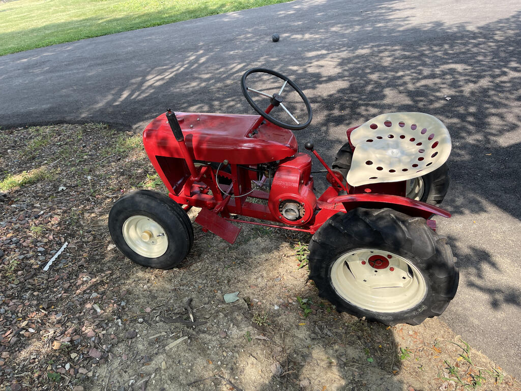

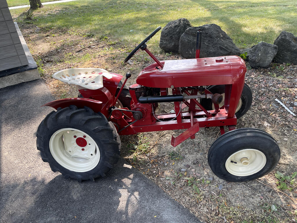

WheelHorseRJ 4 #1 Posted August 9, 2021 (edited) Hello, I came across this tractor and was told it was a 1957. After looking further I do not believe that is possible. But now have no idea what model it is. I am including photos but cannot guarantee the Kohler K 91 engine is the original. Any help would be appreciated I would love to finish it up and start using it around the house. Thanks Edited August 10, 2021 by WheelHorseRJ More Photos 2 2 Share this post Link to post Share on other sites
rmaynard 17,575 #2 Posted August 9, 2021 I'm not a specialist on the older stuff, but 1957 doesn't seem too far off. 1 Share this post Link to post Share on other sites
wallfish 20,576 #4 Posted August 9, 2021 (edited) The hood and cast clutch pedal with the 3 piece trans indicate it's a 1961 model 401 You'll need a belt guard to keep from grinding the gears when shifting into gear. The belt guard supports the belt around the engine pulley to let it slack off the groove so it doesn't turn the trans pulley. Upon closer inspection of the hood it looks like someone modified a 1960 hood. 1960 hood had that square hole and that's where the throttle and choke controls were located. 1961 used the push/pull controls like what's on there but there was a round hole where the square one is now and a big electrical box plug was used to fill in the round hole. The foot rests aren't original. not bashing just providing information Edited August 9, 2021 by wallfish 4 3 Share this post Link to post Share on other sites

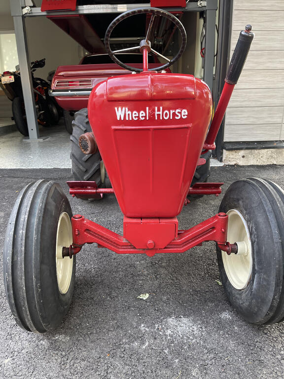

rmaynard 17,575 #10 Posted August 10, 2021 How about posting a picture from the front and the back. 2 Share this post Link to post Share on other sites

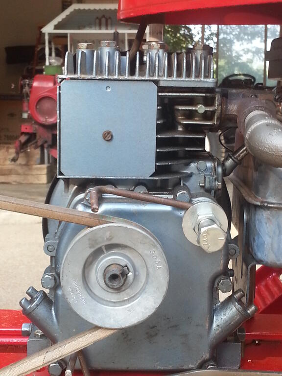

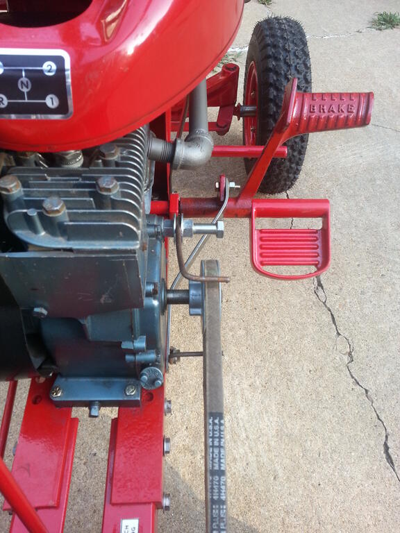

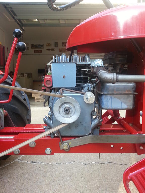

stevasaurus 23,848 #14 Posted August 10, 2021 Very nice looking horse and Welcome to Red Square. It is a 1960 / 1961 for sure with that front axle. The original belt guards are hard to find, but we did have a member that was making them. Have to look around for that. What you can do so you can drive it without grinding gears, is to put some bent wire as guides for the belt. When you step on the clutch the belt guard would funnel the slack in the belt toward the engine pulley. This allows the input pulley on the trans to stop rotating so you can shift. This will work...Wallfish did this for Howard at the big show a few years ago. Notice one on top of belt and one underneath the belt. Need to be about 1/4" from belt. 2 2 Share this post Link to post Share on other sites

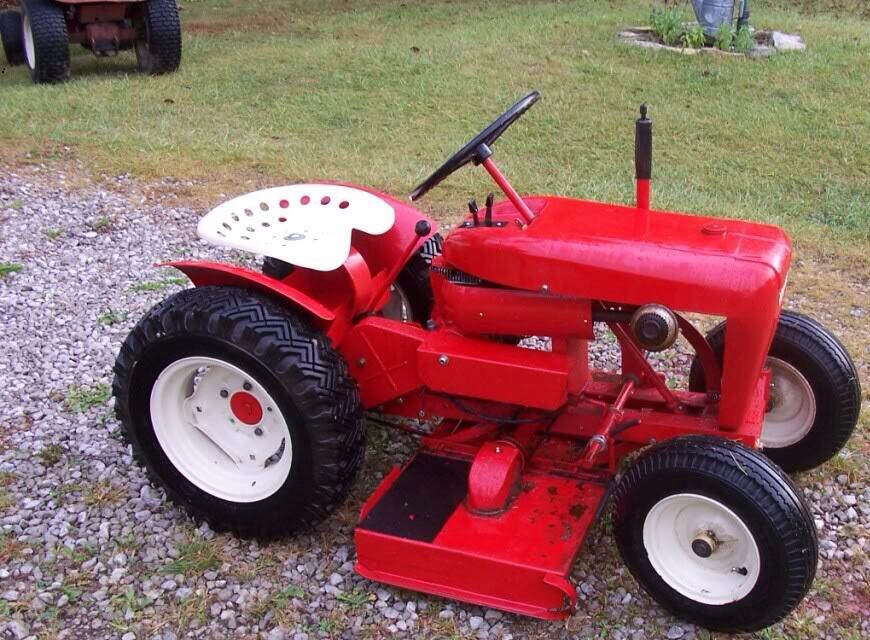

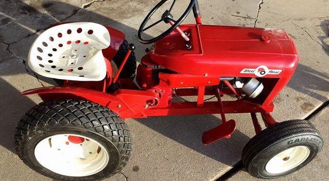

Achto 32,633 #16 Posted August 10, 2021 36 minutes ago, WheelHorseRJ said: Does anyone know what might have gone in the rectangular hole in the hood? On the 1960 models that cut out would have been for the throttle and choke mounting plate. You can see the throttle and choke levers in the picture below. On the 1961 models the Suburban's came with push/pull throttle and choke knobs like your tractor has. This is one discrepancy on your tractor that is makes it difficult to pin down the correct year. You have a '60 hood that some one has altered to have the '61 throttle & choke. Here is a picture of a '61 model with the correct hood, push/pull throttle & choke, and the round plug for accessing the spark plug. '61 was also the only year to use the type of foot rests that you see in this picture. '60 or '61 either was a good year and your tractor is well worth owning and enjoying. 3 1 Share this post Link to post Share on other sites
