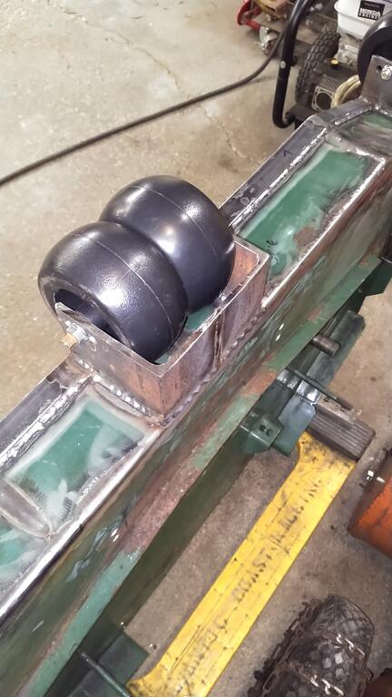

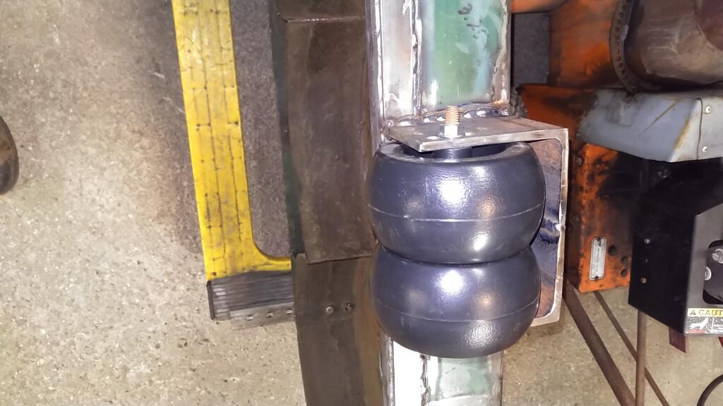

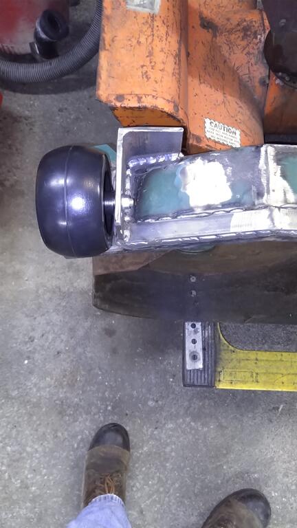

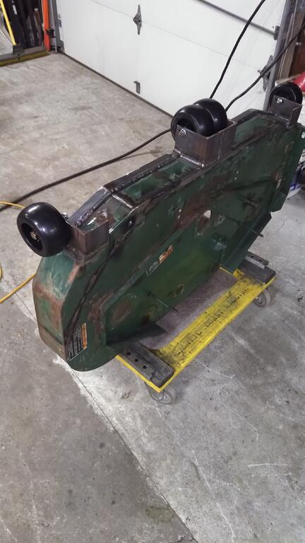

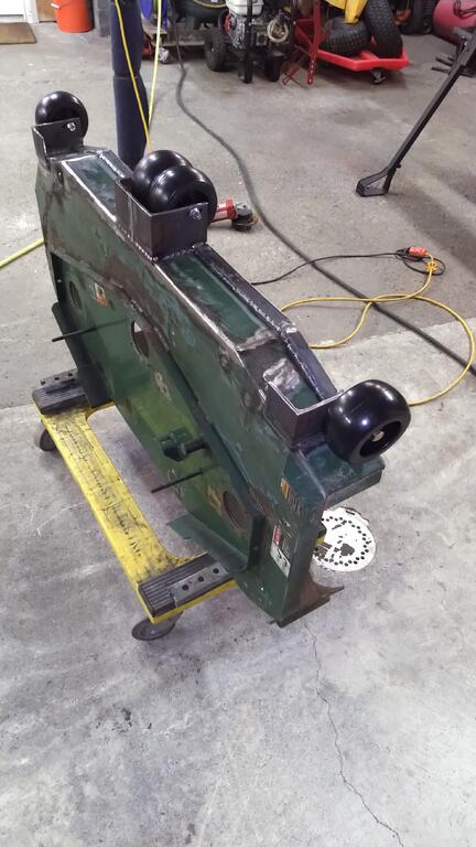

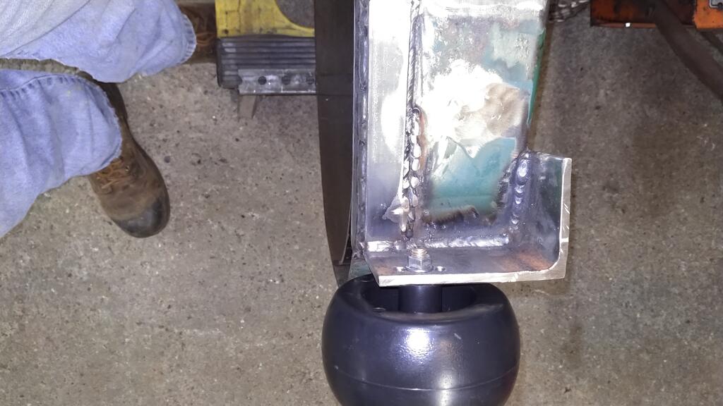

Bill D 2,617 #58 Posted October 2, 2021 Made some progress today. Not my best welding job, but not my worst either. The antiscalp wheels are a Husqvarna part. I like the way they look. Welded a 1" strip of 1/4" steel along the front edge to beef it up. Almost done with the fab work. I have to weld a couple of small holes up then weld on tabs for the Trac Vac boot. I got new high lift blades for it. I'm thinking about buying X Blade brackets and using the Gator blades I already have as well. If I do that this thing will absolutely destroy leaves. 1 2 Share this post Link to post Share on other sites

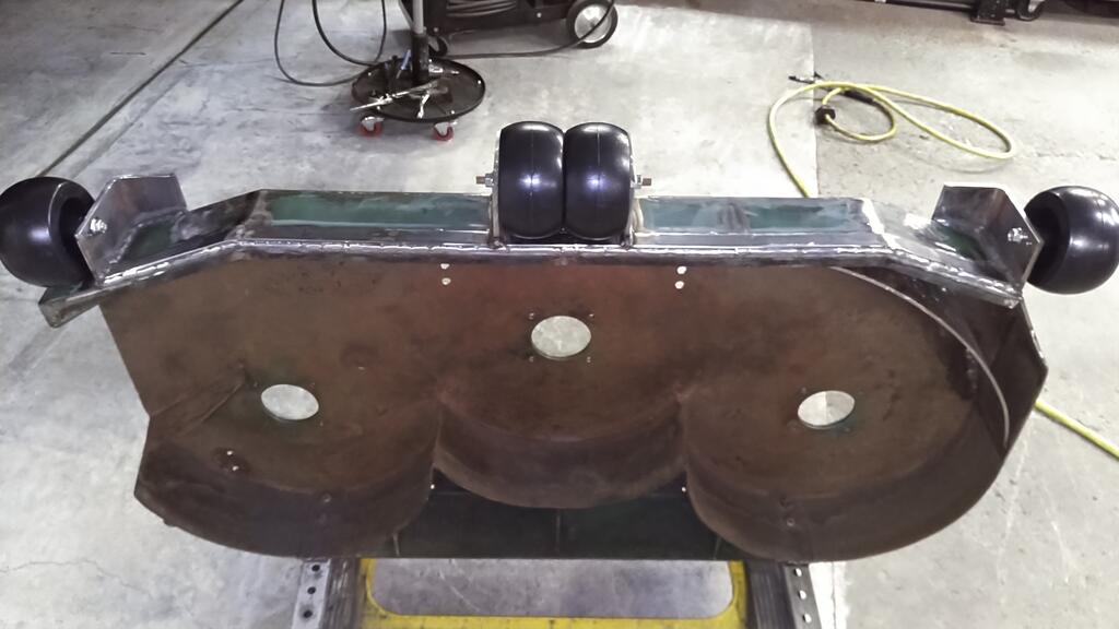

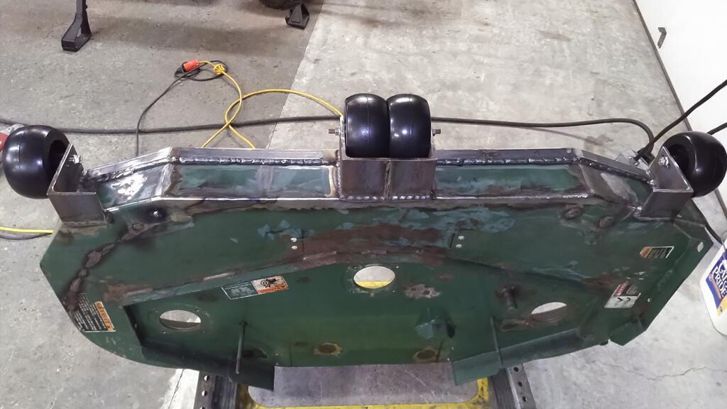

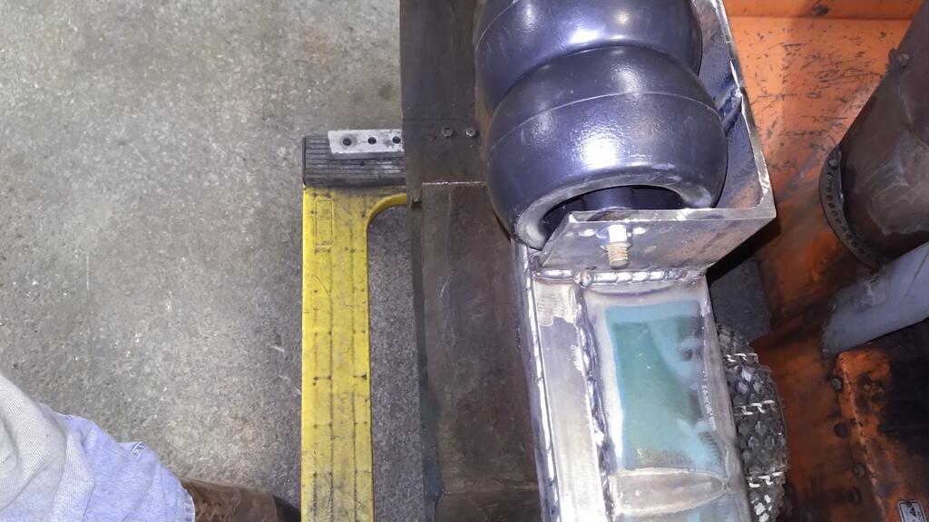

Bill D 2,617 #59 Posted October 2, 2021 More photos. 3 1 Share this post Link to post Share on other sites
kpinnc 17,294 #60 Posted October 3, 2021 That looks great! If those welds are bad looking, you should see mine! The cat keeps trying to cover stuff up that I weld! That deck is gonna last for years! Very nice! 1 1 Share this post Link to post Share on other sites
Bill D 2,617 #61 Posted October 3, 2021 15 hours ago, kpinnc said: That looks great! If those welds are bad looking, you should see mine! The cat keeps trying to cover stuff up that I weld! That deck is gonna last for years! Very nice! Thanks for the compliment. I thought your welds looked very good in the pictures you've posted. 1 Share this post Link to post Share on other sites
Pullstart 68,981 #62 Posted October 3, 2021 Great work! I don’t have to mow with my Horses, but if I did I’d likely do something similar! 1 Share this post Link to post Share on other sites
peter lena 9,782 #63 Posted October 4, 2021 @Bill D nice build up on that , like the bombproof build quality set up , pay attention to regular cleaning of that , get a lubrication soak on that under deck area , when steel is absorbing lubricant , it turns black , when you are at that stage , leave it upside down to hold the lubricant on the surface . do that on mine , in hot sun , really makes them last , small file sharpening , removes minimum metal , and makes blades really nice , oil coat when done . you are so far off the norm now , keep your make it better ideas going . good job , pete Share this post Link to post Share on other sites
Bill D 2,617 #64 Posted October 4, 2021 Thanks for all the kind words. This project is coming out better than expected. I plan to coat the underside with POR 15. I like making stuff bulletproof when I can. To that point, does anyone have a suggestion for upgrading the gauge wheels. This deck is very heavy and could benefit from wider gauge wheels with bearings. I appreciate any input in this area. Thanks 1 Share this post Link to post Share on other sites

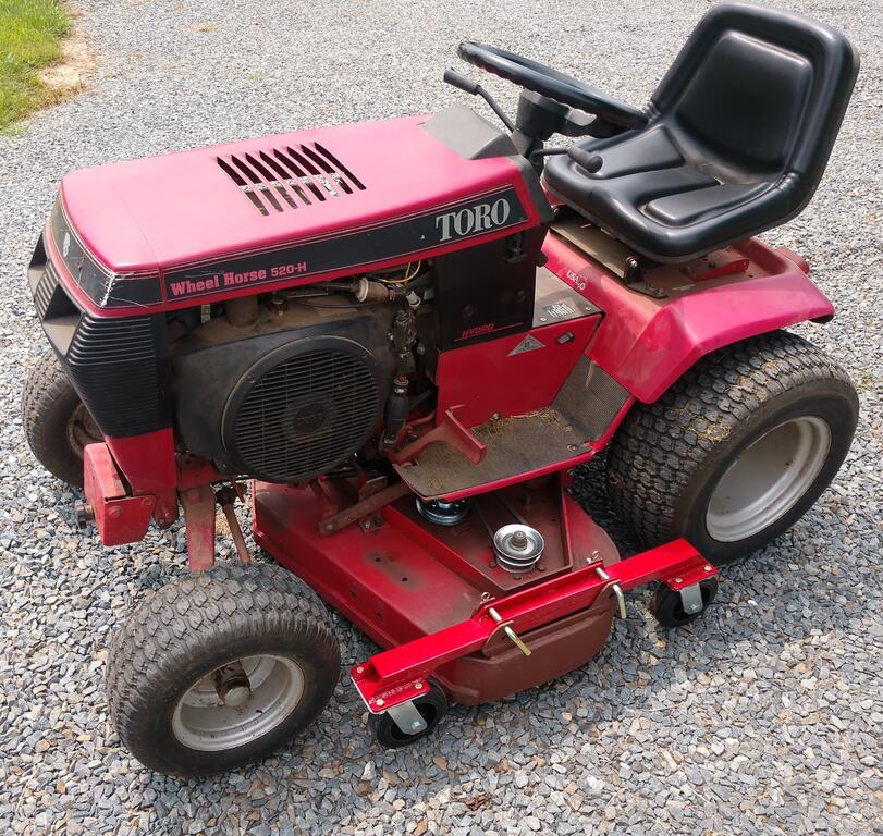

peter lena 9,782 #70 Posted October 6, 2021 @Bill D the more i think about your , modified deck , you could easily fit on some zero turn type swivel wheels that would get it done . i would make a base mount for those , that would make installation and removal easy , like a 1 pin slide in , to secure it . just an idea , pete Share this post Link to post Share on other sites
kpinnc 17,294 #71 Posted October 6, 2021 3 hours ago, peter lena said: @Bill D the more i think about your , modified deck , you could easily fit on some zero turn type swivel wheels that would get it done . i would make a base mount for those , that would make installation and removal easy , like a 1 pin slide in , to secure it . just an idea , pete Been done! I've mowed with them, but am working on the fixed option now. Still gonna keep the casters for installing and removing though. 2 1 Share this post Link to post Share on other sites
peter lena 9,782 #72 Posted October 6, 2021 @kpinnc nice set up there , always thought those rolling casters were the way to go for support and the side tracking involved with mowing . always looking for a way to make an issue go away . love the idea of outside the box , a nagging problem is a place to get creative . that's why when someone shows' a picture of an opportunity area , I usually make a comment about , while you are there ------, why not make the problem go away ? good picture pete Share this post Link to post Share on other sites
Bill D 2,617 #73 Posted October 7, 2021 7 hours ago, kpinnc said: Been done! I've mowed with them, but am working on the fixed option now. Still gonna keep the casters for installing and removing though. Can't wait to see what you come up with. I would consider replacing the front caster with an antiscalp wheel. You could use the same bracket mount. Just change them out when you want to remove the deck. 1 Share this post Link to post Share on other sites

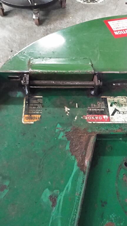

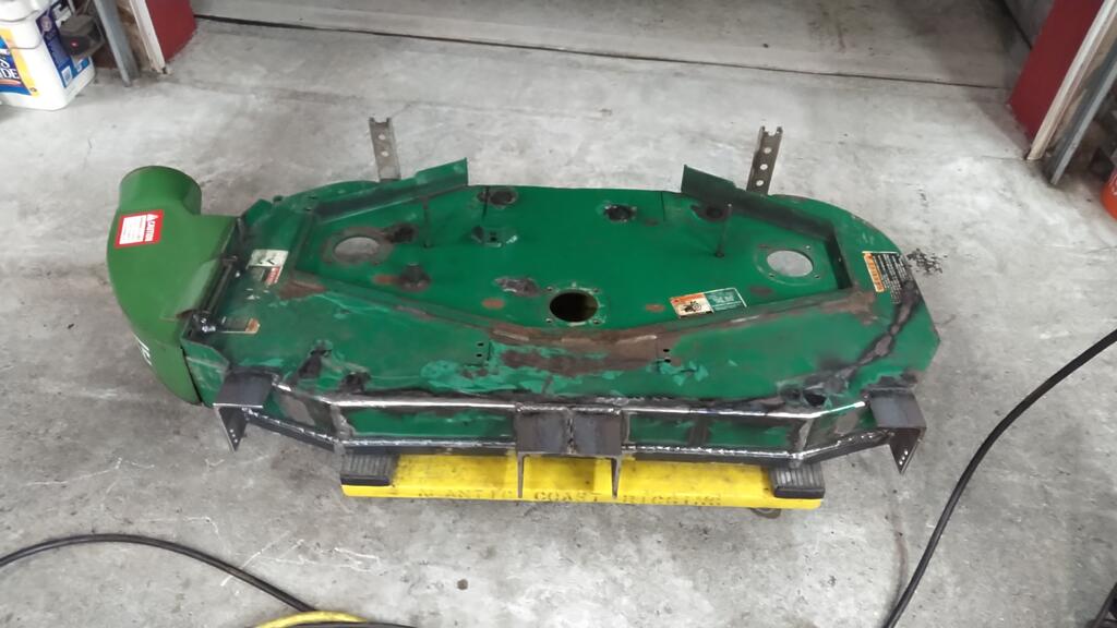

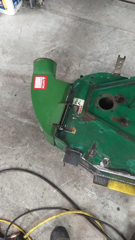

Bill D 2,617 #74 Posted October 8, 2021 Last of the fab work is done. Clean up and paint next. The Trac Vac boot was for a Deere, but it fit this deck like a glove. 2 1 1 Share this post Link to post Share on other sites
