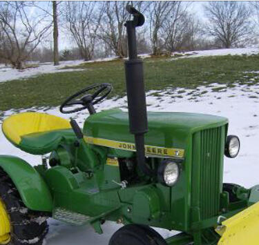

WheelHorse520H 710 #52 Posted August 15, 2021 (edited) Here’s another random question that popped up. I need a stack to redirect the exhaust away from the hood to keep it clean and prevent damage to the paint. Currently the exhaust comes straight out of the muffler and into the front of the hood. I want a stack that will go straight up but I also want a good muffler in it so the tractor is still quiet, I also want one with the little cover on the top that moves up and down while it’s running to keep water out. Similar to the one below from My Tractor Forum. It would be even better if I could mount it to the existing muffler to make it super quiet. What have you guys used that work? Edited August 15, 2021 by WheelHorse520H Share this post Link to post Share on other sites
ebinmaine 80,638 #53 Posted August 18, 2021 On 8/15/2021 at 7:11 PM, WheelHorse520H said: What have you guys used that work Stacks can be done a number of ways. @jimkemp makes a very nice one. You can also use a late 70s Cub muffler turned to face up. The one in the above post appears to be a farm tractor muffler adapted to work. Share this post Link to post Share on other sites
WheelHorse520H 710 #54 Posted August 18, 2021 4 minutes ago, ebinmaine said: Stacks can be done a number of ways. @jimkemp makes a very nice one. You can also use a late 70s Cub muffler turned to face up. The one in the above post appears to be a farm tractor muffler adapted to work. Ok thanks, just looking for ideas. 1 Share this post Link to post Share on other sites

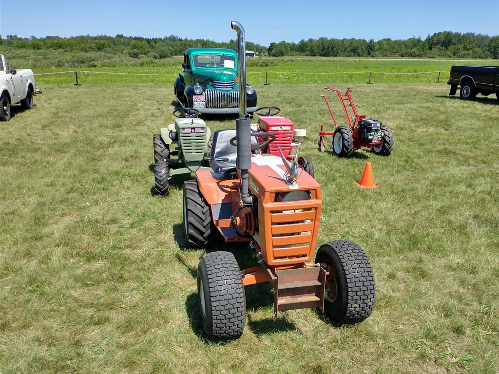

ebinmaine 80,638 #55 Posted August 18, 2021 27 minutes ago, WheelHorse520H said: Ok thanks, just looking for ideas. @OldWorkHorse could share a pic of his woman's tractor. Flowah Powah. That's my old rig with a Cub muffler. Here's Cinnamon Horse C160. 1 Share this post Link to post Share on other sites
WheelHorse520H 710 #56 Posted August 18, 2021 2 minutes ago, ebinmaine said: @OldWorkHorse could share a pic of his woman's tractor. Flowah Powah. That's my old rig with a Cub muffler. Here's Cinnamon Horse C160. Ahh I’ve seen the purple machine, I will look at the photos of it in the what have you done to your wh today thread. Cub muffler isn’t a bad idea. 1 Share this post Link to post Share on other sites
