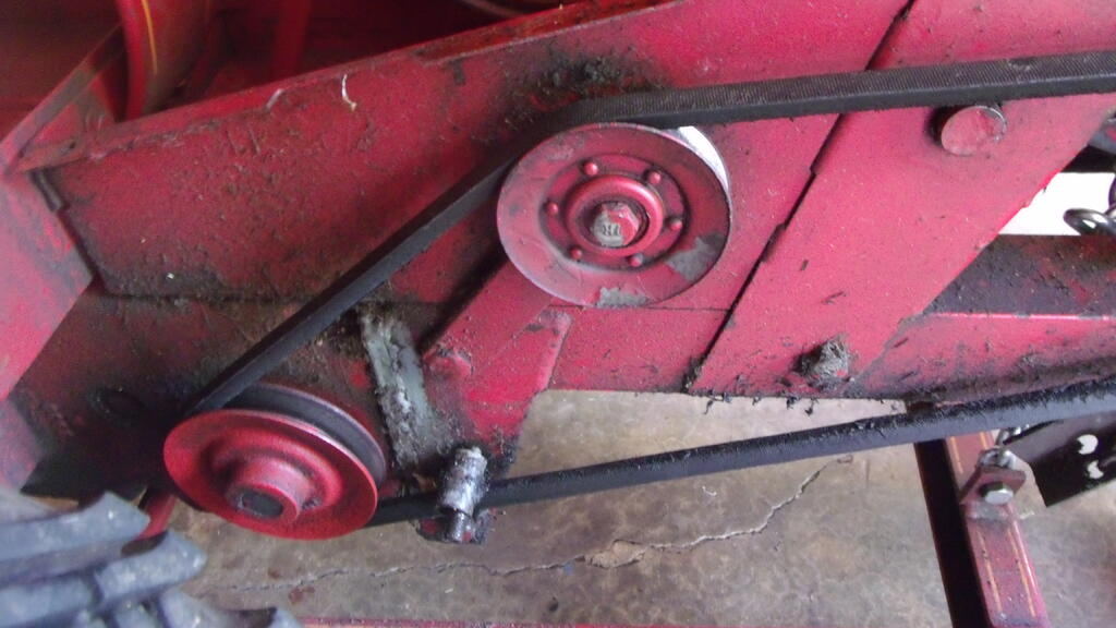

WheelHorse520H 710 #12 Posted August 9, 2021 Just now, ebinmaine said: Any particular measurements or orientation that you are looking for? All sides you can, I know that are irregularly shaped. Do you know if the inside near the belt is flat or is there anything separating the belt or something? 1 Share this post Link to post Share on other sites
ebinmaine 80,638 #13 Posted August 9, 2021 (edited) The belt rides along most of the bottom of the guard. On the inside of the guard of course. Edited August 9, 2021 by ebinmaine Share this post Link to post Share on other sites

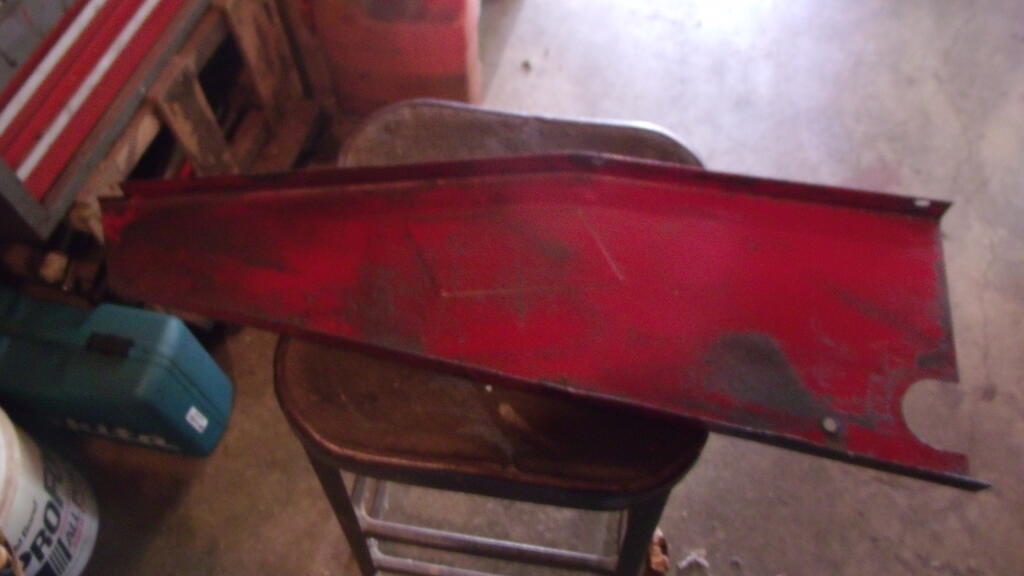

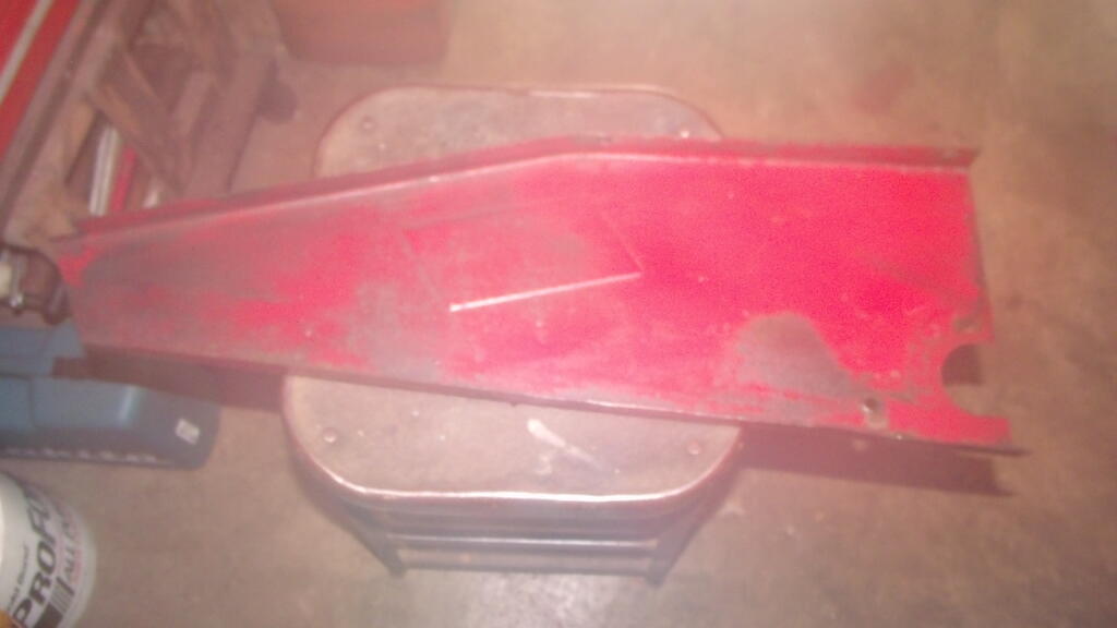

stevasaurus 23,848 #14 Posted August 9, 2021 I have a photo of my guard for my 857. 1 1 Share this post Link to post Share on other sites

WheelHorse520H 710 #16 Posted August 9, 2021 1 minute ago, ebinmaine said: The belt rides along most of the bottom of the guard. 1 minute ago, stevasaurus said: I have a photo of my guard for my 857. Thank you, this is good info. The shape is important too, thanks again. 1 Share this post Link to post Share on other sites
stevasaurus 23,848 #17 Posted August 9, 2021 Are you looking to keep this engine?? Using John's picture and what I and Eric have pictures of, you can easily make something safe that works. Of course, it would be excellent to have something close to cut to fit... @WHX?? has a bunch of guards...maybe he or @Achto can help you out. The guard needs to be made, so it funnels the slack in the belt (when you push in the clutch) toward the engine pulley. That lets the input pulley, on your trans, stop so you can shift without grinding gears. Like John said, you can also use like #109 wire to bend and mount these to funnel the slack also. The guard also protects your right leg...very important. 1 Share this post Link to post Share on other sites

stevasaurus 23,848 #19 Posted August 9, 2021 Good to hear. Last thing we want to do, is give out information that gets you hurt. I the pictures I posted, the wide end is toward the transmission, the wide part is over the tension pulley, the narrow end is just near the engine pulley. That bolt with the sleeve on it does a lot to funnel the slack forward. The guard covers the belt. 1 Share this post Link to post Share on other sites
Achto 32,633 #20 Posted August 9, 2021 If you are keeping the Tecumseh engine then most any guard from a short frame with a Techy should work. If you wish to try to make one yourself, the only square corner on the whole thing is the upper rear corner. Take all of you measurements from that corner and they are not too hard to lay out. 1 Share this post Link to post Share on other sites
