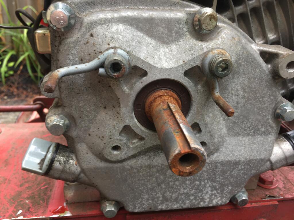

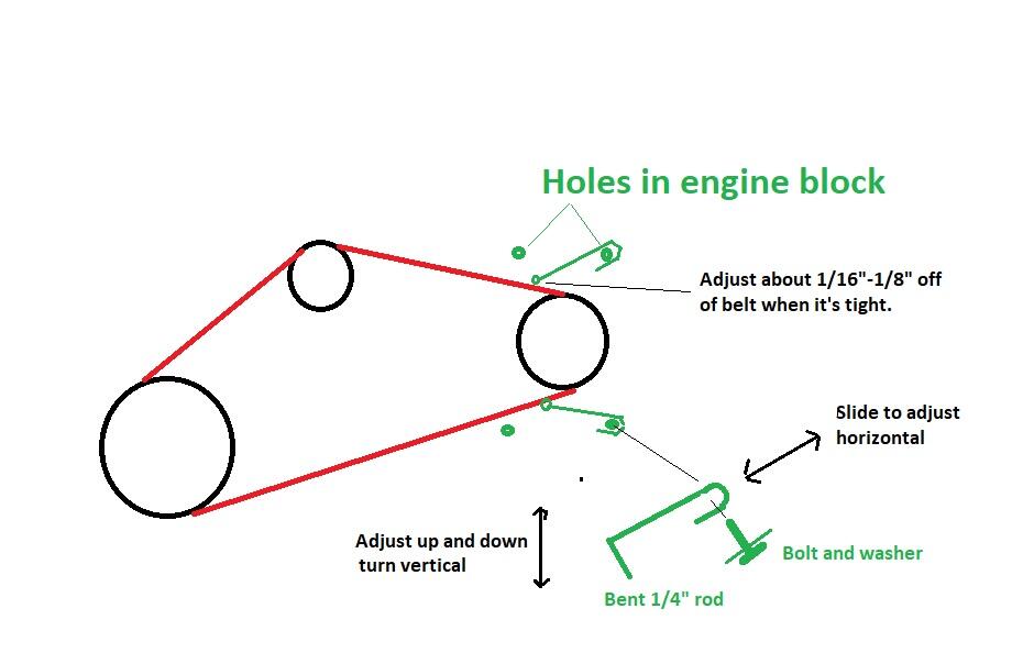

WheelHorse520H 710 #33 Posted August 10, 2021 (edited) 20 hours ago, wallfish said: The only thing different for a belt guard on a similar model tractor with a Kohler is the hole location for where it mounts to the engine. Not a big deal to make them fit. To make it run without a belt guard so the gears don't grind, you can support the belt around the engine pulley with little metal "fingers" made from round bar. Would this setup work? It came like that. It runs, I put a little fresh gas and some SeaFoam in took the spark plug and cleaned it, sprayed some startling fluid in and BAM it started right up. What oil does the tranny take? It seems a little low I think, it is very loud when you push it. Edited August 10, 2021 by WheelHorse520H Share this post Link to post Share on other sites
ebinmaine 80,638 #34 Posted August 10, 2021 9 minutes ago, WheelHorse520H said: Would this setup work? Seems to me if you moved the right hand support so that it's on the bottom it would be helpful. The entire bottom of the belt is going to need to be supported though. Your transmission takes the least expensive 80 or 90 weight oil that you can get. Drain plug is at the back on the bottom. Lift the front of the tractor as high as you can safely do so because there's a hump in the middle. It would be a very good idea to flush the transmission with diesel or kerosene. Share this post Link to post Share on other sites

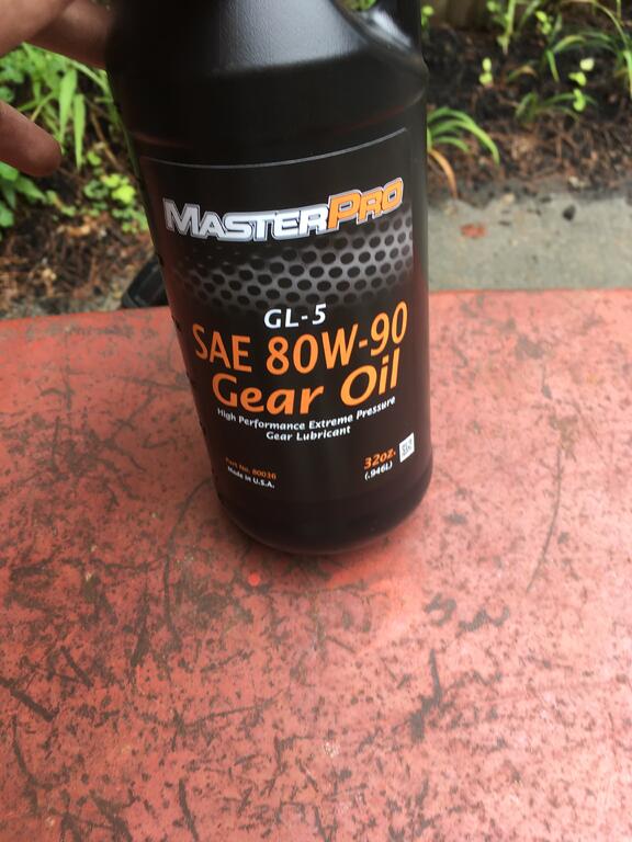

WheelHorse520H 710 #38 Posted August 10, 2021 Will this work? My assistants that went and got it for me said this was all O’Reilly had for 80 or 90. 1 Share this post Link to post Share on other sites
ebinmaine 80,638 #39 Posted August 10, 2021 23 minutes ago, WheelHorse520H said: Will this work? That'll do just fine. Just for future reference there are transmissions in other machines not related to Wheelhorse where the gl4 or gl5 designation must be followed. But these machines are perfectly happy with either. Here's an excerpt from the interwebs: The main difference between GL-4 and GL-5 gear oils is the amount of EP additives. Sulphur/Phosphorus containing products are used as EP-additive. This additive has the purpose to prevent the occurrence of micro-welds on the gear flanks at the local high temperatures which prevail in EP circumstances (temperatures well in excess of 800℃!) GL-5 has roughly twice the amount of EP additives compared to GL-4, which is why it is often used in high-pressure circumstances such as in a front axle and rear axle differential. Sulphur/Phosphorus additives however have an unfavourable property: they can react aggressively towards bronze and copper. This can be disastrous for the synchromesh rings of a gearbox. Therefore it is not recommended to use GL-5 in a gearbox unless the manufacturer allows this. To the best of my knowledge there are no bronze or copper products in a Wheelhorse transmission. 1 Share this post Link to post Share on other sites

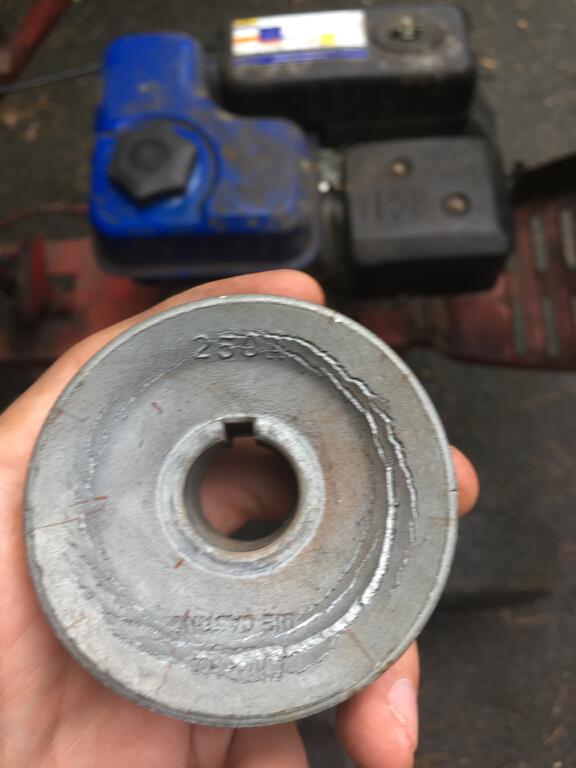

WheelHorse520H 710 #48 Posted August 11, 2021 Sorry, another question. Would This pulley work for this machine, is it rated for the 6.5 hp? I could not find a rating anywhere. The one that’s on there is small so the belt slips and is damaged. Share this post Link to post Share on other sites
ebinmaine 80,638 #49 Posted August 11, 2021 Looks like that one should be fine. I've used those TB Woods pulleys. I've also used Grainger. I like them both. However, chances are very high you'd be able to find that for a lot less money somewhere else. Share this post Link to post Share on other sites
ebinmaine 80,638 #50 Posted August 11, 2021 The one in the picture above should immediately be thrown in the recycling bin so nobody ever gets a chance to use it again 1 Share this post Link to post Share on other sites
