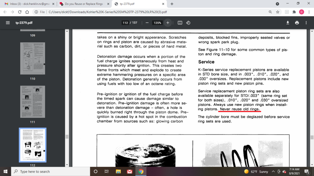

953 nut 67,486 #4 Posted August 9, 2021 Your piston rings are made of cast iron and will wear just like the cylinder walls. The Kohler manual clearly states you NEVER reuse old rings. 5 1 Share this post Link to post Share on other sites

oliver2-44 11,632 #8 Posted August 9, 2021 8 hours ago, Achto said: Rings seat or wear in when you run the engine. Once you pull them out you can never get them back in the exact orientation that they were in. This will cause them to leak, oil & compression. Besides this fact, you already have it apart why would you not change them? That essentially what i had beet told by old timers. 8 hours ago, 953 nut said: Your piston rings are made of cast iron and will wear just like the cylinder walls. The Kohler manual clearly states you NEVER reuse old rings. its good to see this in writing, it clarifies what I've always done, just never had a iron clad reason why. 3 Share this post Link to post Share on other sites
