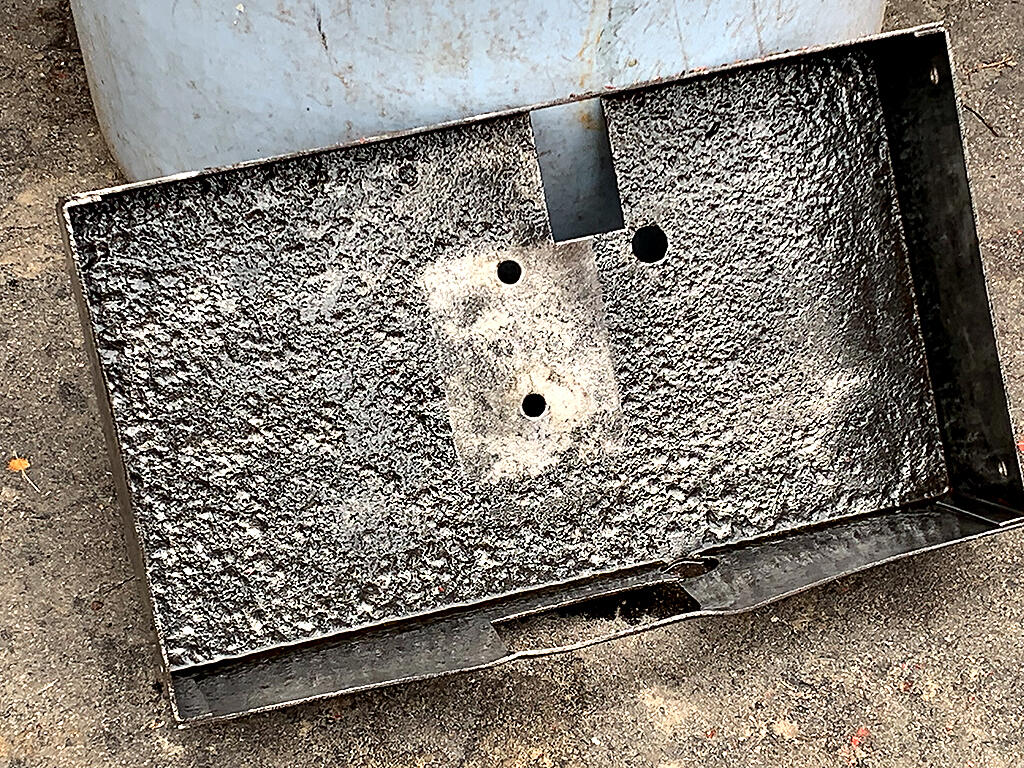

jsp_333 289 #1 Posted August 7, 2021 I'm doing a full restore on an rj. Several pieces have some pretty significant pitting. When all the paint is stripped off and down to bare metal it looks pretty cool. Tool box in pic has some flash oxidation on it. I know I can't keep it as bare metal Has anyone just gone from bare pitted metal to primer to paint and left the pitting. And were you pleased with the result? Or did you regret not filling the pits with bondo and getting a nice smooth surface. Also this is my first restore. Am I correct in thinking fill in all the pitting with Bondo or is there another way? I know this is subjective and I can get whatever "look" I want but I'm wondering about members' experience with this sort of thing. 1 Share this post Link to post Share on other sites

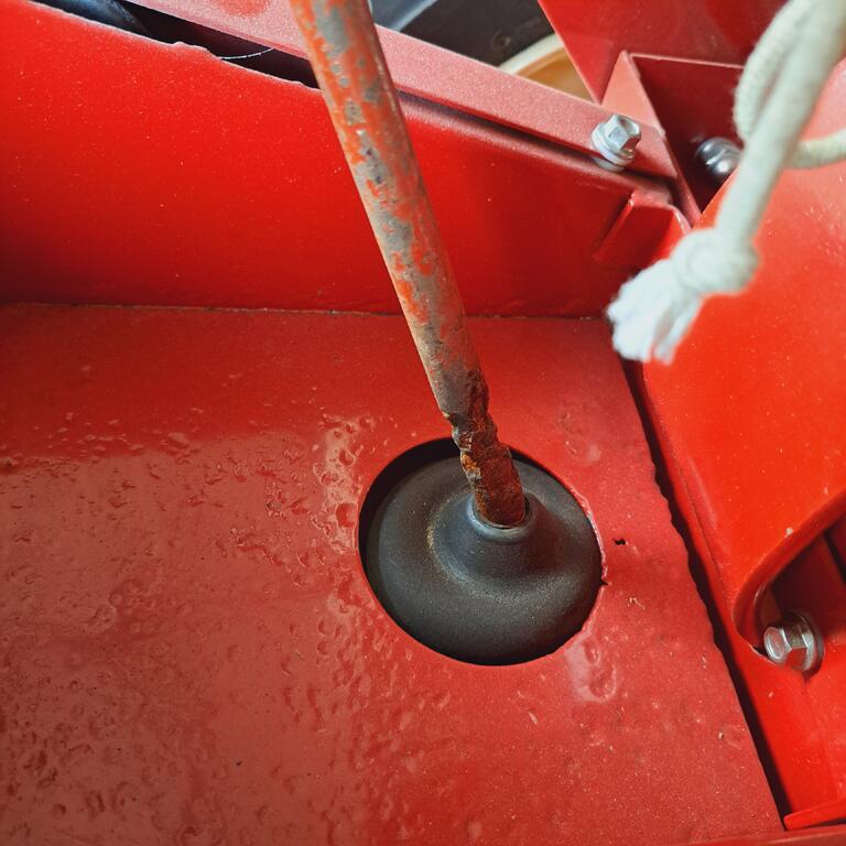

AMC RULES 37,256 #3 Posted August 7, 2021 Had parts of this tractor in bare metal for years. 2 3 Share this post Link to post Share on other sites
AMC RULES 37,256 #4 Posted August 7, 2021 How I kept it sealed. 3 Share this post Link to post Share on other sites

dalez 148 #8 Posted August 7, 2021 If that's the inside of a toolbox I would brush on truck bed coating. 1 Share this post Link to post Share on other sites
jsp_333 289 #9 Posted August 8, 2021 I didn't think keeping it bare metal was an option. But seat, fenders, tool box and rims bare metal would definitely be a look. My seat looks exactly like the one in the video. The tractor will be stored indoors and not used in the summers. It will be used as a snowplow when we get too little snow for the snow thrower and will be fun to bring out with the blade. And for the annual Christmas tractor parade on my street. Truck bed coating is great idea. I think I'll do up the tractor in bright high gloss red put it all back together and see how she looks with the bare metal parts. And it's as simple as pull a part out of the electrolysis tank, wire brush as required, clean it with mineral spirits, dry it and wax it with paste wax? Thanks all 2 Share this post Link to post Share on other sites
AMC RULES 37,256 #10 Posted August 8, 2021 Mine was only a fair weather tractor so it never saw rain or snow while in my possession. But, I have faith in the product, give it a try, I would just reapply it more frequently. 1 Share this post Link to post Share on other sites

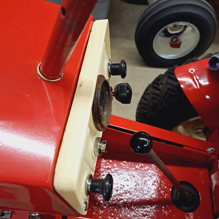

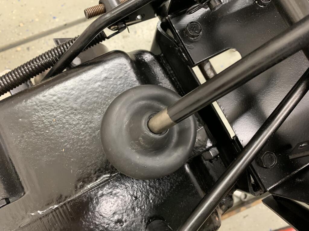

WHX?? 56,033 #19 Posted January 3, 2025 (edited) Musta missed this thread in the day but I love the look of not filling them in on any type of restoration. Adds great character and reminds one of what it looked like before a full paint resto and that it suffered many days outside under no cover. A block of snow & ice. I've seen @Achto filiing them in and I cringe but he drills holes in 50 year old sheet metal too. Last 701 full paint resto I even went so far & left a few small pieces bare for effect. Note the ampmeter bezel, tunnel floor and shifter. Edited January 3, 2025 by WHX?? 2 2 Share this post Link to post Share on other sites
