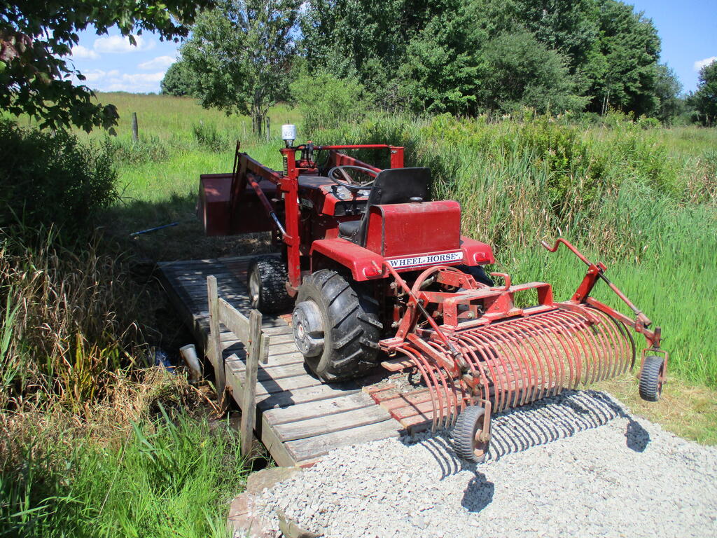

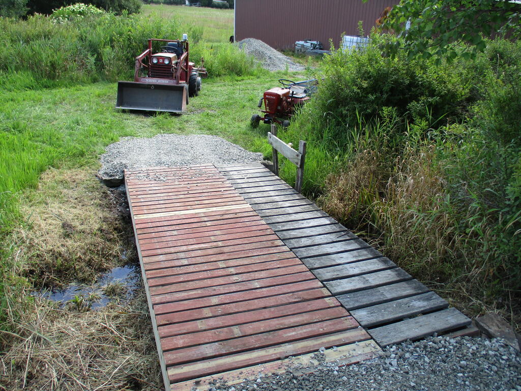

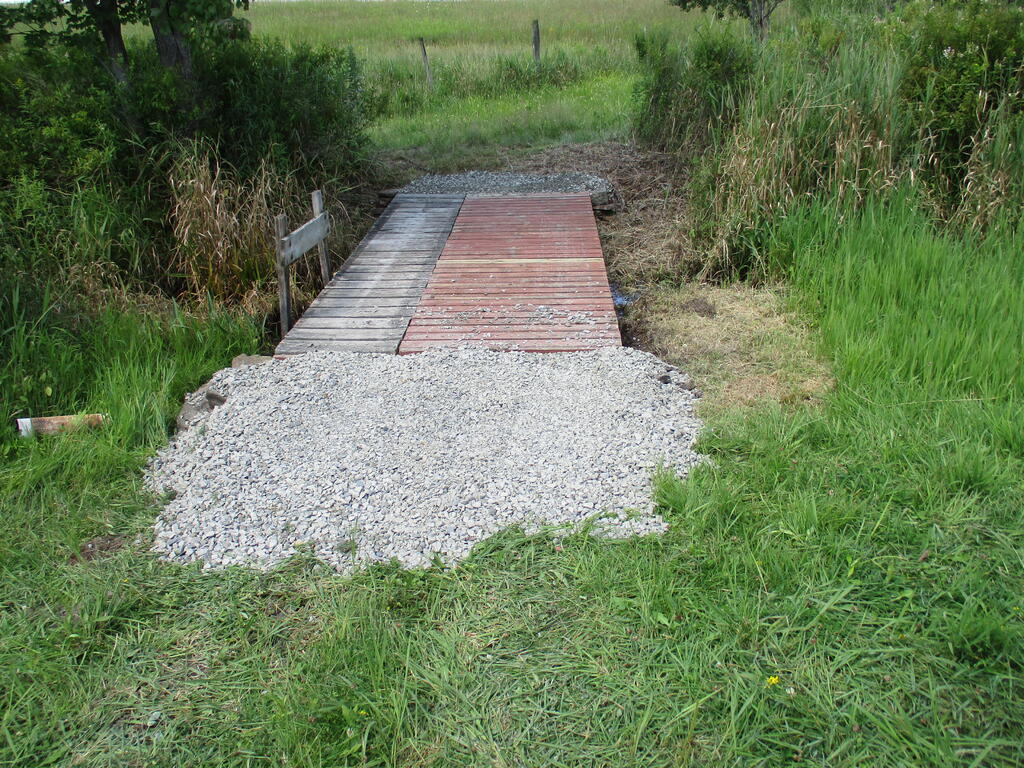

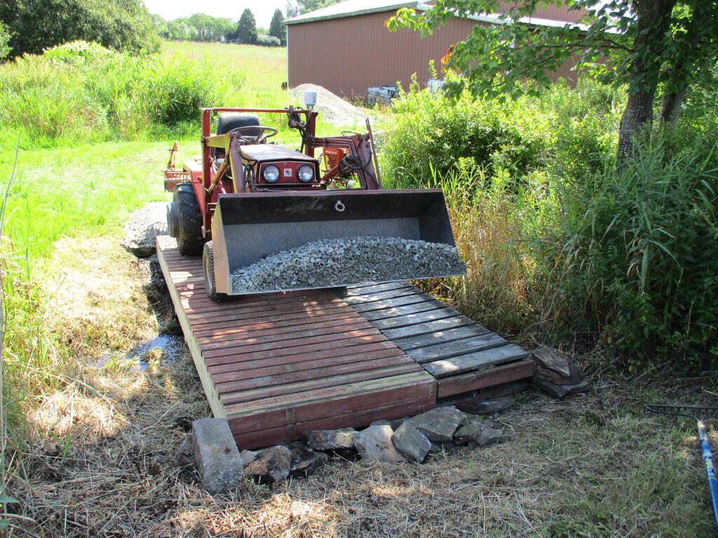

pfrederi 20,869 #1 Posted August 5, 2021 My biggest D200 and smallest L-107 Lawn Ranger, Wheel Horses have been working on an infrastructure project the last two days. About 18 years ago I built a small bridge to allow us to walk over a small stream on one of our walking paths. Have wanted to make i bigger so I could bring a WH across or my M274 (Mule) when doing trail maintenance. Guess it was a success as it held up the D200 (1000lbs) FEL and York rake (+/-500) Wheel weights and rim guard (250) 1,750 total. Got the beams back before Covid and since then pressure treated for decking was too much $$. Then a neighbor put out big pile of pressure treated from his old deck he was having replaced...Jumped on that and now a bridge expansion 6 20 Share this post Link to post Share on other sites

8ntruck 9,048 #3 Posted August 5, 2021 (edited) Glad the bridge passed the load test. Would have created another project had the bridge not passed - how to remove the D200 from the stream that is entangled in bridge rubble. Edited August 5, 2021 by 8ntruck 1 4 Share this post Link to post Share on other sites

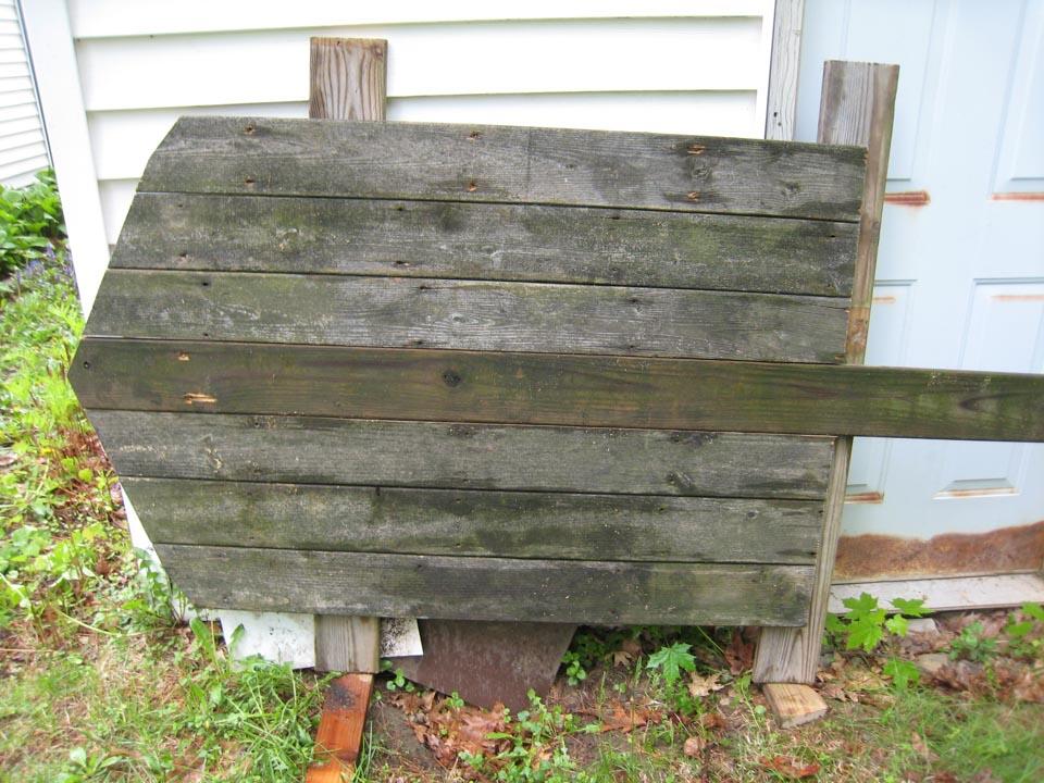

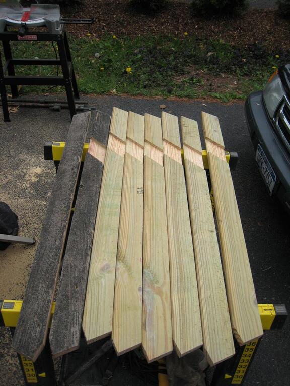

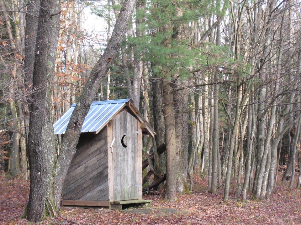

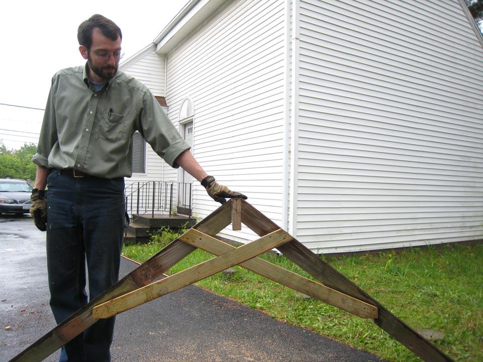

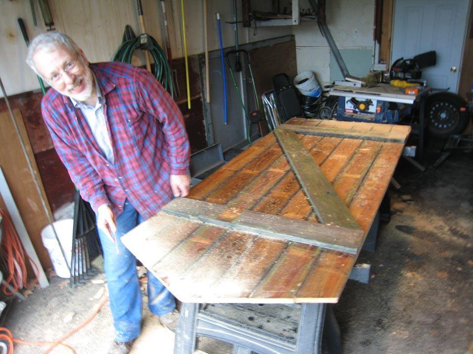

Handy Don 16,944 #11 Posted August 9, 2021 On 8/7/2021 at 7:15 AM, rjg854 said: got any Had to go dig them up from the archive! Here is a selection of them. We prefabricated the main components (walls, trusses, door, floor, etc.) in the garage of the deck donor to minimize construction time once we got to the camp. These are the walls ready to load on the truck. We sheathed them at an angle to fully use the 10' lengths without having joints in the sheathing and not have any short pieces left over. These are rafters cut for the trusses. We bought a couple new bits since the deck didn't yield quite enough material! This is a main truss for over the front entrance (4x4 rafters with 2x4 scissors) There is a scissor truss. These give a nice height and visual interest to the interior. Roof is metal panels over purlins on the trusses since there its in a place that routinely gets lots of snow (23' a couple of years ago). There are very tall people in the family who had to duck into the previous outhouse so a tall door was a requirement! It makes up most of the front wall. Screening fills the spaces above the door and between the roof trusses at the tops of the wall for ventilation and to impede bugs. Rear wall was pieced from the remaining bits. Lower portion is an access door for the annual spring "cleanout" (after over-wintering, the contents are essentially compost which gets spread in the forest). This is the result 2 2 1 Share this post Link to post Share on other sites
