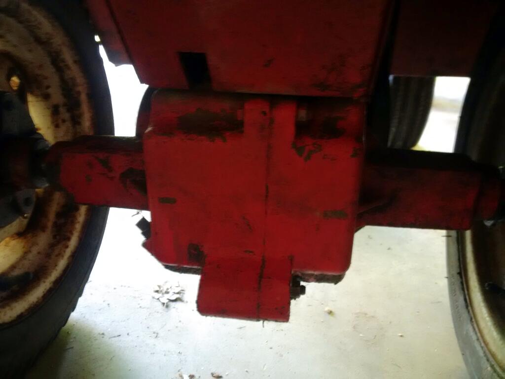

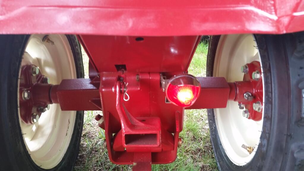

Uxtractor 8 #10 Posted August 5, 2021 Good day all , Back in now bought a new battery for the JD and now a a full time battery for the Wheel Horse ,this is what the rear of the transaxle looks like ,all I want to do is mount a 2 inch ball so I can pull my small lawn trailer it is about 3 x 4 feet . So if I understand right I first need a bracket to attach to the tractor then slide in a flat bar with ball attached ? Sorry for confusion but neither mine nor my friends have anything . Bad time as we have no out door auctions or shows that I know of and our local Wheel Horse man passed away couple of years back . Might have to get something simple fabbed up .Thanks Mike 7 hours ago, ebinmaine said: Mike I change mine over to a bolt on style and I've probably got at least one of the factory Wheelhorse hitches around. First question that comes to mind is, what are you looking to pull with them? Share this post Link to post Share on other sites
ebinmaine 81,282 #11 Posted August 5, 2021 39 minutes ago, Uxtractor said: Sorry for confusion No worries there. We're here to help. I'll get a pic or 2 of a set-up here. My Honey has a hitch like Jim's above. I also have the later design which is basically a U shaped bracket with a tab welded to it. You can get 1-7/8 or 2" trailer balls online that have a smaller than " road usage" mounting thread. Normally used on ATVs. 2 Share this post Link to post Share on other sites

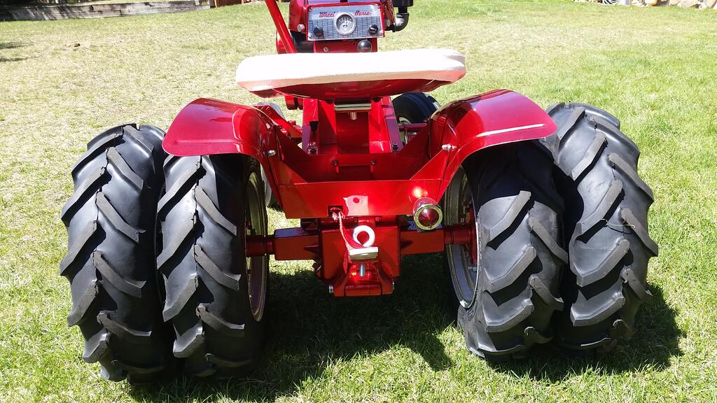

gt14rider 1,291 #14 Posted August 6, 2021 Light duty. 3 Share this post Link to post Share on other sites
ebinmaine 81,282 #15 Posted August 6, 2021 1 hour ago, Uxtractor said: hitches 32 minutes ago, gt14rider said: Light duty. The hitch is posted above are what I have. Excellent picture. Thank you Gt14 rider. Those will get you by perfectly fine for pulling loads up to maybe 200 lb, 300 lb. 1 Share this post Link to post Share on other sites
Uxtractor 8 #16 Posted August 6, 2021 Thanks GT 14 Rider that looks the part ,great find I will save the photo for future reference .That would do nicely for the little trailer and light yard work Excellent ! Cheers Mike Share this post Link to post Share on other sites

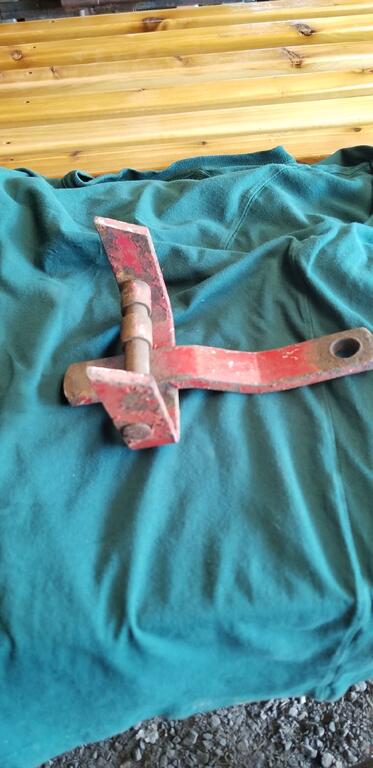

Geoff Cornwall 75 #20 Posted August 20, 2024 This is a slot hitch i made with information given to me by some of the kind people on this site . Geoff 1 5 Share this post Link to post Share on other sites
