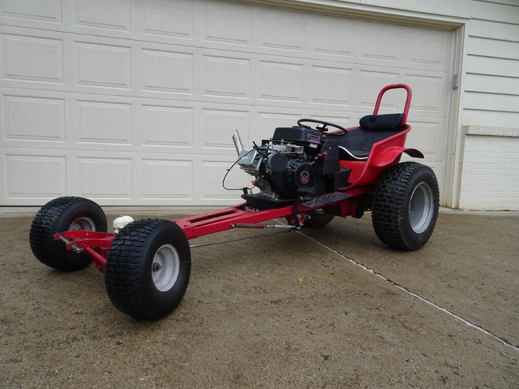

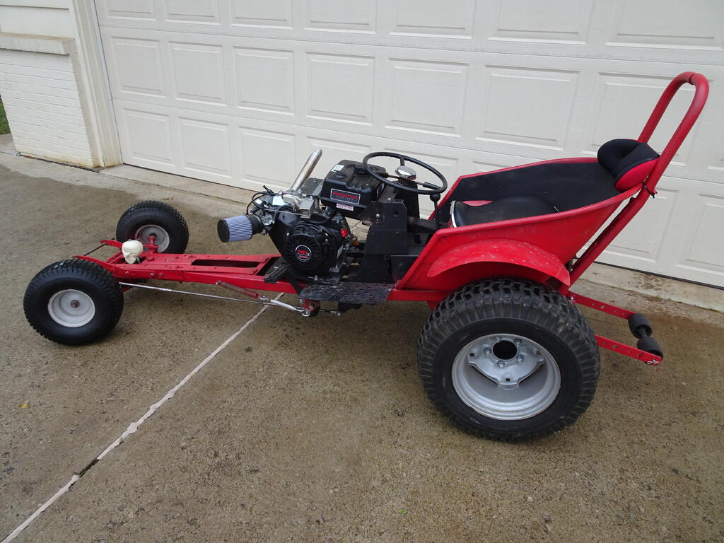

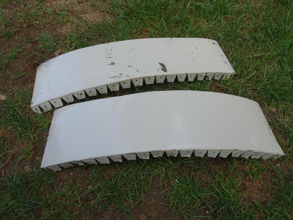

Pullstart 70,080 #27 Posted September 14, 2021 Did you just cut and hand shape those fenders Jon? They look perfect! Share this post Link to post Share on other sites

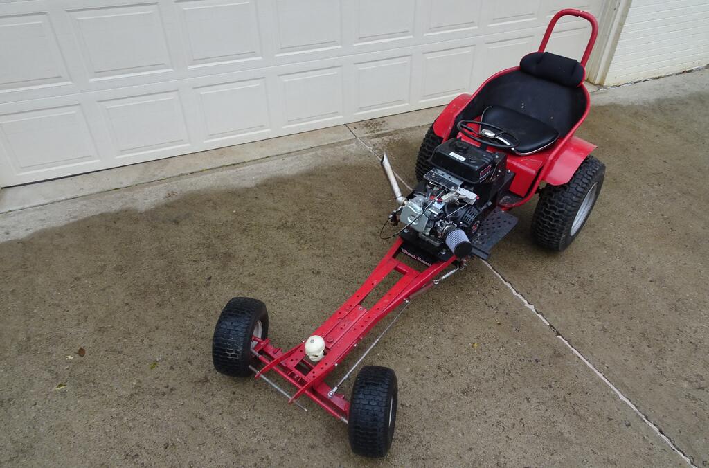

giddyap 1,574 #28 Posted September 15, 2021 22 hours ago, pullstart said: Did you just cut and hand shape those fenders Jon? Thanks for asking but I'm no fabicator. I do believe in sharing, for what its worth here is a photo of what I did. I salvaged the sheet metal from a water heater. Its very flimsey and easy to cut but with a rivet every inch the fender became solid after installation. There are a number of ways to make the sides uniform 2 Share this post Link to post Share on other sites
Pullstart 70,080 #29 Posted September 15, 2021 My eyes must have been playing with me the other day. Now I see what you’re saying, they’re riveted to the tub. Fabricator or not, you’re making another cool custom! 1 Share this post Link to post Share on other sites

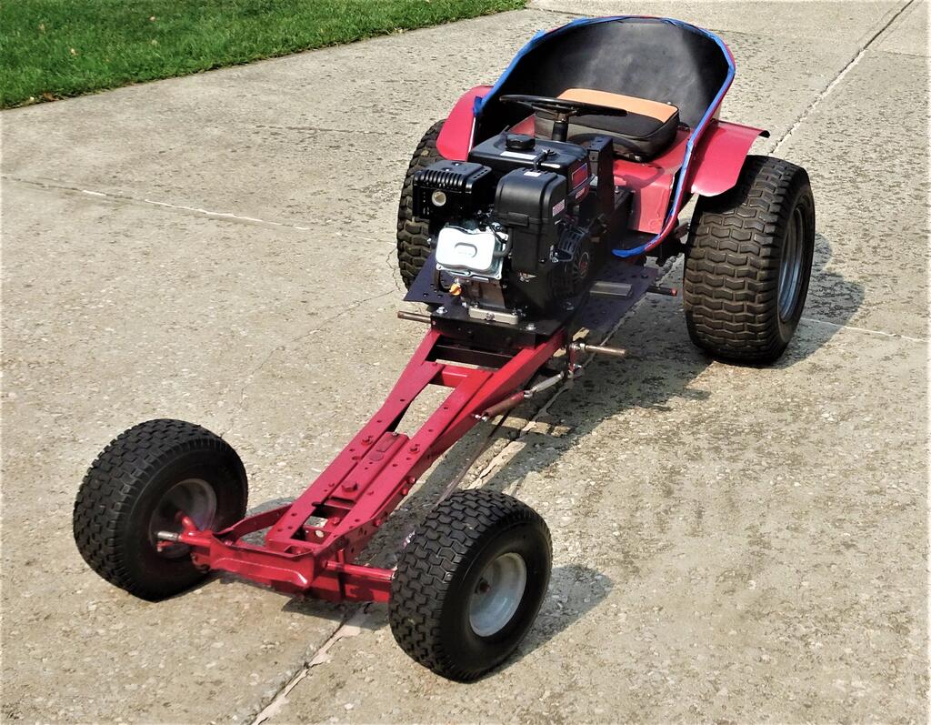

giddyap 1,574 #30 Posted September 17, 2021 First ride is in the books,...now burn the book After trying everything I know I could not stop or even slow the drive belt to get it in gear. I fiddled with differnt belt stops in diffent positions to no avail. The belt was very tight because I pulled the engine with a turnbuckle and now it is too loose. Since the engine tie down bolts are hard to reach. My next step is the remove the mounting plate with the engine bolted down and make slots in the plate. This will make adjusting the belt tension much easier. 3 Share this post Link to post Share on other sites
ebinmaine 79,106 #31 Posted September 17, 2021 2 hours ago, giddyap said: The belt was very tight because I pulled the engine with a turnbuckle and now it is too loose. Since the engine tie down bolts are hard to reach. My next step is the remove the mounting plate with the engine bolted down and make slots in the plate. This will make adjusting the belt tension much easier I like the sliding plate idea. I've found from past experience that there can be a VERY fine line when positioning an engine. 1 Share this post Link to post Share on other sites

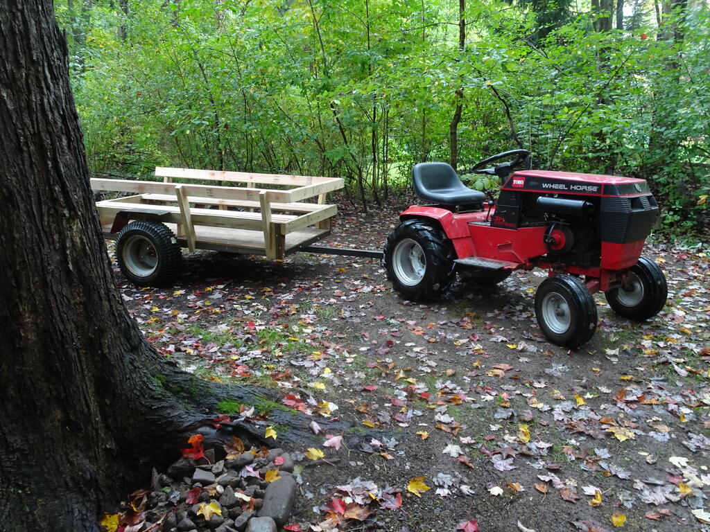

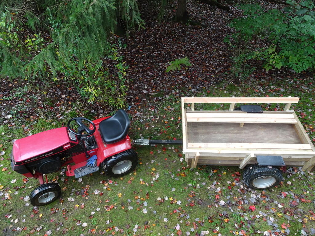

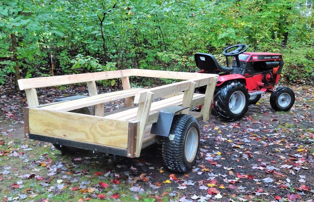

giddyap 1,574 #32 Posted October 3, 2021 My custom is within 1% of being completed but I had to put it on hold. With the comming of fall, I realized I needed to complete many of my summer projects around the house. Then with my daughter's birthday close to Halloween I thought the grandkids would enjoy a haunted hayride and so I fitted the trailor I made last year with benches. The 314-8 is new to me and will be used to push snow. 3 2 Share this post Link to post Share on other sites

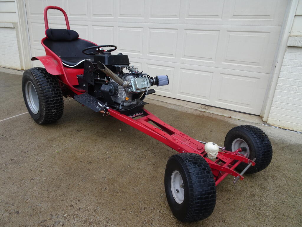

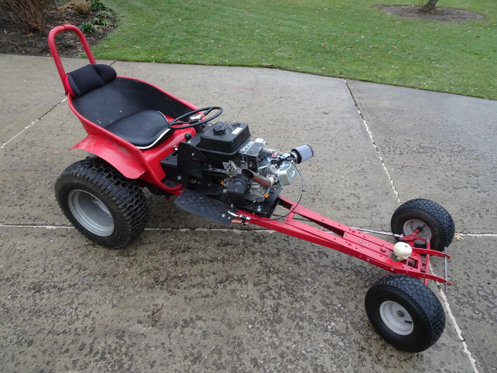

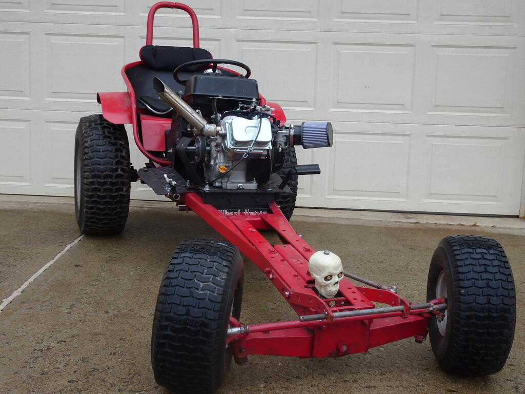

giddyap 1,574 #33 Posted December 3, 2021 (edited) Final pictures of my completed custom, my 4th. The 301 Hemi was nothing like the 212. The governor could not be overriden, it had to be completely removed. I had to reinvent the throttle linkage all because I did not know how to join a couple of 212s, but now I know how. (looking for a new home) Edited December 3, 2021 by giddyap addition 3 3 Share this post Link to post Share on other sites

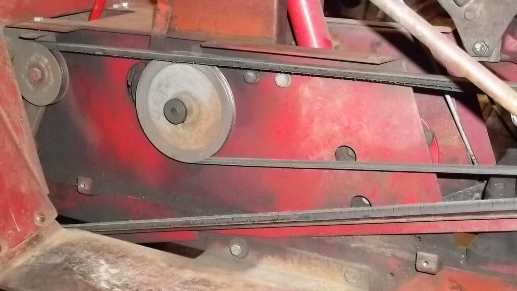

953 nut 66,513 #34 Posted December 3, 2021 On 9/17/2021 at 8:13 AM, giddyap said: After trying everything I know I could not stop or even slow the drive belt to get it in gear. Sorry I wasn't keeping up with this thread. You nerd to mount a piece of angle iron under the full length of the drive belt, with the clutch pushed in the slack of the belt will fall onto the angle iron and stop. Same concept as the belt guard. 2 Share this post Link to post Share on other sites
ebinmaine 79,106 #35 Posted December 4, 2021 1 hour ago, giddyap said: completed custom, my 4th As usual. Beautiful machine. 1 1 Share this post Link to post Share on other sites

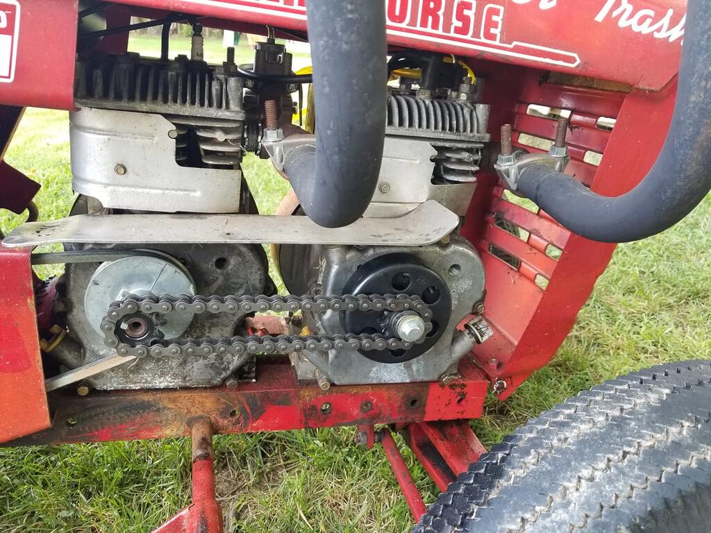

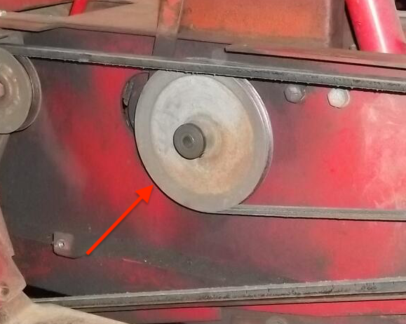

giddyap 1,574 #37 Posted December 4, 2021 55 minutes ago, 953 nut said: You nerd to mount a piece of angle iron under the full length of the drive belt, Here is a picture of the "stop belt" I used from "is this damper important" 2 Share this post Link to post Share on other sites
953 nut 66,513 #38 Posted December 4, 2021 10 hours ago, giddyap said: "is this damper important" It takes up some of the rapid movement of the spring when your foot comes off the clutch. As said previously, a piece of angle iron below the belt will solve your gear grinding problem. This photo is on a 953. Belt is slightly above angle iron when operating and slack is caught by it when the clutch is in. Share this post Link to post Share on other sites

Maxwell-8 4,371 #41 Posted December 4, 2021 12 hours ago, giddyap said: "is this damper important" nope, and a pleasure to be rid off... 1 Share this post Link to post Share on other sites
giddyap 1,574 #42 Posted December 5, 2021 8 hours ago, Maxwell-8 said: nope, and a pleasure to be rid off After I removed the damper from the clutch pulley the unintentional wheel stands stopped. At that time I also replaced the 6" tranny pulley with a 4" and shorter belt for a slightly faster tractor. But the new belt was slightly long and created too much chatter. So, today it went under a 2 hour operation to replace the orginal parts except for the damper. My 314-8 2 2 Share this post Link to post Share on other sites
