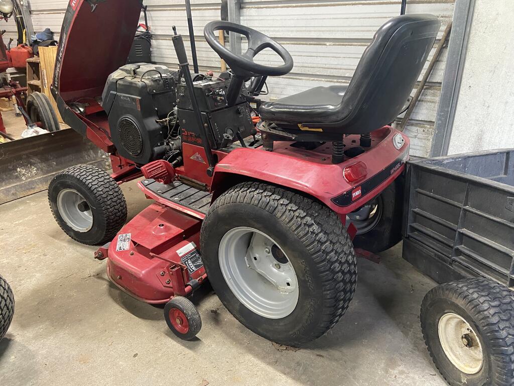

T-Mo-(Moderator) 4,849 #1 Posted July 31, 2021 Saw an ad on FB market place, it was only up for 18 minutes when I saw it. I immediately responded to it and picked it up a couple of hours later. It was only 40 minutes away. She also threw in a Rubbermaid cart, for free. It's in good to fair shape. I got it home and got it running. There are a few previous owner's mods - more on that tomorrow. I'll get more pictures tomorrow and find the year also. But for now, just a couple of pictures from the ad. 13 9 4 Share this post Link to post Share on other sites

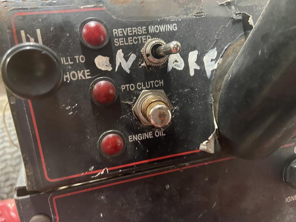

T-Mo-(Moderator) 4,849 #7 Posted July 31, 2021 More on this 314-8. First off, this isn't my first 314-8. Years ago I bought a 1998 314-8, kept it for a couple of years and ended up selling it to a missionary that was in Guatemala. His brother, who lived in Illinois, would make a couple of trips a year to Guatemala, with supplies and stuff to the mission down there. The missionary's parents had a Wheel Horse when he was growing up and knew they were good lawn tractors. They were using various Craftsman down in Guatemala and they wasn't holding up. I had my '98 314-8 for sale on CL and he saw the ad, and called me. Quite a shock to get a phone call from Central America. Anyways, I delivered the tractor to his brother in Illinois and it made it's way down to Guatemala. That was in 2009, so I haven't heard from him since. Now on this 314-8. The model number is 73449, making it a 1999. My '98 did not have the mow in reverse feature, this one does. But, it's probably been defeated. There is a push button switch to start it, a toggle switch that is serving as a kill switch. The ignition switch will turn on the ignition, but won't kill the engine. There is a key switch under the seat that seems to be a momentary switch...I have to research that to see if it's original, though I believe it's function is the mow in reverse key switch. There is a spring that retracts the clutch pedal - the dampener must be worn out and needs replacing. Lights work, but one taillight is missing. A little dent to the front corner of the hood. But, overall, the tractor is in decent shape. Sounds good, after I had to prime the fuel pump. Choke cable sticks a bit, and needs lubricating. Goes and drives in each gear. I hadn't tried the PTO yet, I will later today. The seller bought this house last year and the tractor came with it. The previous home owner showed the current owner how to start it (remember push button and toggle switches). But there it sat in the garage until I got there yesterday. I'm not sure what I'm going to do with it, but for the price I couldn't pass it up. Now for the pictures. 15 1 Share this post Link to post Share on other sites

evanloock 254 #10 Posted July 31, 2021 Key switch under the seat is for the mow in reverse operation. Share this post Link to post Share on other sites
