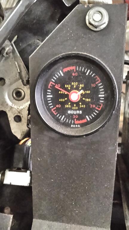

Bill D 3,020 #7 Posted August 9, 2021 Update: Got it to run with an IV tank. Drove it around the yard. Hydro feels good and strong. No leaks. Hydraulic steering is nice. Needs lots of TLC, fuel system work etc. Does anyone know how to read this hour clock? Thanks. Share this post Link to post Share on other sites
rjg854 13,244 #8 Posted August 9, 2021 I'm going to guess it has about 100 hours, and almost 50 minutes on it, if I'm reading it correctly. The only thing that's hard to tell is how many times it has turned over Share this post Link to post Share on other sites
Bill D 3,020 #9 Posted August 9, 2021 6 minutes ago, rjg854 said: I'm going to guess it has about 100 hours, and almost 50 minutes on it, if I'm reading it correctly. The only thing that's hard to tell is how many times it has turned over Thanks for the input. Based on the condition of the tractor it may have turned over at least once. Share this post Link to post Share on other sites
Handy Don 17,072 #10 Posted August 10, 2021 22 hours ago, Bill D said: Update: Got it to run with an IV tank. Drove it around the yard. Hydro feels good and strong. No leaks. Hydraulic steering is nice. Needs lots of TLC, fuel system work etc. Does anyone know how to read this hour clock? Thanks. The red sections are to remind the user of service intervals. Share this post Link to post Share on other sites
R Scheer 516 #11 Posted August 10, 2021 From a cub cadet forum. White hand shows the meter is working Red hand is for maintence, it makes a full cycle every 60 hours Yellow hand makes a full cycle every 600 hours. From your picture the Yellow hand is showing 110 hours. (Or maybe 710, or 1310, etc) 1 Share this post Link to post Share on other sites
