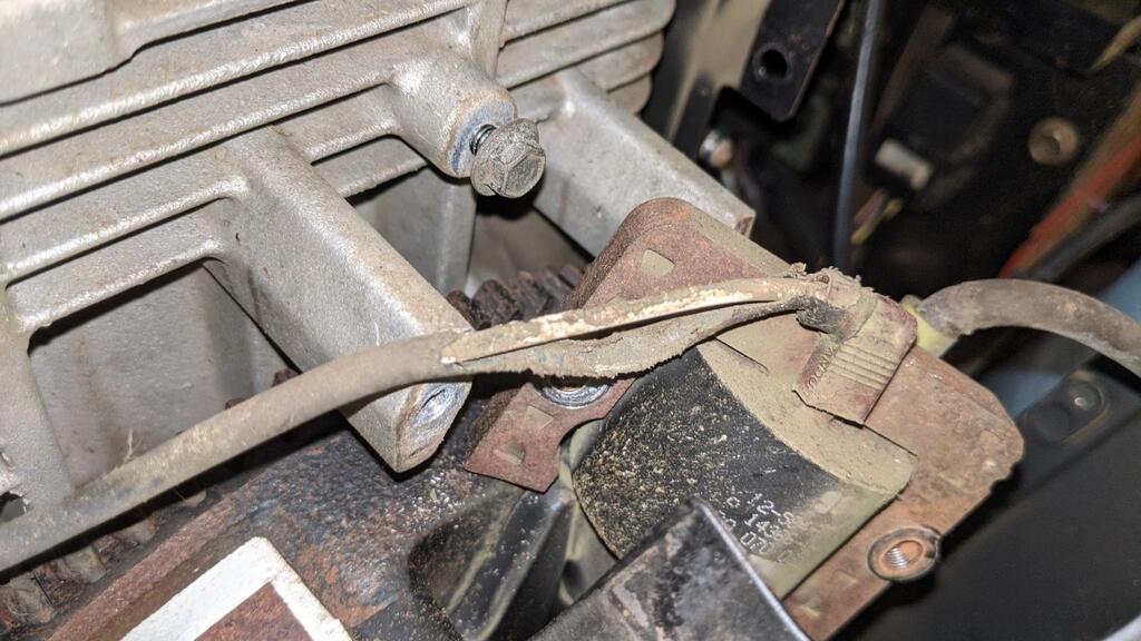

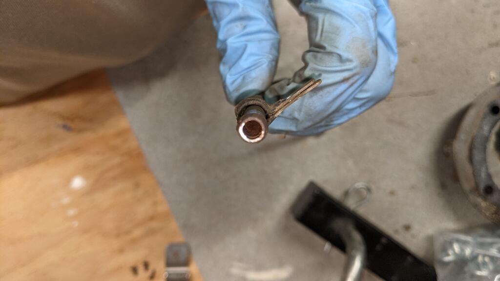

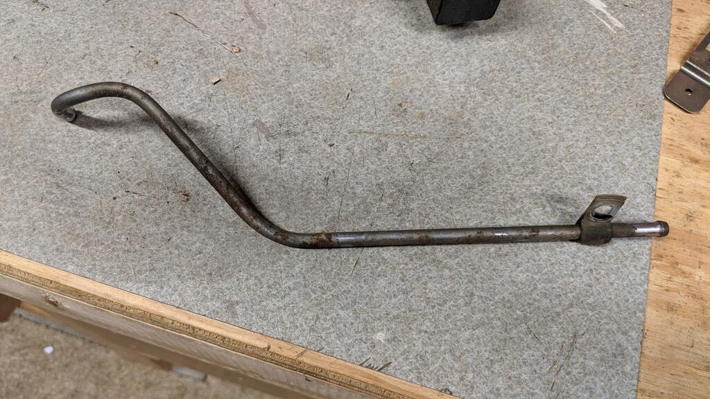

csvt99 173 #26 Posted August 20, 2021 Well I cleaned the tank and that went very well. Except for the part where my nozzle came off and fell in the tank. I almost had it out and then something happened and it disappeared in the the tank🤷♂️. Not sure what happened but I laugh and will worry about it another day😏. Meanwhile, the metal fuel line is pretty rusty in the one end. I would replace it but it doesn't look like they make the part anymore so I'm letting it soak in oil overnight. Pics are below. Also, check out the white wire leading from the ignition module. The insulation is hanging off and it looks like it could be damaged. Perhaps that was the cause of my problem all along.... Share this post Link to post Share on other sites
csvt99 173 #27 Posted August 21, 2021 The fuel valve coming off the tank was corroded pretty bad. I have all new parts on order, entirely new fuel system with clear line, 2 filters, new pump, plus the ignition lead which looked to be in bad shape. I had to reuse the metal fuel line going through the engine cover, and I will also touch up the carb but it looks really clean. Also got a new set of blades. Should hopefully have her back up and running next weekend. 1 Share this post Link to post Share on other sites

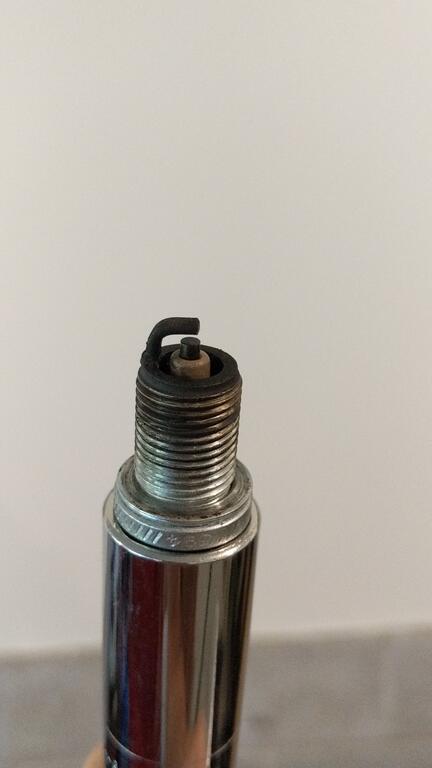

csvt99 173 #31 Posted September 6, 2021 Update. I had the battery tested and it tested bad, or so they said. It was manufactured in 2018. So I replaced it. Popped off just fine this morning. I ran in outside a bit, let it idle for about 5-10 minutes. I set my ramps up in my garage preparing to change the blades, and now it won't start. Turns over but just won't start .It is behaving exactly as it did before the new battery and fuel system. It seems like perhaps it's not getting fuel, however I can see it being sucked up through the clear fuel line and filter when it cranks. I just replaced the plug a few weeks ago when the issues first began which is gapped per spec 0.040. I checked the plug per attached photo. Any other ideas? Plug wire? Share this post Link to post Share on other sites
csvt99 173 #32 Posted September 9, 2021 I replaced the ignition module today. This seems to have fixed the problem. My suspicion is the contact metal on the spark plug wire was bad. I will need to go through a couple of start cycles and mow at least once or twice to verify so fingers crossed. If this doesn't work I will be replacing the oil sensor next. Share this post Link to post Share on other sites
