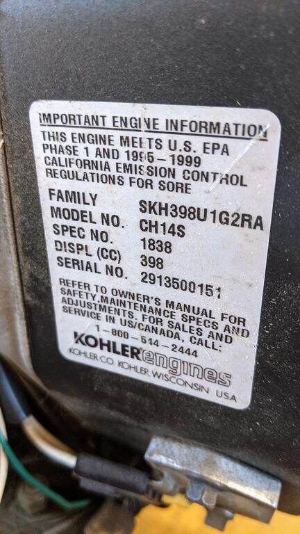

gwest_ca-(File Mod) 12,489 #3 Posted July 30, 2021 Late 1990's will be some form of magneto ignition which requires no battery power. Need to know the tractor model and serial number or the engine model number and spec number. Garry Share this post Link to post Share on other sites
csvt99 173 #4 Posted July 30, 2021 I'm not at home but I do actually have a picture of the engine tag... Share this post Link to post Share on other sites
gwest_ca-(File Mod) 12,489 #5 Posted July 30, 2021 Engine made in 1999 so tractor model is 1999 or later. Garry 1 Share this post Link to post Share on other sites

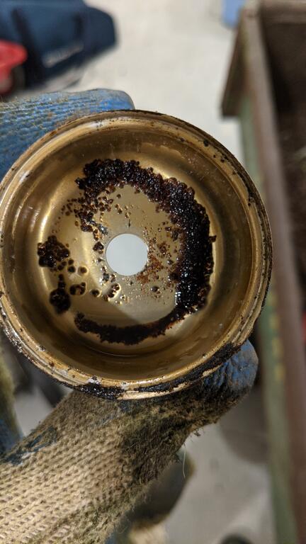

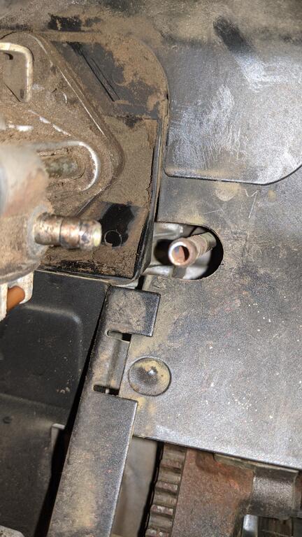

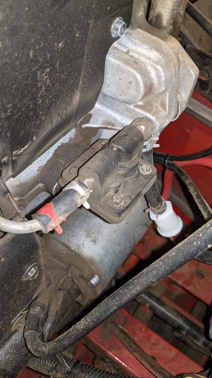

csvt99 173 #15 Posted August 10, 2021 Check out the bowl. There is definitely gunk in there and it seems the steel fuel line could be rusty. Also, what is the black apparatus the fuel line enters after the fuel filter and could that be a source of the dirt? I also checked the fuel tank and it seems fine. I will probably be replacing the whole fuel line as I will likely have it all apart, as long as the parts are easy to get. Thanks! Share this post Link to post Share on other sites
Gregor 4,848 #16 Posted August 10, 2021 On 7/30/2021 at 7:45 AM, csvt99 said: Oil level is over full, so it shouldn't be that. I would check that again. How much over full? Motors are not known for producing oil. I am not familiar with this tractor at all. Would it be possible to replace ALL fuel lines with (quality) rubber hose? Clean the carb a good as possible. The "black apparatus" is a fuel pump, and my very well be failing. Share this post Link to post Share on other sites
953 nut 69,473 #17 Posted August 10, 2021 9 hours ago, csvt99 said: Also, what is the black apparatus the fuel line enters after the fuel filter and could that be a source of the dirt? On 7/30/2021 at 8:45 AM, csvt99 said: Oil level is over full, That is your fuel pump and if the diaphragm is leaking some of your gas will be going into the engine oil diluting it. DO MOT run the engine until the oil has been changed and the fuel pump replaced. I would suggest you use an electric fuel pump. Have you been running gas with 10% ethanol? That could be what has fouled up the fuel system. Use this site to find a station that sells ethanol free gas, https://www.pure-gas.org/. 1 Share this post Link to post Share on other sites

gwest_ca-(File Mod) 12,489 #20 Posted August 11, 2021 Here is the engine illustrated parts list https://www.partstree.com/models/ch14-1838-kohler-command-pro-single-engine-made-for-toro-14hp/ Here is the tractor ipl. Your tractor could also be a 2000 model so parts list for it in case there is a difference from 1999-2000. Garry Share this post Link to post Share on other sites
