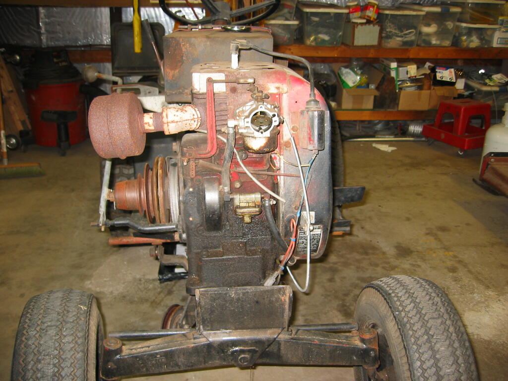

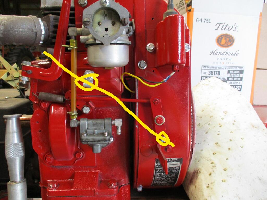

Chrishar 974 #11 Posted August 3, 2021 I was looking at the motor last night and found the governor is not hook up does anybody have picture how the throttle and chock cables and governor are hook up on the motor any information thanks Share this post Link to post Share on other sites
pfrederi 19,872 #12 Posted August 3, 2021 (edited) Wrong picture sorry Edited August 3, 2021 by pfrederi Share this post Link to post Share on other sites
pfrederi 19,872 #13 Posted August 3, 2021 Better pic Share this post Link to post Share on other sites
pfrederi 19,872 #14 Posted August 3, 2021 (edited) Throttle cable (yellow) comes under exhaust behind governor arm through the clip on the breather and to bottom end of rocker bar. Choke come up from under the air shroud Edited August 3, 2021 by pfrederi Share this post Link to post Share on other sites
Handy Don 15,910 #15 Posted August 4, 2021 5 hours ago, pfrederi said: Better pic A bit sloppy, but both look to be in the correct orientation. Share this post Link to post Share on other sites
Chrishar 974 #16 Posted August 4, 2021 Thank y'all for the pictures it was a good help for me I'll keep y'all posited on the progress im planning on using it to pull barrels rides round Share this post Link to post Share on other sites
pfrederi 19,872 #17 Posted August 4, 2021 11 hours ago, Handy Don said: A bit sloppy, but both look to be in the correct orientation. It was a before picture I took so I could remember what it was supposed to be. Second pic is same engine after overhaul. but it isn't installed yet. Share this post Link to post Share on other sites

Handy Don 15,910 #19 Posted August 5, 2021 On 8/4/2021 at 9:18 AM, pfrederi said: It was a before picture I took so I could remember what it was supposed to be. Second pic is same engine after overhaul. but it isn't installed yet. Makes sense. The "after" is looking good! Share this post Link to post Share on other sites
