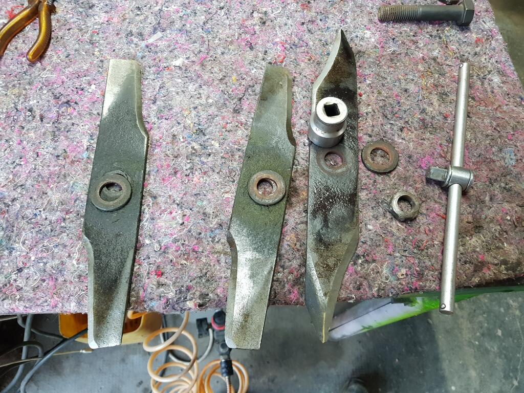

Andrea 20 #1 Posted July 29, 2021 Hello guys. My WH 210-4 has the cutting deck with the plate attached below. Is there a cross-section / diagram of this 3-blade plate? And above all ... this evening I removed the blades, but they have a particular shape. I think they are not original or have been badly sharpened to change their shape. Can you confirm that they are original? Many thanks in advance. Share this post Link to post Share on other sites
Jeff-C175 7,211 #2 Posted July 29, 2021 (edited) Those blades are well past their service life in my opinion! They most definitely should not be 'pointy' on the ends! https://www.minnesotaequipment.com/should-replace-lawn-mower-blades/ Edited July 29, 2021 by Jeff-C175 1 Share this post Link to post Share on other sites

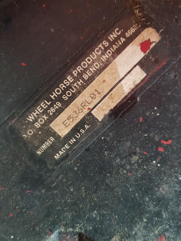

stevasaurus 23,802 #3 Posted July 29, 2021 Need @gwest_ca to come in and see if he can find the manual for your deck. I could not find it. I did find the manual for your 1988 Horse though. The E5-36RL01 is the correct deck for your model. Sorry, I could not be more help. Share this post Link to post Share on other sites
gwest_ca-(File Mod) 12,452 #4 Posted July 29, 2021 E5-36RL01 deck for 1988 210-4 is a good number but no info available. Suspect the 35-36RL01 is the same except for decals for Italy. The longer center blade is correct. Garry 1 Share this post Link to post Share on other sites
gwest_ca-(File Mod) 12,452 #5 Posted July 30, 2021 What is priced should still be available from Toro https://www.partstree.com/models/05-36rl01-toro-36-rear-discharge-mower-deck-1986/ Garry Share this post Link to post Share on other sites

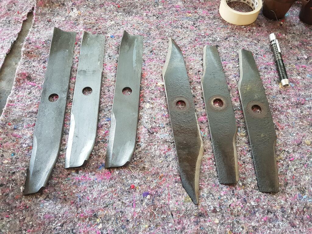

Andrea 20 #6 Posted August 12, 2021 DO you notices any differences ? thirty years of work and not feel them..... Share this post Link to post Share on other sites
Jeff-C175 7,211 #7 Posted August 12, 2021 2 hours ago, Andrea said: DO you notices any differences ? Sono cieco da un occhio, non vedo con l'altro, e vedo anche la differenza! Ciao! Share this post Link to post Share on other sites
