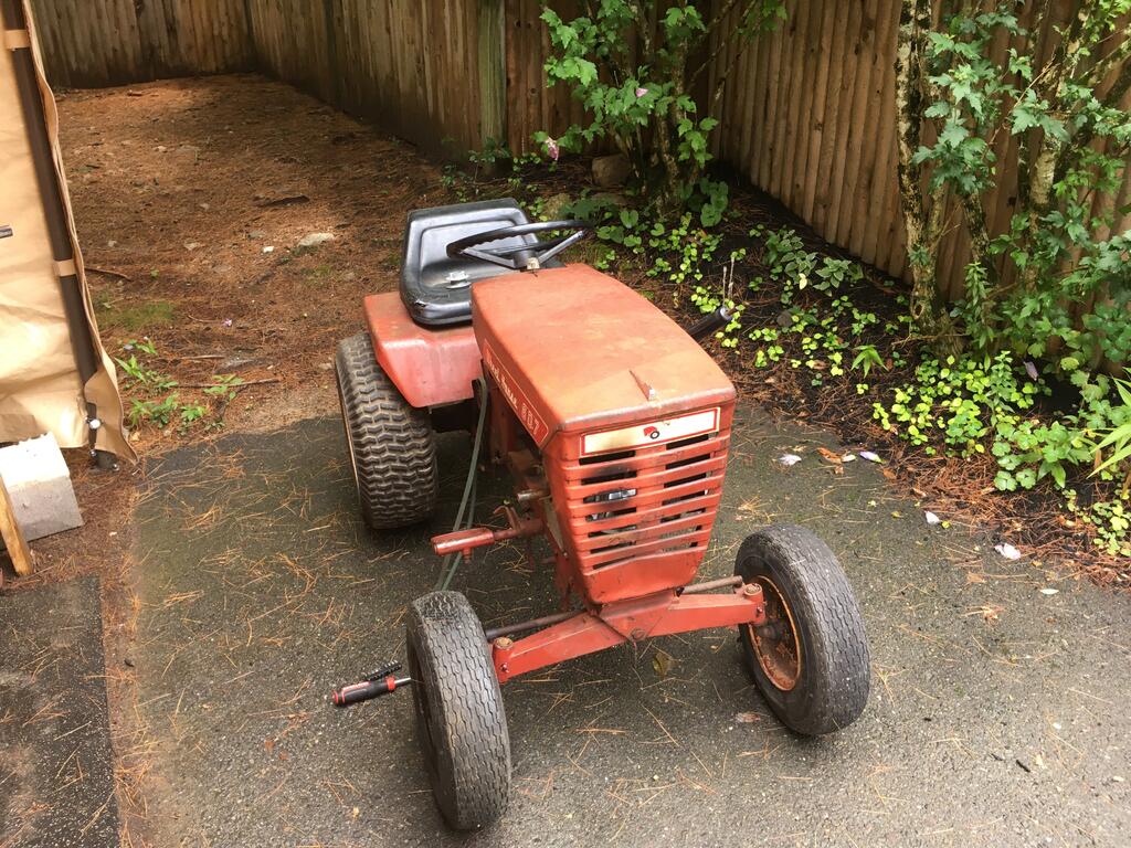

WheelHorse520H 710 #40 Posted August 8, 2021 GOOD NEWS: I just talked to the guy, I am going to pick it up Tuesday. It was in very nice condition. The paint is a little faded but nothing major. Pictures to follow. Thanks to everyone that helped me determine the value of such a nice piece of equipment. 2 1 Share this post Link to post Share on other sites

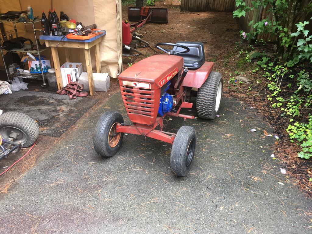

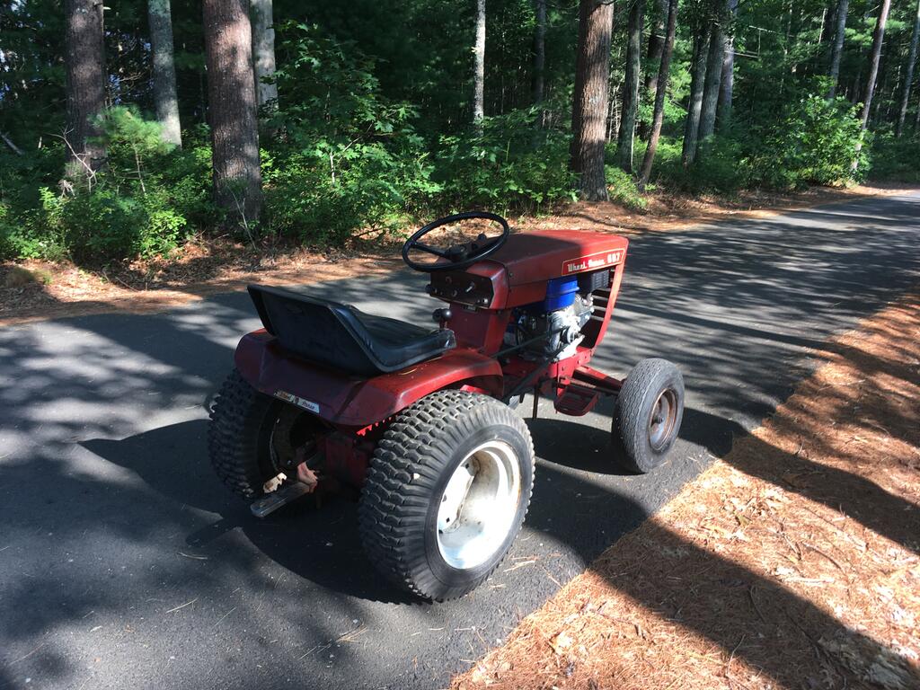

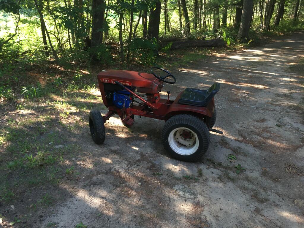

WheelHorse520H 710 #43 Posted August 22, 2021 (edited) On 8/9/2021 at 9:46 AM, WheelHorse520H said: Tomorrow I’ll have some when I get it home. I want pictures too. Sorry, I guess I forgot about you guys. Here are some photos of the new acquisition. It is currently getting some transmission issues sorted out but it ran within 20 minutes of getting it home. Edited August 22, 2021 by WheelHorse520H 2 1 Share this post Link to post Share on other sites

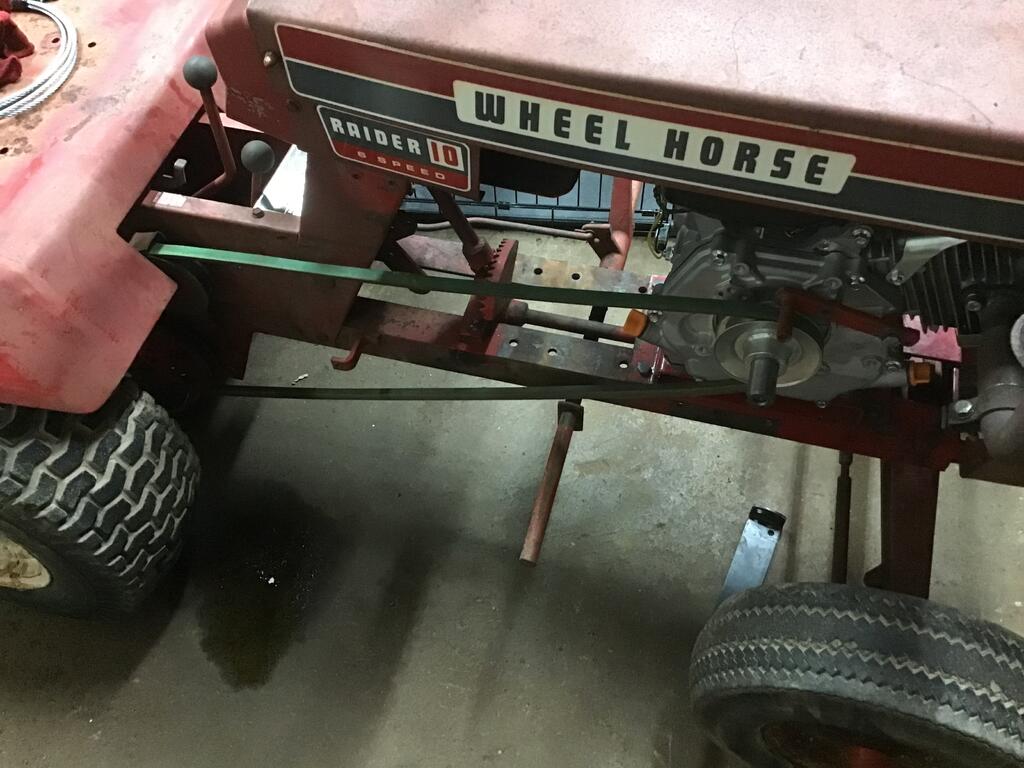

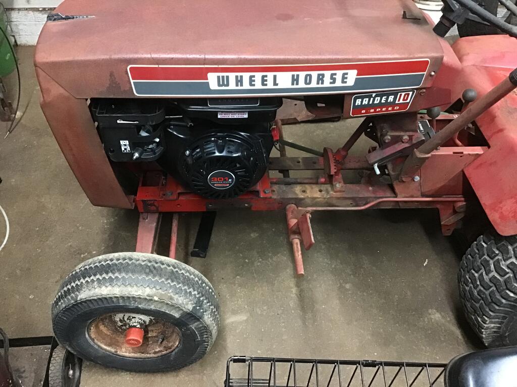

slim67 2,825 #45 Posted August 26, 2021 (edited) Doesnt the tang on the idler pulley help slow the belt too Steve? I did a 301 predator in a Raider 10 and can shift gears without the belt guard on. I had to move the engine to where it was just in the right spot for everything to work. I’m putting the guard back on too. Edited August 26, 2021 by slim67 2 Share this post Link to post Share on other sites
stevasaurus 23,848 #46 Posted August 26, 2021 The main function of the thingy on the tension pulley is to keep the belt from jumping off that pulley. Yes, it also would help to funnel slack, but with the help of the belt guard. The guard supports the belt across the bottom when the tension pulley is in the slack position. 1 Share this post Link to post Share on other sites
Snoopy11 5,731 #47 Posted August 26, 2021 5 minutes ago, stevasaurus said: The main function of the thingy on the tension pulley is to keep the belt from jumping off that pulley. Yes, it also would help to funnel slack, but with the help of the belt guard. The guard supports the belt across the bottom when the tension pulley is in the slack position. Might be an unnecessary comment, but it might help you or someone else... I also put a belt guard on my trans pulley to help things out... did wonders. You can see when you push the clutch in, there is a place right above the trans pulley where there is a lot of slack that pushes toward the back of the tractor. I found that by putting a belt guard above and back behind the pulley, it stops the belt a lot better than without. If anyone is interested, I will take pictures of what I did. Again for me, it did wonders!!! Don 2 Share this post Link to post Share on other sites
slim67 2,825 #48 Posted August 26, 2021 My guard is ready to go. Had to do a little modification but otherwise aok 2 Share this post Link to post Share on other sites
WheelHorse520H 710 #49 Posted August 26, 2021 1 hour ago, Snoopy11 said: If anyone is interested, I will take pictures of what I did. Again for me, it did wonders!!! I’d love to see some photos, I still need to get/make one. Share this post Link to post Share on other sites
