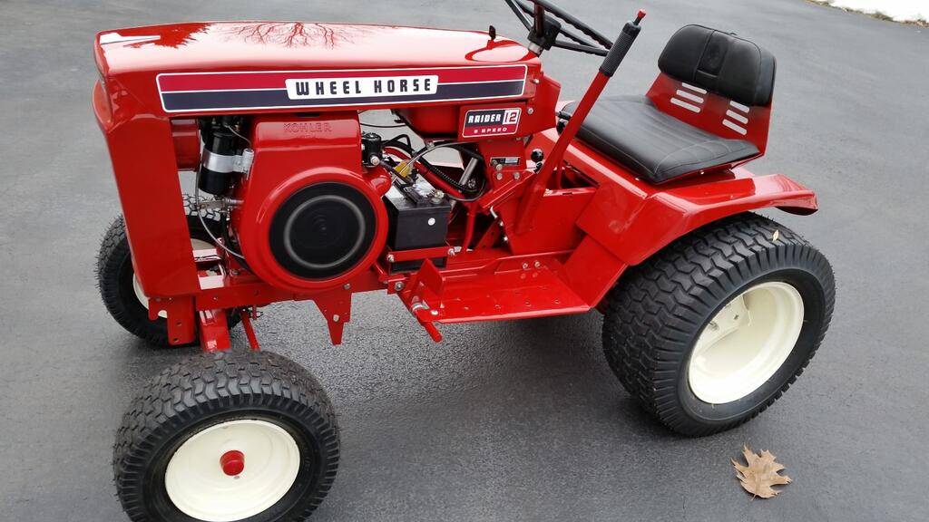

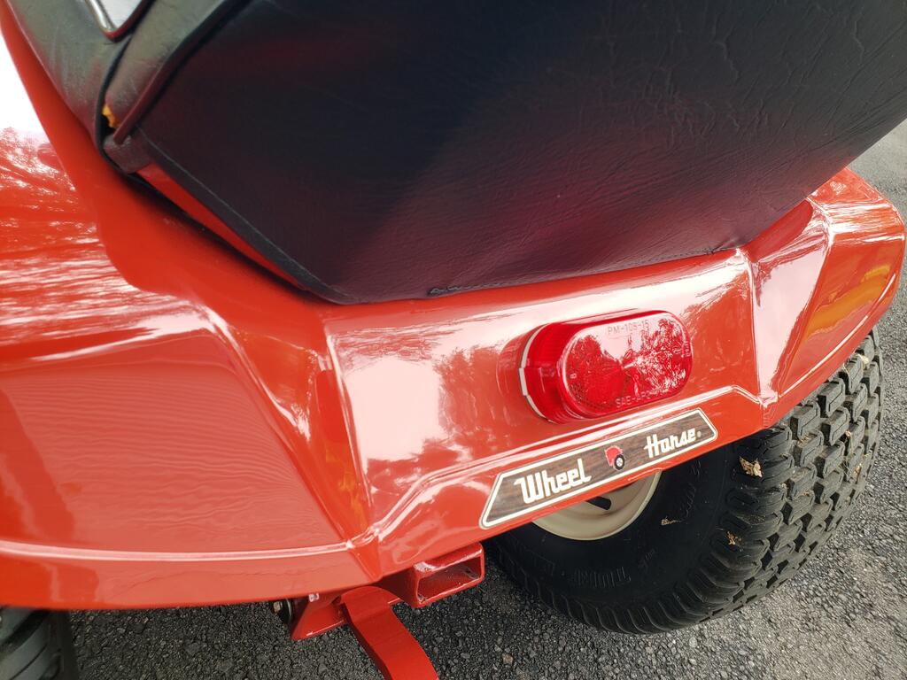

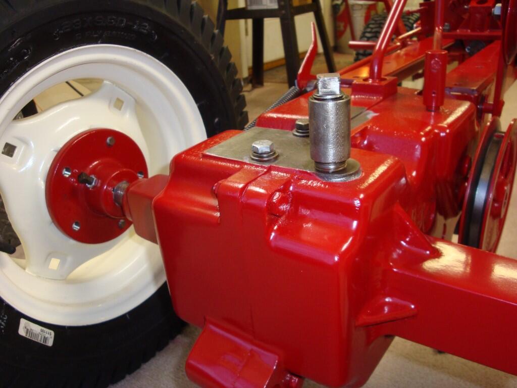

Zeek 2,310 #2 Posted July 25, 2021 (edited) I don't recall the ratio I used but I did exactly what he did with the exact same gun/filters. I used a better desiccant filter before the gun though. I used this rattle can primer in both gray and black so when I wet sanded it before paint I could see imperfections. I used this paint gun. If you want really make it nice, you have to multi-stage wet sand and three stage buff it afterwards. I used these polishing compounds because they work good, but you can probably find something cheaper. It's a lot of work, but it works. The below tractors were both done that way. They tend to chip easier unless you use hardener, but I guess it depends on what you are going to do with it. The prep makes a difference if you want no rust pits, casting marks or other imperfections showing. Other guys on here have used other methods as well that made for outstanding paint jobs, but I was answering your Rustoleum/rattle can question. Edited July 25, 2021 by Zeek 3 12 2 Share this post Link to post Share on other sites

Buckeyes 277 #4 Posted July 25, 2021 (edited) Zeek, That is one beautiful tractor! Outstanding job! Edited July 25, 2021 by buckeyes 1 Share this post Link to post Share on other sites
WheelhorseBob 1,550 #5 Posted July 26, 2021 Very nice indeed Zeek! I 1 Share this post Link to post Share on other sites

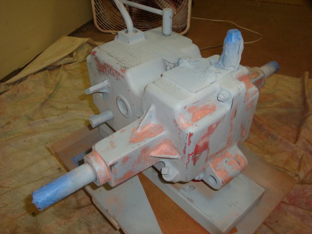

ebinmaine 81,047 #6 Posted July 27, 2021 @Zeek Beautiful work there!! Any special prep/grinding/filling on the transmission surface? Share this post Link to post Share on other sites
Zeek 2,310 #7 Posted July 27, 2021 11 hours ago, ebinmaine said: @Zeek Beautiful work there!! Any special prep/grinding/filling on the transmission surface? Yes, a lot of hand work. 1 1 Share this post Link to post Share on other sites
tom2p 2,396 #8 Posted July 27, 2021 2 hours ago, Zeek said: Yes, a lot of hand work. and the work shows - outstanding ! 2 Share this post Link to post Share on other sites
