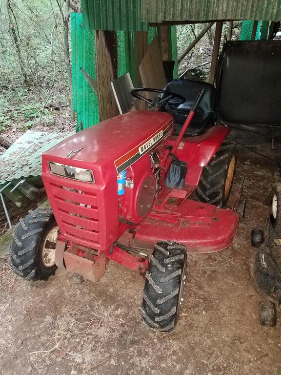

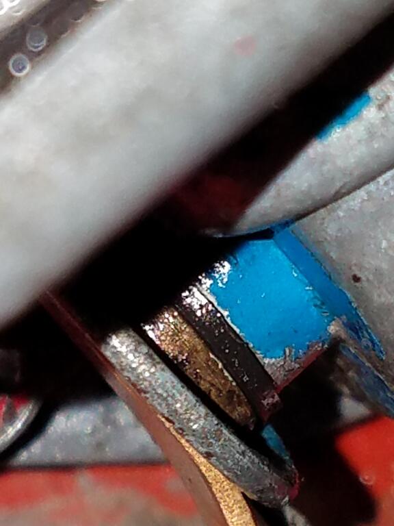

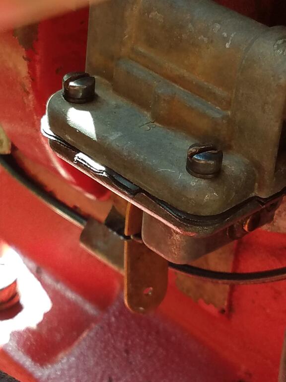

tntatro 181 #1 Posted July 24, 2021 Hello, I've managed to fix all the leaks on my K301 except the governor shaft area collects dust over time and the fuel pump always drops oil from the bottom of the lever. I think the lever might be a manual pump/primer, not sure, but does anyone know if it can be fixed so it doesn't leak oil? I put a new diaphragm in because it also leaked gas. It's hard to see in the picture but there is a drop of oil at the bottom of the lever. The pump has blue paint on it so I don't think it was originally from a wheel Horse. I'm considering getting a new pump but I hate to put a plastic one on. I was going to put an electric pump on but couldn't find a good place to mount it. Anyone ever had an oil leak from fuel pump problem and found a fix for it? Thanks, Tim 1 Share this post Link to post Share on other sites

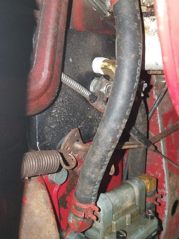

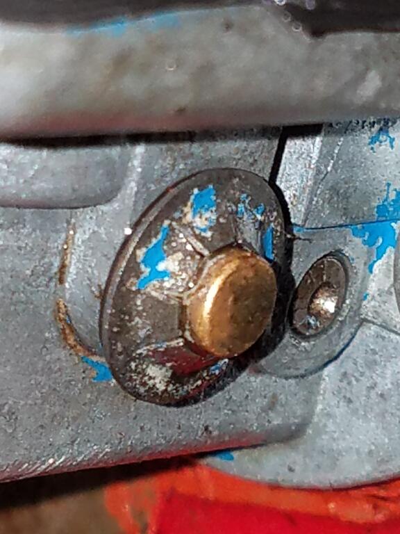

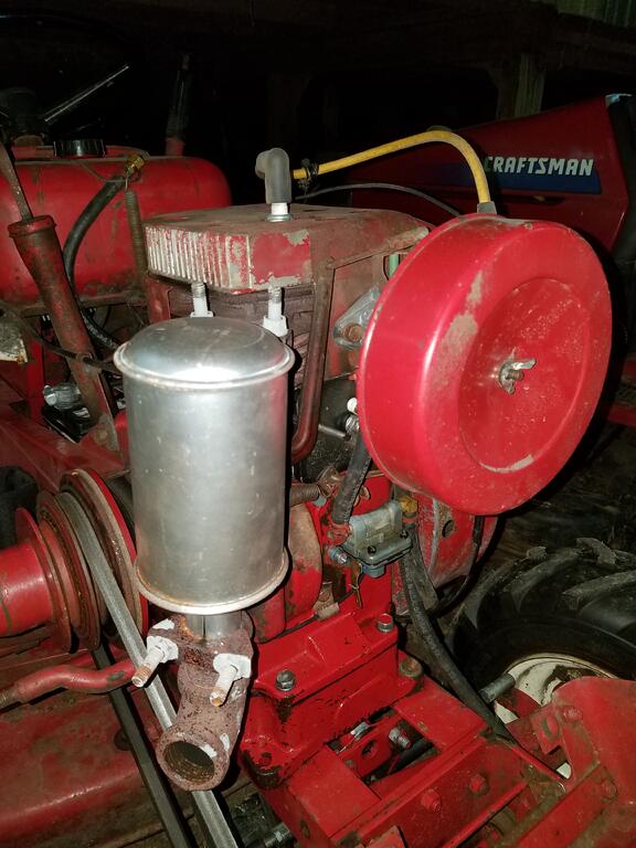

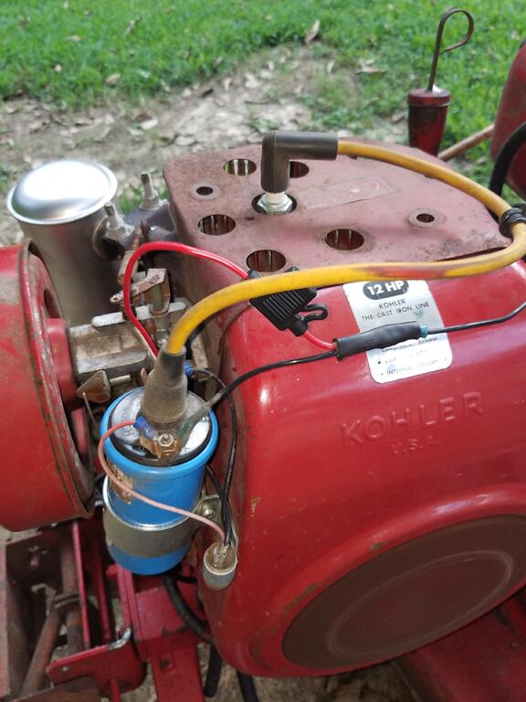

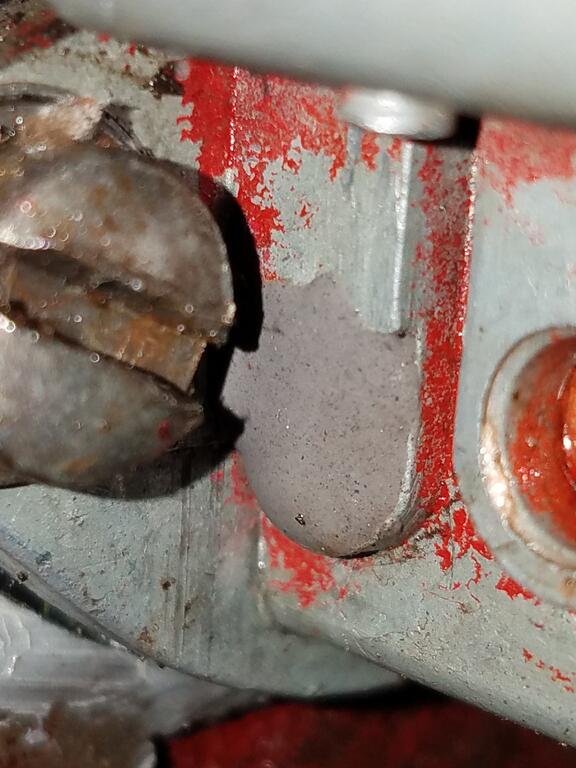

tntatro 181 #7 Posted July 25, 2021 I just checked the breather hose and when I start the engine it blows out air so it appears to be working alright. The pictures with blue paint are the fuel pump. On the side with the lever there appears to be a rubber washer and the other side has a push washer. I might be able to take that apart and put in new washers. I may even cover the pin holes with JB Weld. The third picture is a different fuel pump that I covered the pin with JB Weld because it was leaking. The last picture is the breather cover. It's hard to get a good picture of it. Share this post Link to post Share on other sites

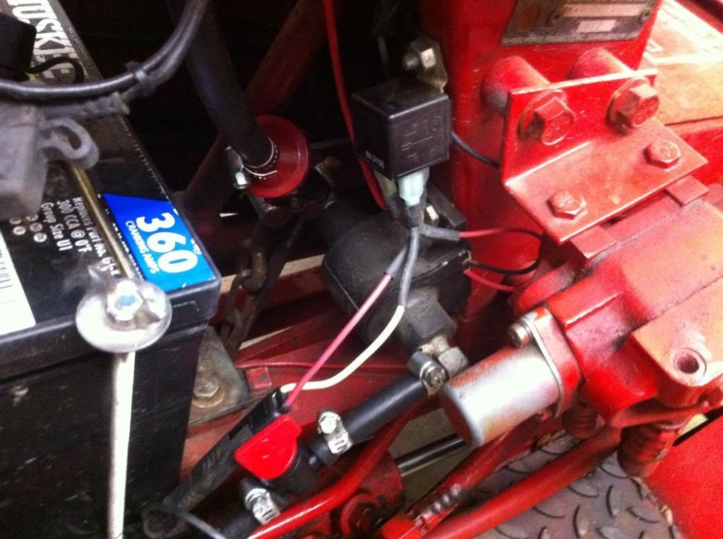

squonk 47,421 #9 Posted July 25, 2021 49 minutes ago, tntatro said: I'd like to put an electric pump on but there isn't a convenient place for one. This model has the gas tank under the hood. Here's mine on my C-160 1 Share this post Link to post Share on other sites

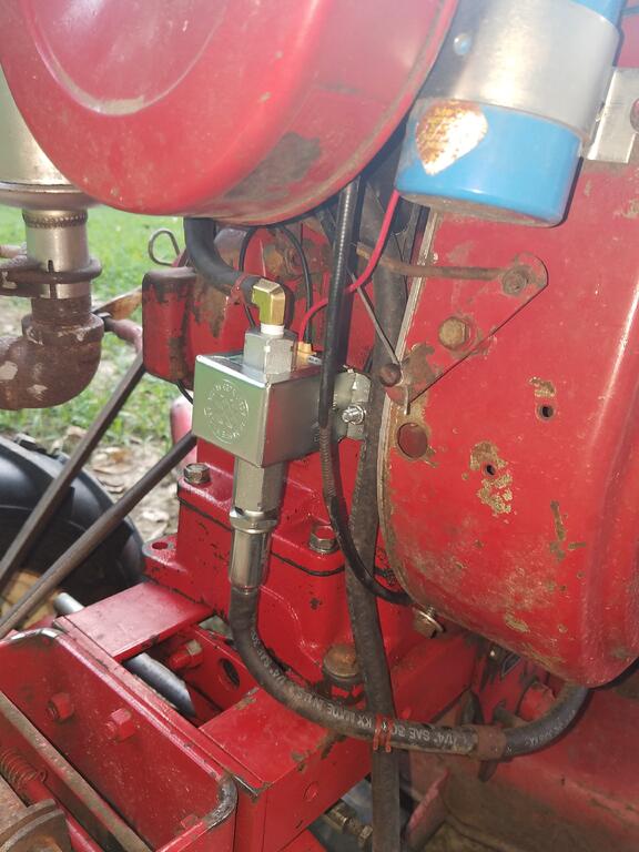

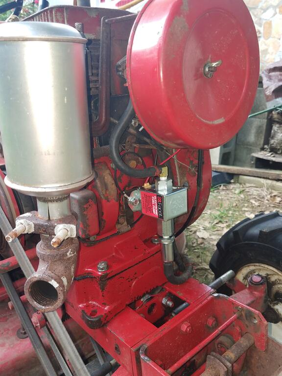

tntatro 181 #13 Posted August 5, 2021 Thanks for the help. I installed the electronic fuel pump today. I ended up making a small plate that attached over the hole for the original pump and attached the new pump to it. I'm still waiting for a 90 fitting so the line coming into the pump doesn't kink. I probably didn't need the fuel filter that attaches to the pump since there's already one in the fuel line but the directions for the pump said it was required. It would be a lot easier with just a 90 barbed fitting going into the pump. I also ordered a 1" copper street elbow to see if it will fit better on the exhaust and allow better air flow. 2 Share this post Link to post Share on other sites
