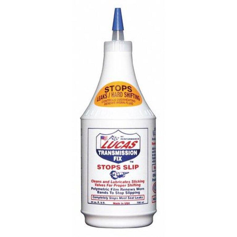

rmaynard 16,268 #1 Posted July 22, 2021 (edited) Has anyone tried this stuff in an older Sunstrand transmission? Just curious if it helps give new life to old hydros? Edited July 23, 2021 by rmaynard Share this post Link to post Share on other sites
953 nut 59,564 #2 Posted July 22, 2021 I tend to doubt it will do any good in a Sundstrand, there are no clutches like you find in an automotive transmission. 1 Share this post Link to post Share on other sites
daveoman1966 3,839 #3 Posted July 22, 2021 The ONLY way to get new life to the older hydros...rebuild them. For the Piston-to-piston units, rebuild Hyd Pump and Hyd Motor. For the even older Sundrans Hydrogear units, a refurb is mostly limited to the Hyd Pump. I have posted .pdf files...with pics...to aide in the overhaul of these. 2 Share this post Link to post Share on other sites

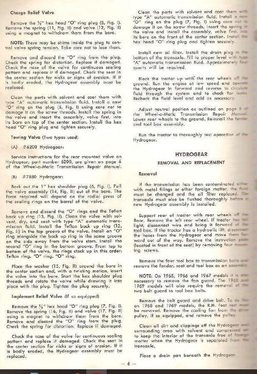

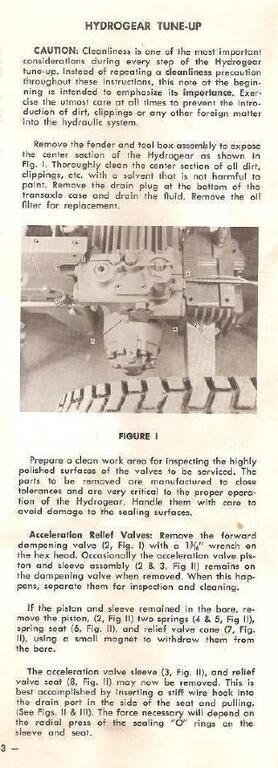

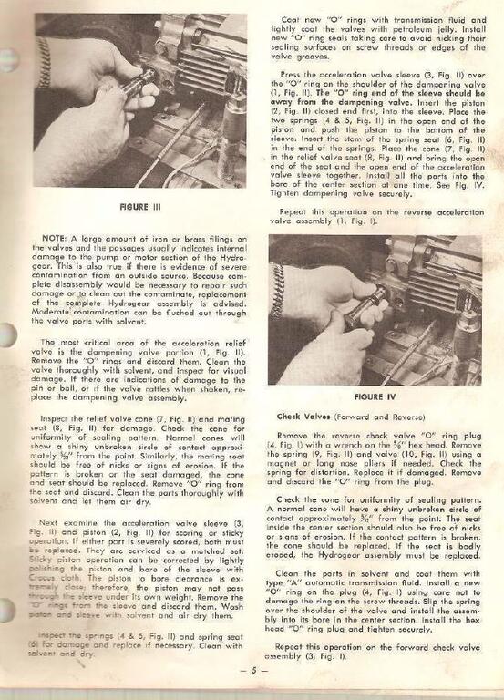

pfrederi 18,598 #8 Posted July 23, 2021 14 minutes ago, rmaynard said: @pfrederi the tranny has never had motor oil in it. Only Type-A fluid, Wolf's Head synthetic (red ATF fluid), and now the Castrol ATF (Dexron). Sorry misread you post thought Wolf's head was oil. Anyway, i run DexMerc In all 6 hydro gears no problems with any of them. Slowing down going up hills going faster down signs of old age. Good news is you probably only need a resurfacing. Even before that you might try the Hydrogear Tune up (about the only hydro gear repair WH mentioned.) 1 Share this post Link to post Share on other sites
