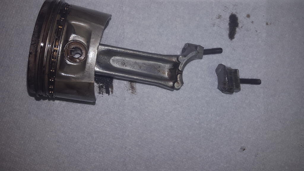

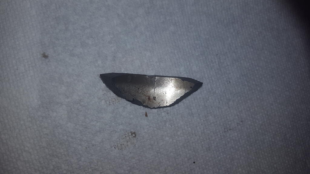

Gregor 4,848 #32 Posted July 27, 2021 I couldn't stand the suspense. I pulled the heads. While facing the carburetor side of the motor, the piston on the right side, does not move. I don't know how you break a rod, turning the motor with the starter. 3 Share this post Link to post Share on other sites
Gregor 4,848 #33 Posted July 27, 2021 Back surgery at 10AM, Home at 4 PM, The wonders of modern medicine. All went well, obviously. I guess I can assume by the lack of response, no one else can figure how how to break a rod (I'm assuming anyway) by cranking a motor with the starter. Before the break, I turned this motor over several times by hand. I also turned it several times with the starter, with no issues. I am still at loss for an explanation. Maybe I will find more when I open it up. Unfortunately, that probably won't happen for several days. I have orders from the general. 1 Share this post Link to post Share on other sites
Jeff-C175 7,209 #34 Posted July 27, 2021 7 minutes ago, Gregor said: no one else can figure how how to break a rod (I'm assuming anyway) by cranking a motor with the starter. I think that the rod was already broken, and during the first attempts it was 'out of the way'. Then, during the cranking, the vibration moved it into a position to be struck by the other parts. That's my story, and I'm sticking to it! 2 Share this post Link to post Share on other sites
Jeff-C175 7,209 #35 Posted July 27, 2021 9 minutes ago, Gregor said: Back surgery at 10AM, Home at 4 PM, The wonders of modern medicine. All went well, obviously. Awesome news Greg! Heal well and quickly my friend! Share this post Link to post Share on other sites
Gregor 4,848 #36 Posted July 27, 2021 1 minute ago, Jeff-C175 said: I think that the rod was already broken, and during the first attempts it was 'out of the way'. I also thought of that, and it's the only logical explanation I can come up with at this time. May be why the engine was taken out in the first place. 1 1 Share this post Link to post Share on other sites

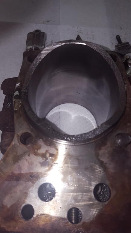

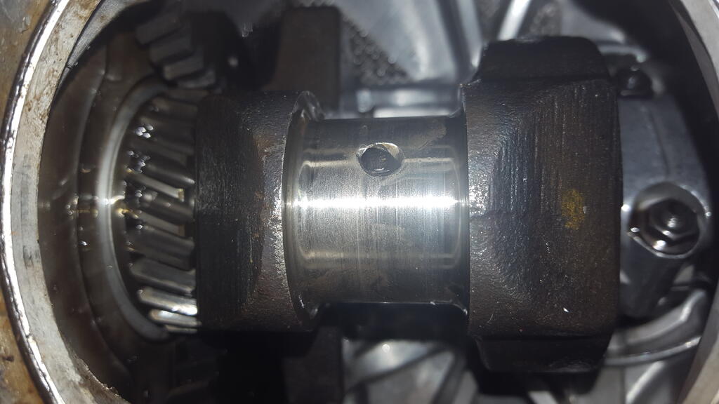

Gregor 4,848 #37 Posted July 28, 2021 I got up early. Nurse Ratchet, is still in bed. Allowing me some work time. Actually, I feel pretty good. A little sore, but that's to be expected. I did a lot of reading about the MV 16. again @pfrederi for the link! Then I tore into it. This motor has removable jugs, much Like some Lawn Boy motors, but I'm sure most of you know that. There are 6 nuts, and studs on each jug. Going into an aluminum block. I was not hopeful. They were pretty rusty and crusty, but to my surprise, they all came out. Except one of course. The nut had been rounded off some where along the line. I thought a 12 metric was going to do the trick, but nope. I ended up drilling two small holes in the side of the nut, and splitting it with a clod chisel. Then my 1/2" wrench took it right off. Sometimes ya get lucky. I pretty much followed the book as far as disassembly. Tagged, and bagged everything, down to the smallest screw, and took lots of pics. As I suspected, the motor has a broken rod on the right side. I can't tell if it's a recent break, or old. Everything is covered with oil. Doesn't matter, it's broke. The rod journal is pretty scratched up. I don't know .010 grinding will take it out or not. Unfortunately there is a chunk out of the cylinder wall. A bit hard to see at the bottom of the cylinder. I have yet to locate one of the rod cap nuts. I'm sure I'll find it when I split the case. Hopefully it didn't land on the cam, or somewhere, and cause damage. The cylinder wall on the left looks really good. A little shiny, but no scratching that a hone won't remove. Of course I haven't checked it, or valve guides with a bore gauge yet. Everything on the left side look very good. All the valves and seats look good to me, but I will let the machine shop make that decision, should this project go that far. I was able to locate a new jug for $350. Don't know if that will happen. If it were horizontal shaft, I might consider it, but for a vertical shaft, that I may never have a use for, that's a bit much New jug..............................$350 Rebuild kit..........................$285 Machine shop, (guess).......$400 Other incidentals.................$250 The next step is to remove the pan. This may not be easy, as there is a pulley on the shaft that appears to be quite content, with where it's at. It is a tin pulley, with no way to get a puller on it anyway. That's a lot of money just for a fun time, and a learning experience. Some say you can't put a price on a good time. They have never met my wife. 2 Share this post Link to post Share on other sites

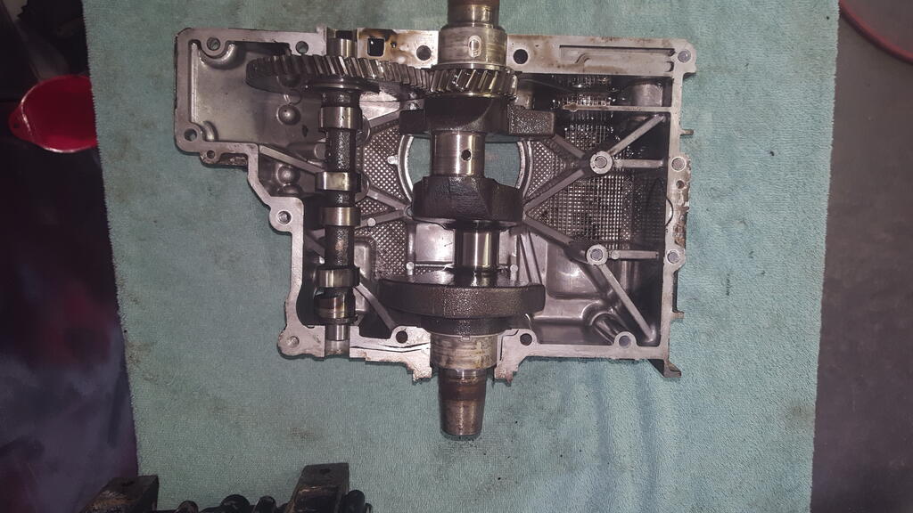

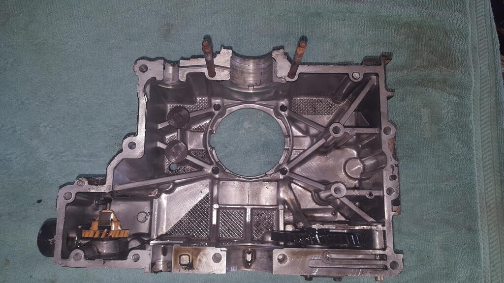

Gregor 4,848 #38 Posted July 28, 2021 (edited) I have taken it down as far as I intend to for now. I'm not real fast, but I am effective. I did not remove the governor shaft or gear. I see not reason to at this time. Unless someone tells me different. I did not remove the oil pump, cause there aint one. There is a gear for the oil pump, and maybe one could be added, . The rest of the motor looks very good inside. I don't know a lot about these things, but I believe would a machine shop have to check the block for cracks. (more costs) I marked the timing gears before ever separating them. I had to tap the through holes in the stator, and use my puller, but it came. I also drilled and tapped the tin pulley on the bottom, and was able to bend it down to get nuts on the back side, and was able to pull that, There was a collar above the tin pulley. No way to pull that, I sliced it as much as I could with a cut off wheel, scratching crank a little, and split it. Got it off. Apparently the MV 16 only had sleeve bearings on the crank. The rebuild kits I saw, don't even offer bearings. unfortunately all this is for a loss cause, if I can't find a new jug. I know there are some guys on here selling engine parts, but I don't remember who. Does Lincoln? Just called the machine shop. Cannot magna-flux an aluminum block. That makes sense. Edited July 28, 2021 by Gregor Share this post Link to post Share on other sites

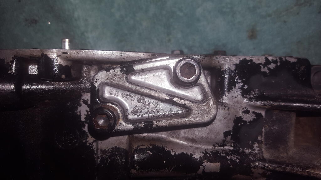

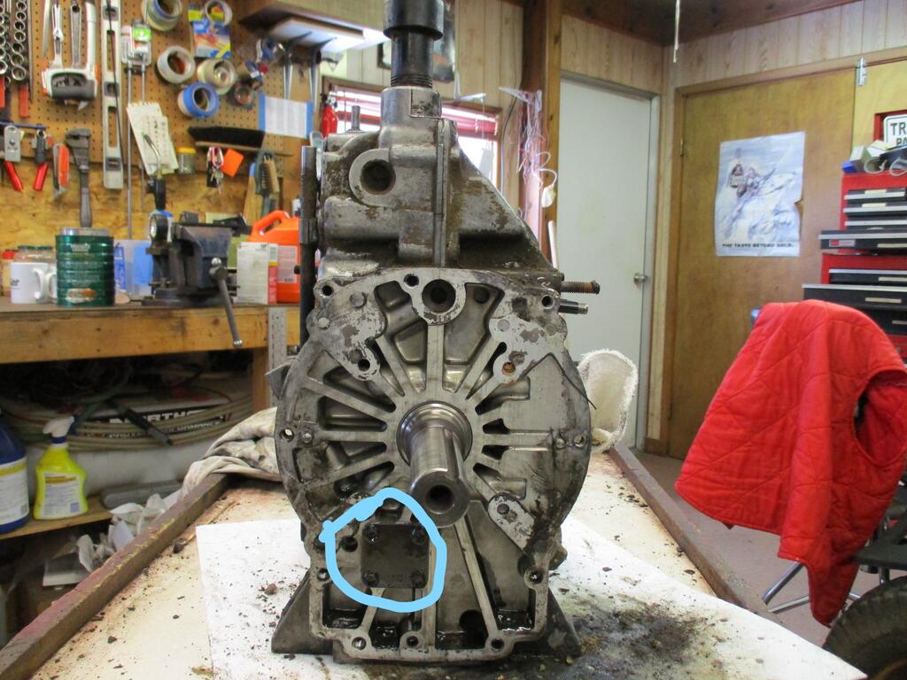

pfrederi 20,891 #39 Posted July 28, 2021 The oil pump is between the plastic gear and the small plate on the outside. manual said not to screw with it if it seemed to work. Share this post Link to post Share on other sites
Gregor 4,848 #40 Posted July 28, 2021 (edited) I stand corrected. After re-looking, and re-thinking, I believe you are correct. I saw this block off plate, and thought that's where the oil pump would go if it had one. I believe now, that is where the oil filter would go if it had one. I don't want to mess with it, or the governor, but, if I take this block to the machine shop for cleaning a checking, (visual inspection) I suppose both would have to be removed. I guess I don't know how they clean them. Edited July 28, 2021 by Gregor Share this post Link to post Share on other sites
pfrederi 20,891 #41 Posted July 28, 2021 This is a horizontal shaft magnum but the Vertical shaft manual shows the same plate and the same remarks about leaving it alone. Pump is behind the plate. You are correct the plate in your posture is for the oll filter mounting. 1 Share this post Link to post Share on other sites
Gregor 4,848 #42 Posted July 28, 2021 Hmmmm. Can I have a jug? Maybe I can trade these expensive muffers for a jug. We don't need no stinkin' mufflers ! I remember someone on here, talking about checking for cracks with carb cleaner. I sprayed the block half liberally with 2 cans of brake clean. Then I ran inside, washed my hands, arms, face.... Let it dry, and sprayed it with carb cleaner. Then I ran inside, washed my hands, arms, face.... I'll see if anything shows up. Maybe it doesn't work on aluminum, again, This is NOT the side with the plastic governor, and oil pump gear. Share this post Link to post Share on other sites

Gregor 4,848 #47 Posted July 28, 2021 There is one area in the right side block, that I suspected of being a crack. Sometimes it's had to tell a crack from a casting mark. It was easily accessible, so I sanded it with 220 grit, then 600. It went away. I cleaned the are well with brake clean, and sprayed it with carb cleaner, I'll see if anything shows up. I was going to take both halves to the machine shop, have them cleaned, and get their opinion. I could not get the phillips head governor screw out. # 1 phillips seemed to big, # 2 phillips seemed too small. All I did was round out the hole. 1 Share this post Link to post Share on other sites
