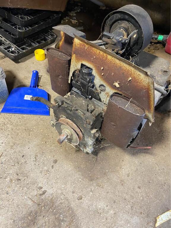

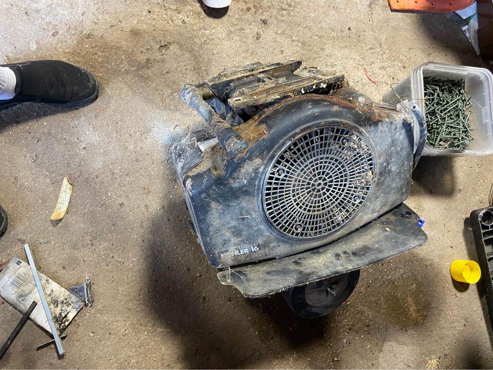

Gregor 4,848 #1 Posted July 22, 2021 Saturday morning I am going to pick up this motor. At least that's the plan. I don't have room for any more tractors, but I can still sneak in a few motors. I know nothing about it, other than it does turn over by hand. It has been sitting for a loooonnng time. Maybe it will run, maybe it won't. Maybe it will never run again, IDK, but for $50, I figured I could have $50 worth of fun, and learning experience on a twin. I don't know what that contraption is mounted to the PTO. Some sort of gear reduction? Anyone have a clue? 3 Share this post Link to post Share on other sites
953 nut 69,551 #2 Posted July 22, 2021 The engine appears to have been mounted to a vertival crankshaft application like a riding mower. I know that some people have made sucessful conversions to horizomtal crankshaft applications but I am not aware of any posts done on the subject. If it will run wellin a vertical position you could gather the parts needed to convert to horazontal later. 3 Share this post Link to post Share on other sites
Gregor 4,848 #3 Posted July 22, 2021 10 minutes ago, 953 nut said: The engine appears to have been mounted to a vertival crankshaft application After looking at the pics closer, I believe you are correct, That's a little disappointing, but not a deal breaker. Still looks like $50 worth of fun, that I will probably only have ~ $500 in when I'm done with it. 3 2 Share this post Link to post Share on other sites

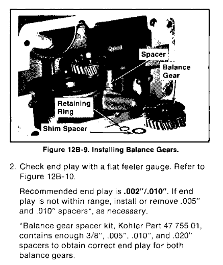

Gregor 4,848 #12 Posted July 23, 2021 If I am reading manuals correctly, this motor has balance gears. If I should have to open this motor up, can the balance gears be eliminated, as in a K series? Please say yes. Please say yes. Please say yes. Please say yes. Please say yes. 1 Share this post Link to post Share on other sites
pfrederi 21,175 #13 Posted July 23, 2021 Horizontal Magnum twins do not have balance gears. What is spec number of this engine, Then you can look it up and be sure. 1 Share this post Link to post Share on other sites
Gregor 4,848 #14 Posted July 23, 2021 1 minute ago, pfrederi said: Horizontal Magnum twins do not have balance gears. What is spec number of this engine, Then you can look it up and be sure. I won't have it until tomorrow. It is vertical shaft. 1 Share this post Link to post Share on other sites
pfrederi 21,175 #15 Posted July 23, 2021 7 minutes ago, Gregor said: I won't have it until tomorrow. It is vertical shaft. I doubt vertical vs horizontal would make a difference in having balance gears. The Vertical service manual i have to supplement the horizontal one didn't reference any ..but it was a MV-18 not 16... 1 Share this post Link to post Share on other sites
Gregor 4,848 #16 Posted July 23, 2021 This is the manual I was looking at. Maybe it's not the right one. I dunno. Guess I will have to wait until I get the numbers to really check things out. 1 1 Share this post Link to post Share on other sites
pfrederi 21,175 #17 Posted July 23, 2021 7 minutes ago, Gregor said: This is the manual I was looking at. Maybe it's not the right one. I dunno. Guess I will have to wait until I get the numbers to really check things out. That is for the singles. Completely different than the twins 2 Share this post Link to post Share on other sites
Gregor 4,848 #18 Posted July 23, 2021 (edited) 1 hour ago, pfrederi said: That is for the singles. Completely different than the twins Oh. Well, shows you how much I know. It said M16, I went with it. Guess I will have to search for another manual. Edited July 23, 2021 by Gregor 1 Share this post Link to post Share on other sites

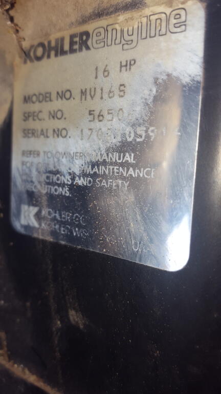

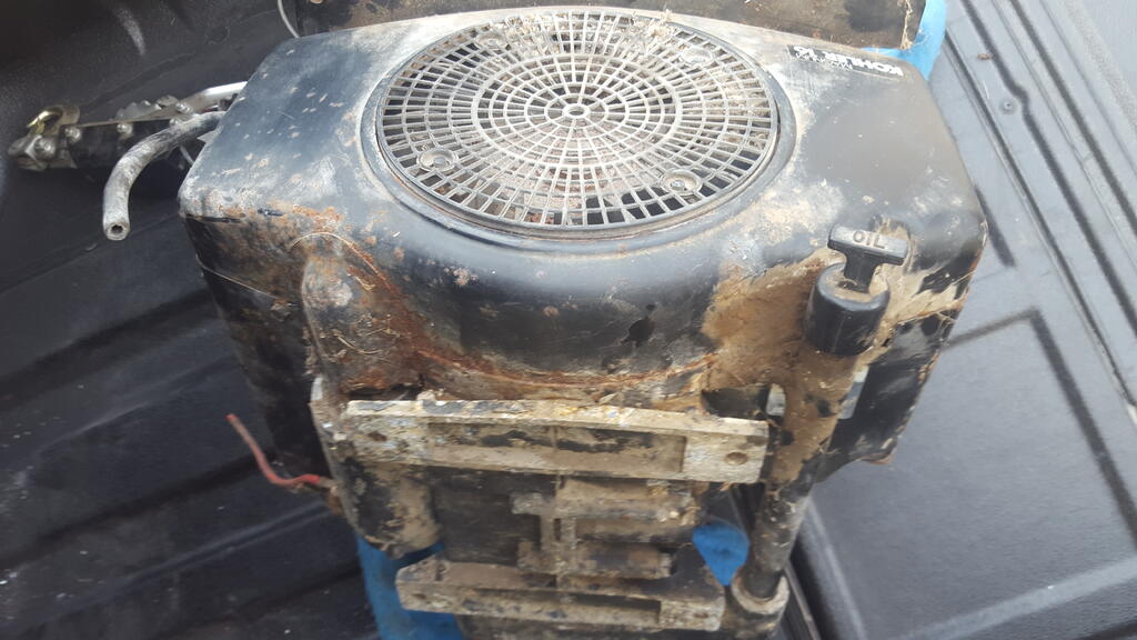

Gregor 4,848 #22 Posted July 24, 2021 So, I went on my Kohler MV16 motor fetching road trip this morning. 3 1/2 hour round trip, but it's not like I have anything else pressing. Came home with this. Model # MV16S Spec. # 5650 Serial # 170210591 (6? I think) Maybe someone can verify that. Model Right now, the only thing I can tell you about this thing is that is is HUGE! Kind-a makes my Briggs Twin look a little puny. I'm not quite sure how I am going to get it off the truck. May have to enlist the help of my son "Bubba" and his friend "Tiny" Gonna have to read up on this thing, and see what it weighs. Not sure what I got into, but it already looks like fun. The guy told me he had 4 more. Different makes and sizes. I told him to send me pics and prices for everything. at $50 a pop, I would buy them all. That should keep me busy for a while. Like I said, 3 1/2 hours round trip, to the east and back. 15 miles from home I get a phone call, from some one who was suppose to call early this morning, when he got off work. He forgot. Get home, grab a bite, fuel up, head east again. 4 hour round trip this time, but worth it I think. Read about it in "Other Brands" section. Once I get it posted, that is. Gimme a bit. 1 Share this post Link to post Share on other sites
gwest_ca-(File Mod) 12,489 #23 Posted July 24, 2021 Kohler made this engine in 1987. The spec number is missing one digit. Looks likely possibly a 6 or 8 at the end 1 Share this post Link to post Share on other sites
gwest_ca-(File Mod) 12,489 #25 Posted July 24, 2021 https://www.partstree.com/models/mv16-56506-kohler-magnum-engine-made-for-cub-cadet-16hp-11-9kw/ 1 Share this post Link to post Share on other sites
