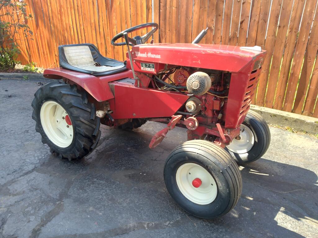

Used 1966 Wheel Horse 856. Includes Kholer K181 8hp engine and 32" deck. Runs and Drives Great!
I received it in non working order, I have since done the following repairs: To Engine/Transmission; New carburetor, fuel pump, fuel line, fuel filter, battery, throttle cable, head bolts, spark plug, regapped points changed oil in engine and transmission and cleaned air filter. To Body; striped and repainted wheels, blades sharpened and primed hood and rear fenders (ready to be painted). This mower is ready to add to a collection or used for every day tasks. Cash on pickup. $950 or best offer. Please feel free to CALL me for details or any question! THANKS for looking! -

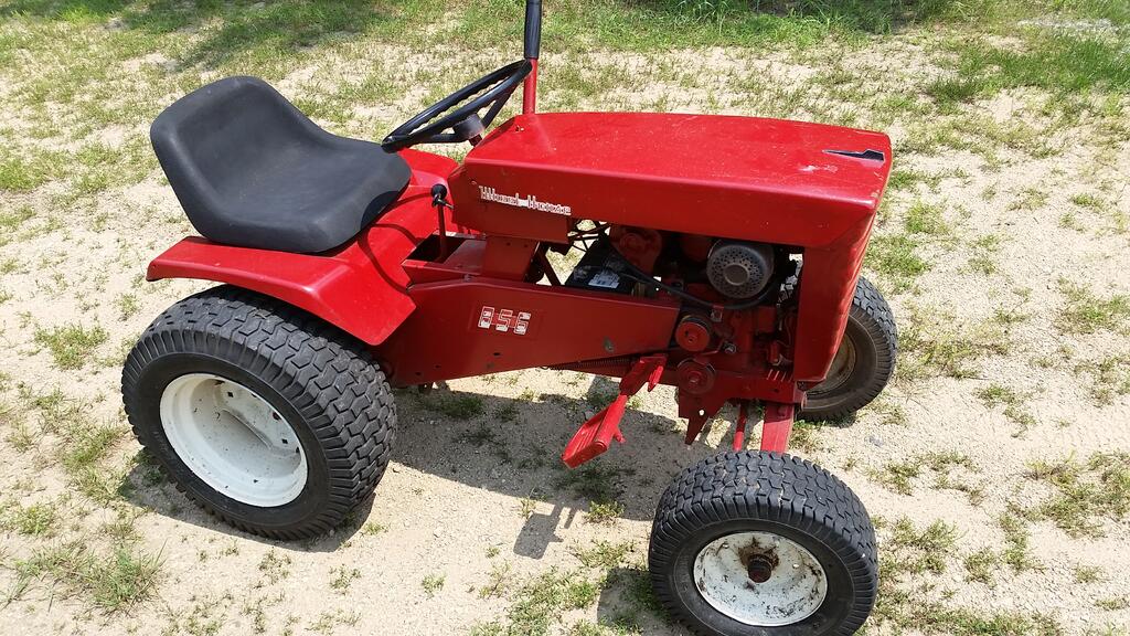

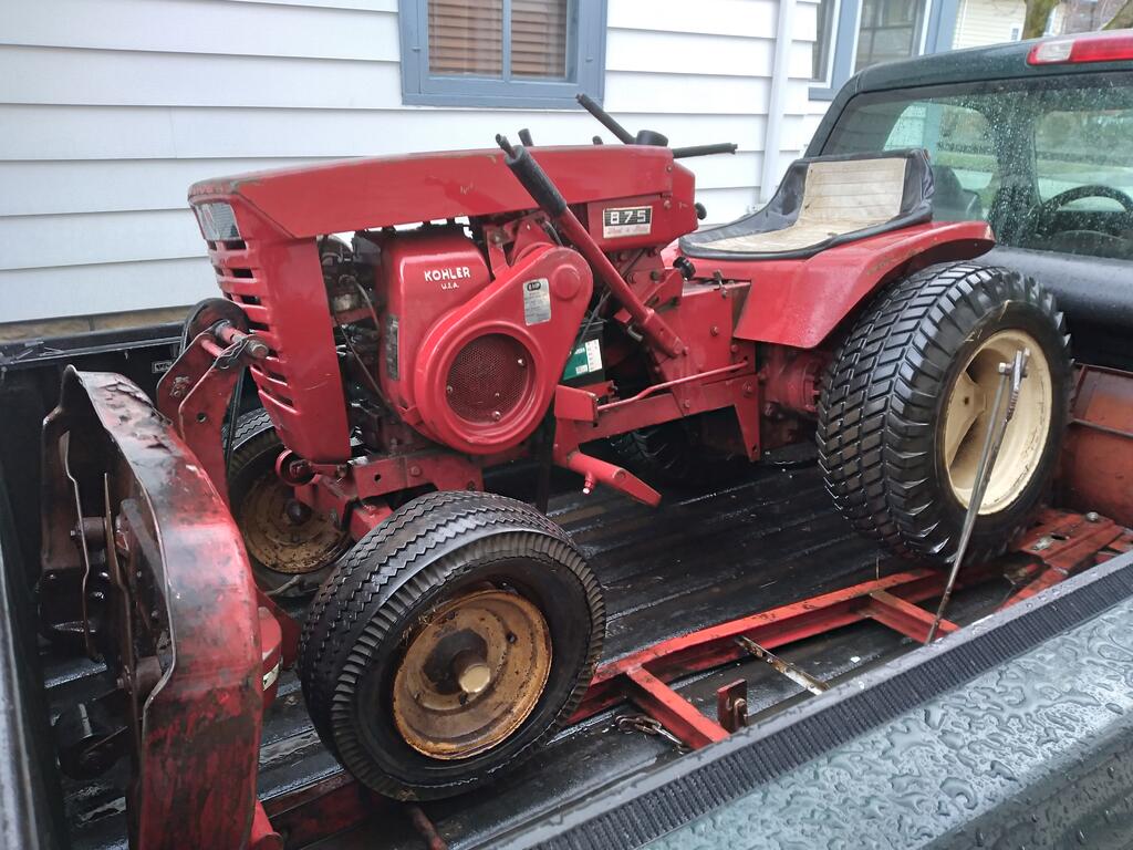

By Retired Wrencher
This was at the big show this summer. This was going to be Sparky tractor but he found a better one. So he knows I am a big fan of these Sart/Gen tractors so I said yes. @Docwheelhorse Delivered it to me. So from then to now I have been working on it bringing it back to a very useable condition. I did not like the vacuum pumps on these older K181 so I tried finding a mechanical one. It failed to many years sitting in box and forgotten about. So with the help of good members here they led me to electric fuel pump. Never had one. I have to say what a deference . It starts like BAMMMM or snap of your finger. I am a fan of these now. Will buy more as time goes by. Hope you enjoy the picks.

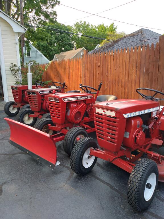

By PineBushJohnny
I am new to anything mechanical and inherited a WH856 in pretty good condition when my Father in law passed. My daughter and I turned to this forum to learn all we can to get it in working condition. well low and behold you guys taught us so much and we cleaned the piston head, changed piston ring, cleaned valves, rewire, changed condensor, breaker point, spark plug, coil, ignition switch, fuel tank, fuel lines, throttle and choke cables and got that baby running. my wife was so happy as it is the only thing she has of his. Now we are in NY we get a major snow fall and I break out the WH856 with plow and am making short work off plowing but then wheels go cockeyed. the right hand ball joint assembly keeps coming off. how can I fix this? where can I get both left and right ones so I can make sure it doesn't happen again. while I am at it how do make sure there is enough lubrication in the transmission?
I am going to post pictures of the 856 soon. It is named after y father in law .... "Dominick da Plumber"

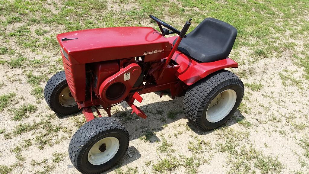

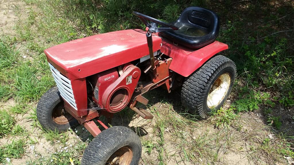

By Texas Todd
I picked up an 856 out in Sweetwater TX a few weeks ago and pushed it on the operating table.
What I knew of it is what you see here. Have no idea if the engine is good or not. Drained the engine oil and it looked pretty good. For all the sand under the blower housing and trash in the toolbox and shifter area, I didn't have much hope for the condition of the trans oil. In looking at the transaxle, I really figured the tran oil would be pancake batter.
It appears the leaking seal is on the brake shaft. The right side looks pretty good. Interesting replacement for the belt guard. We will see if it functional.
The oil in the transmission looked brand new. Not the least bit of water from what I could tell. That was encouraging. I got every drop out that I could.
The key switch looked like it was off a 1969 Impala or something. I replaced with a spare WH key switch and started troubleshooting. It was missing the coil so I took a spare. Also replaced the points and spark plug. The condenser was good.
I was getting spark, but no fuel, It would fire with starting fluid. Removed the carburetor. P-U that varnish stinks. Dunked in Chem-Dip for about 20 minutes and blew it out. I need to find a gas tank for it, but used a small tank I have to see what I could get. She fired and ran fantastic. Messed with the carb adjustments (not my strong suit) but got it running good enough to not worry about the engine.
Next will be the transmission seals....and then I have to decide what I want to do with paint. Restore like the others or sand and clear coat as is. I have some time to think about as the next few weeks will be busy with other things.
If anyone has a tank or belt cover, please let me know. I actually would prefer to put a plastic tank rather than the original metal, but let me know what you might have.
I fiddled with getting the "Art Work" off with goo gone and it cam off for the most part.
How well do these 8 hp engines push a 42" front plow blade? We don't have much in the way of snow, but I could push some dirt around at my land....
Will the standard 42" plow fit on these short frames?

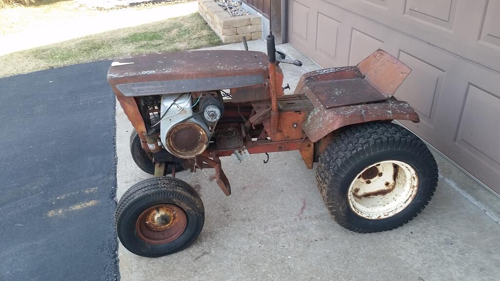

By Flatheadpete
So I got bored Sat afternoon and decided to re-do the hood on grandpa's 856. Started sanding and it was looking good. All those layers of brush strokes helped preserve it. Anyways....on with the pics. Guess I'll have to do the rest now.
